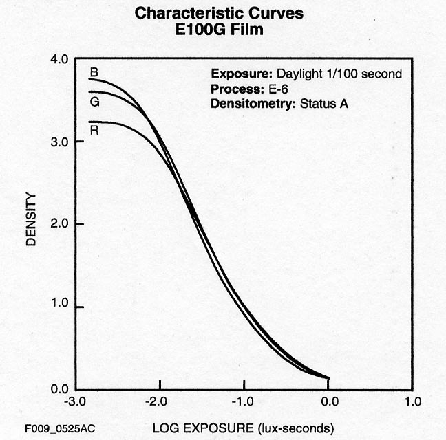

Drew;
The first figure shows the Ektachrome characteristic curve. The second one shows a true internegative film curve. I don't have curves of the interimage of the latter.
When you make an internegative, you place the toe of the Ektachrome on the upsweep of the internegative film. This "adds" the two curves and you end up with a straight line, thus fixing up the highlights in the dupe neg and the print. In addition, the internegative film has a tad of overcorrection in the mask to correct for the deficiencies of the slide.
Just FYI.
PE
