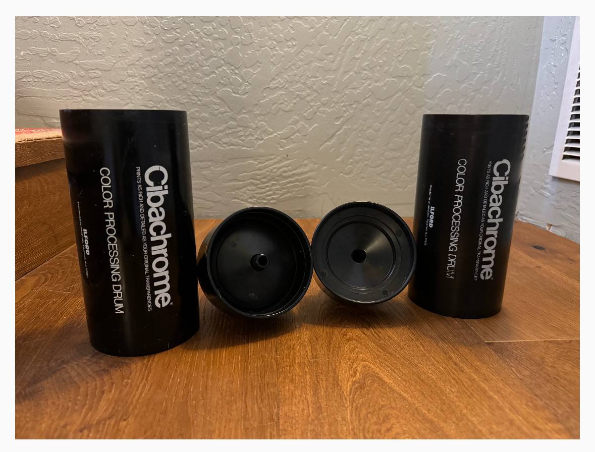

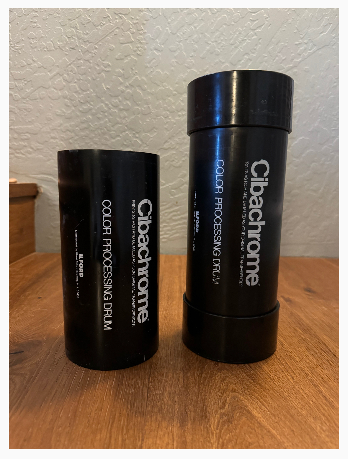

I’m making space in my darkroom and will be listing a number of items for sale.
This is a Cibachrome 8x10 Color Processing drum with top and bottom caps (one for filling and one for pouring out). Also included is an extra 8x10 drum without caps. These are great for B&W RC as well. This can be a good solution if you don’t like tray processing, are working with minimal darkroom space, or just prefer daylight processing tanks.
Asking $55 + $16 shipping (US)
