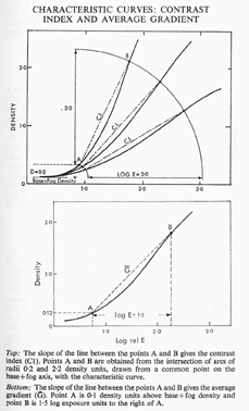

What nonsense. As others have correctly stated, a negative of uniform value, exposed or not, has no contrast by itself, and hence no CI. It has only a particular measurable density. CI, on the other hand is "the slope of a straight line joining TWO points on the characteristic curve that represent the approximate minimum and maximum densities used in practice." This unequivocal definition along with very clear and simple instructions for determining CI are given by C.I. Jacobson, and R.E. Jacobson on page 40 of their book titled "Developing" (18th revised edition, Focal Press, March 1972). CI does, of course, have practical use in relating the contrast of a negative to the scale of the paper upon which it may be printed, and this is perhaps most readily apparent from a study quadrant diagrams. I apologize to those who already understand these fundamental concepts, are not confused by the differences between "density" and "contrast," and who are as annoyed as I am by the enormous amount of energy wasted on this topic in the preceding 24 hours, to say nothing of the impolite tone of some of the responses we have been subjected to.
Actually I do understand.
I do understand and value the concept of contrast index. I thank you for your interest. In actual practice I find average gradient easy to measure while with contrast index, at best, I can only closely approximate it.

I don't follow you. CI is a refinement of gamma, using slightly different measurement points. In all other respects, the concepts are equivalent.
It is also used as shorthand to represent 'degree of development' (in so many words from Kodak) simply because there is no shorthand term for 'degree of development' that is mathematical in nature.
If I am using DK-50 to process my film, and I develop it for 8 minutes, I can look on the CI charts that Kodak supplies to see what what CI that corresponds to (suppose that it's 0.56). I can then go to another developer and look for the same CI value. I can do all of this without even exposing a roll of film. That's the beauty of a CI (or gamma or G-bar) measurement. I can get very similar contrast for my film with the different developer.
See:
CI curves
Now note, just because I'm developing for a given time in a given developer does not mean that I am getting exactly the CI that Kodak shows on the curves. The point is, that any individual variation in my technique (agitation pattern, etc.) will carry over to the other developer as well.

As you have the tools to get the H&D curve, you do not need a special protractor. You need a straight edge with 3 marks on it. Call one 0, the next is at 0.2 log exposure units, and the third is at 2.0 log exposure units. You move the straight edge along the graph, keeping the 0 mark on the B+F level until you find the place where the other two marks fall on the curve. Draw the line and calculate its slope from rise over run. That is the contrast index.
You can fold a piece of the same log-log graph paper you use for the plot and simply make the marks on the folded edge.

I must have stayed up too late last night. You don't use log-log paper to plot the H&D curve, as you are plotting density against log exposure when you use either the step number or the actual density of a step density wedge.
As to flare, there are various opinions. You can get a flare-free curve and make some kind of a theoretical correction when you go to use the data in practice, or you can photograph a reflection wedge with the camera you plan to use and find out how flare affects your CI. A lot depends on whether you are doing it for your own use or are planning to pass the data on to others.
