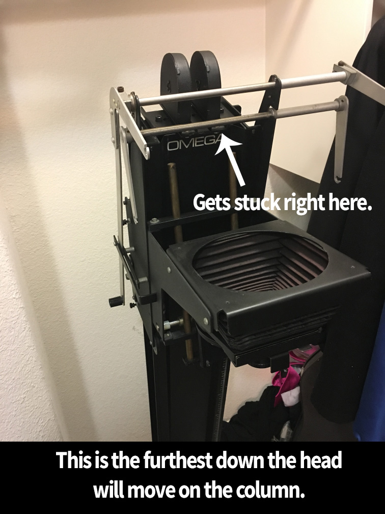

I don't have a manual for it, nor the D5 (which I have another issue with.. my lamphouse levers are hitting hitting a flange at the top of the column, essentially locking my head to a small range of up-down motion at the very top of the column.. a picture would explain best but alas, no pics for me yet!). Jollinger doesn't have either of those.

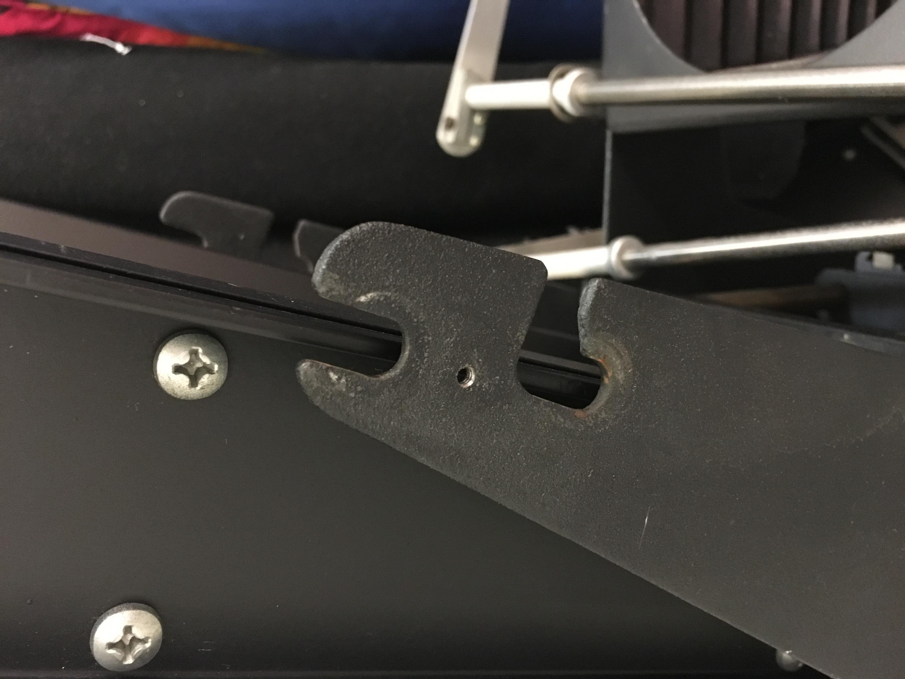

Finally, I can post a picture... this is the second issue I'm having, with the lamphouse levers hitting this counter balance flange preventing it from moving further down. If I take them off and move the head down, I can't put them back on because the column itself blocks the holes.

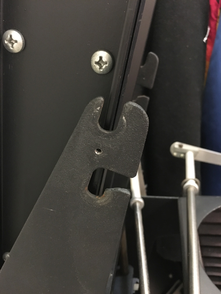

John/Matt: That was my first thought exactly. Unfortunately, when I move the head down, the column itself blocks the slots for the levers:
attachment.php
So I guess I need to find a way to move the whole assembly forward so that there is clearance for these bars? But looking at the enlarger, I can see no way to accomplish this.

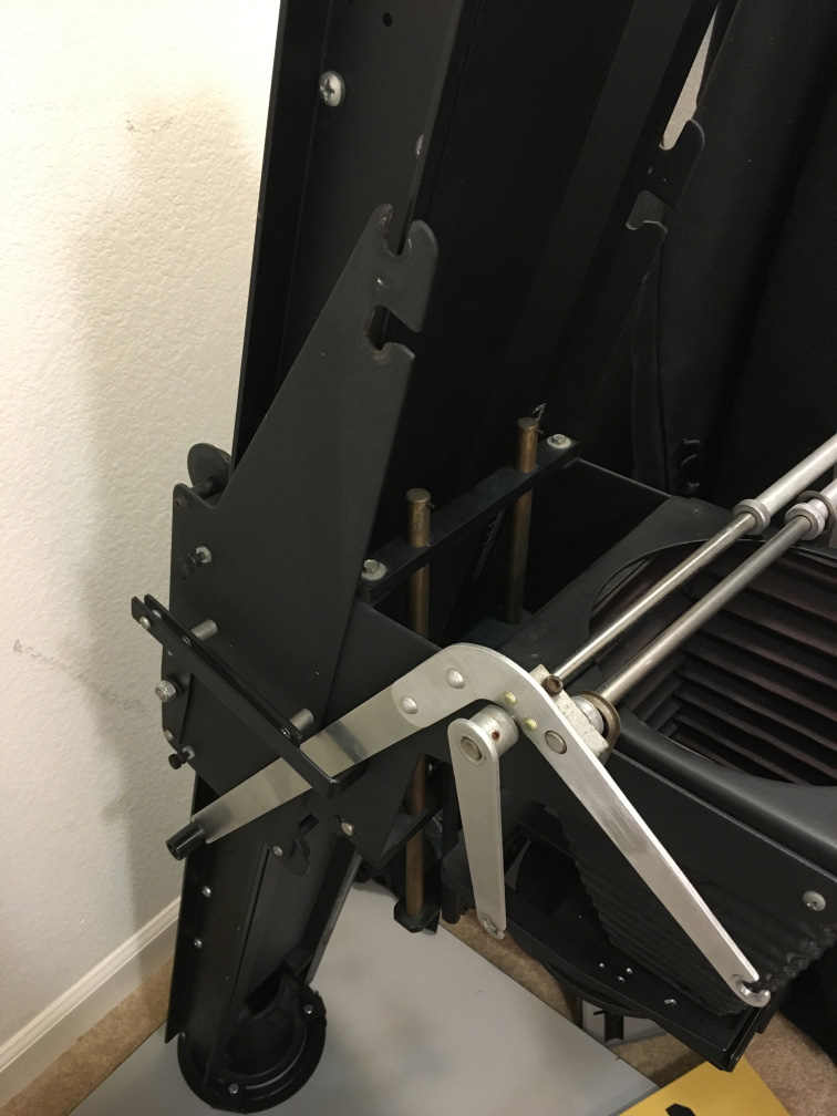

Here is a wider shot showing the carrier and how the column itself blocks the slots after I've moved it down past the flange, and a shot from the back:
attachment.php

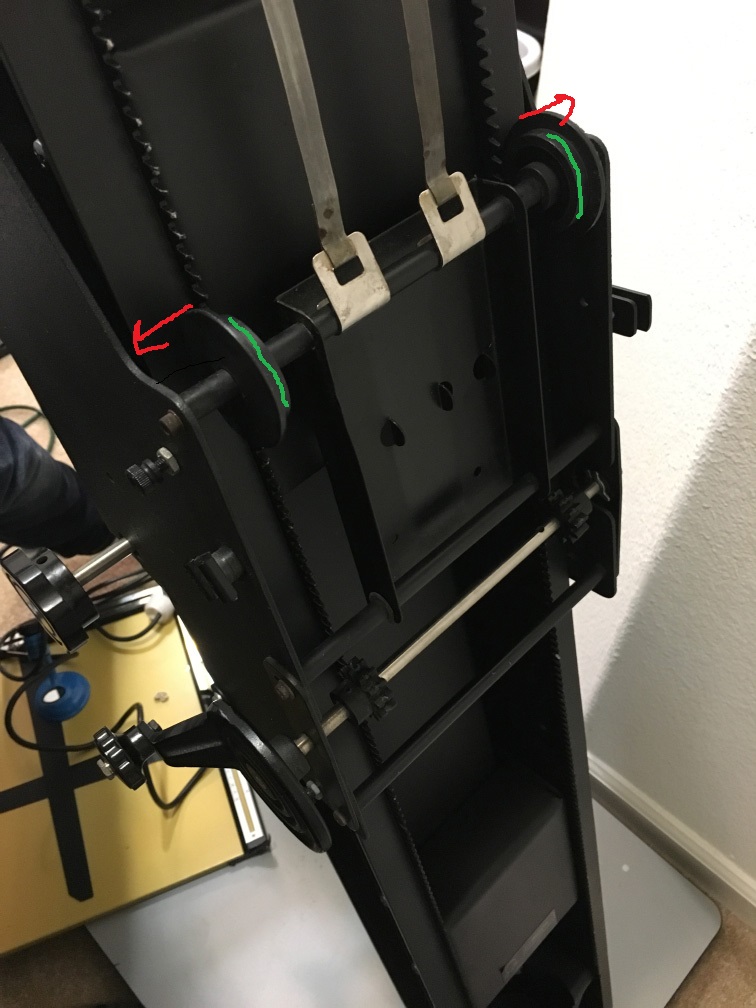

I believe that someone has taken this apart and re-assembled it incorrectly.
I've only a D6 to reference directly, but it seems to me those two larger wheels are intended to ride along the outside edge of the column, with contact being made between that column and the ridge on those wheels, not the outer rim of those wheels.
EDIT: the wheels need to be moved out - see the red arrows below, and the ridge marked in green should be in contact with the column.

I felt it had to be something with those.. like they were too big or something, because if they were smaller the whole assembly could angle forward more. I will try and disassemble that and see what happens. So instead of butting up against the rack, they should be flush against the edge of the column?
MattKing
Apr 24, 2005
55,141
Delta, BC Canada
This is so much harder to do over the internet than it is in person :smile:.
But yes, I think what you are saying is what I think you should do.
I'm concerned though about the geometry though, because if the counterbalance springs being on top is another sign of a "custom" change the angles might be off.
And be cautious of those counterbalance springs - they are quite powerful!

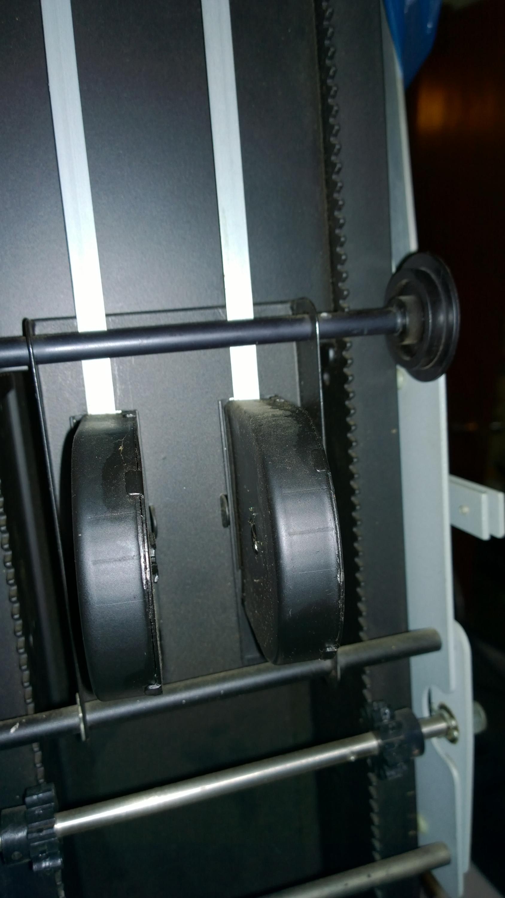

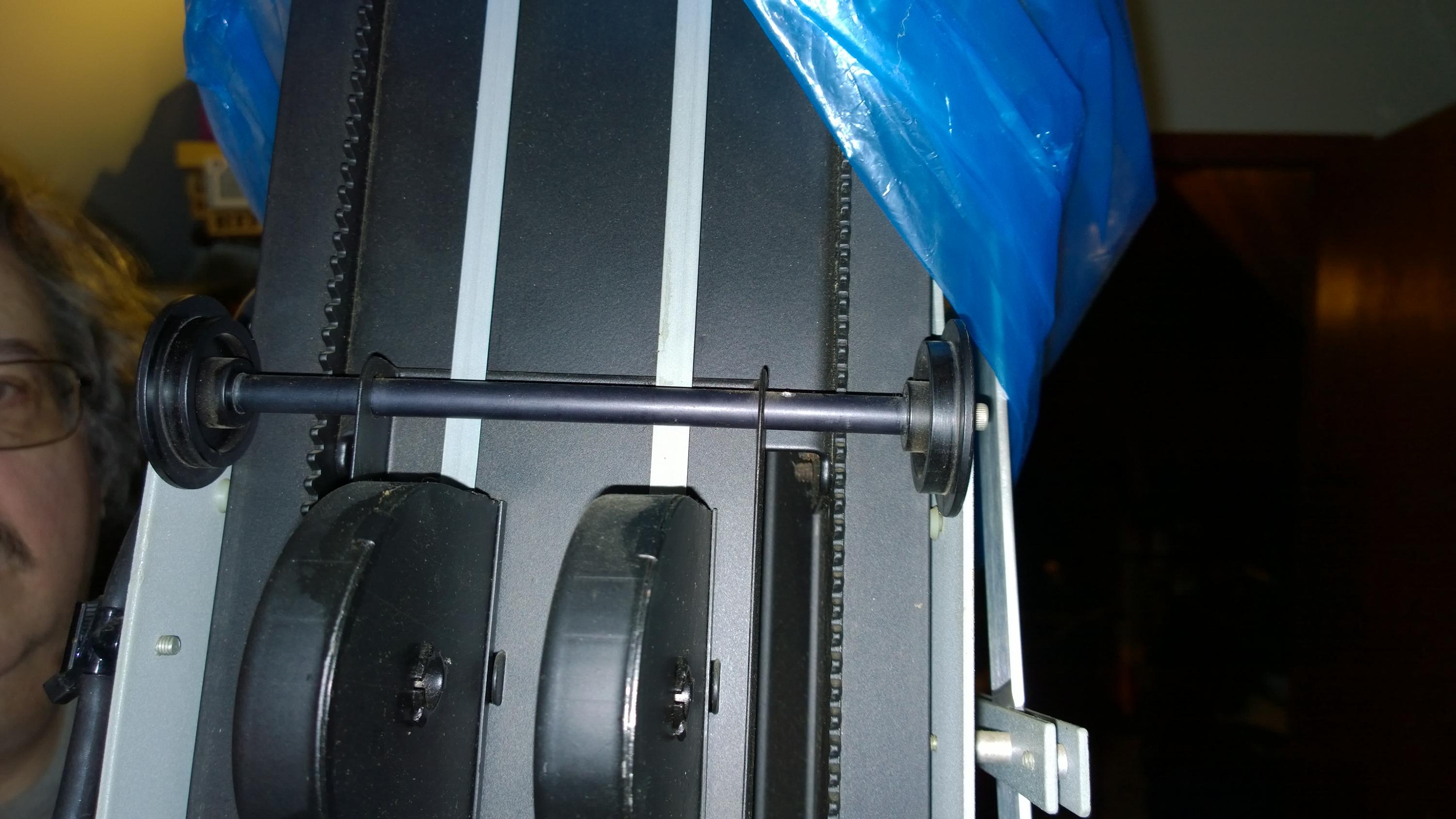

Matt has you on the right track. Here are a couple pictures from the back of one of mine (an older gray paint). I'm not sure what is going on with yours and the counterbalance springs. When I look at your photo the seems to be a "ghost" from where the springs were. Like Matt said be careful with them. Perhaps they broke at one time and had to be replaced with another type ??
attachment.php
attachment.php
