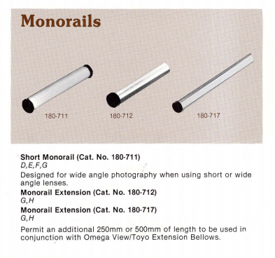

Can't tell if this was mentioned, but it looks like they make a short rail for the D model too (I'm picking up an E so I did some research already)
