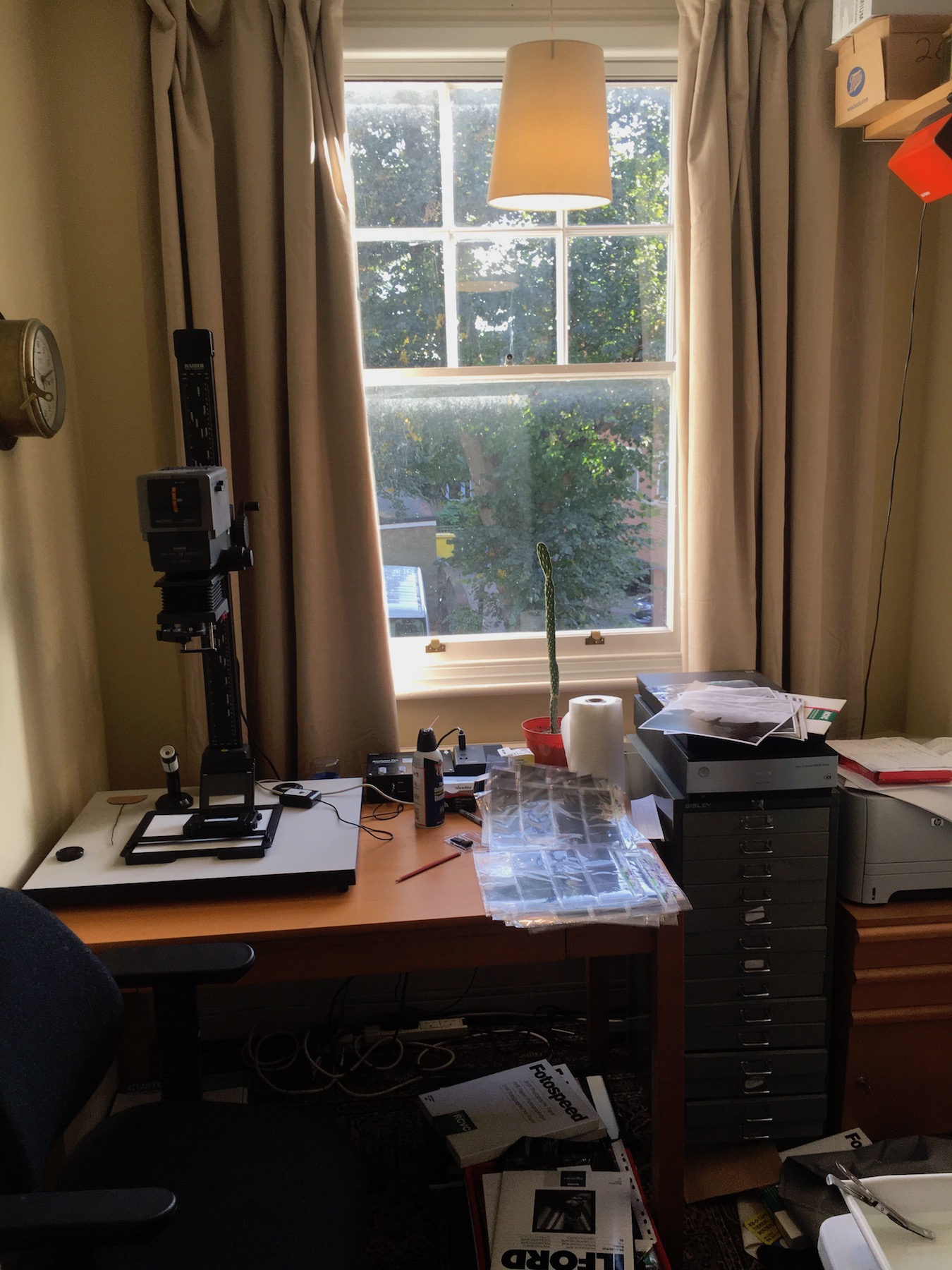

Incidentally, another potential advantage of a Kaiser System V enlarger is that it is very easily taken apart for storage or to move it. The column is detached from the baseboard by turning one large thumbscrew. It takes less than 30 seconds to separate the column from the base. Likewise, the whole enlarger head can be separated from the column by turning another large thumbscrew. In addition, you have full head and lens stage tilt for Sheimpflug, built in bubble levels to ensure alignment, quick change lens collars, interchangeable condensers (for larger formats), interchangeable heads (for colour or dichroic multigrade), interchangeable baseboards and columns and holders for above or below lens filters. Here is my Kaiser System V showing how it fits in a small darkroom.
