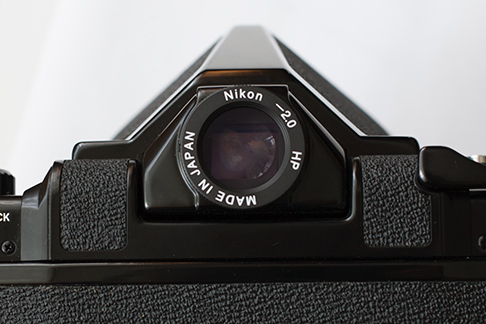

I need a couple of diopters for my P67 penta finders. It occurred to me to simply try to match the dialed in correction on my Nikon digicam, but I am unsure if it's really that simple. Any advice would be greatly appreciated. Thanks.

I use Nikon DK-17C correction eyepiece with ptfe tape, because thread not match.
attachment.php
attachment.php
Excellent!
I would not have thought of that and these are much less expensive and more readily available than the P67 specific diopters.
Thanks.
