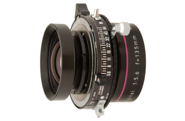

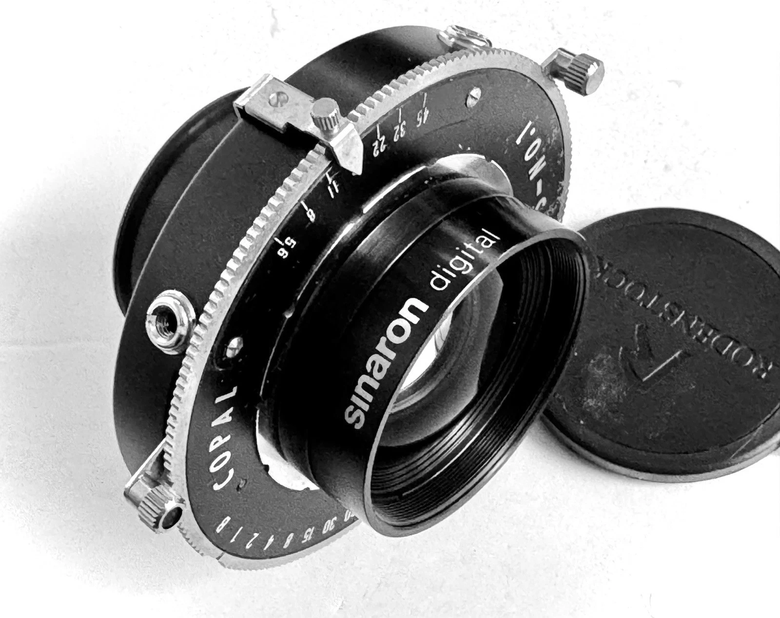

I'm looking for digital telefoto lens to use with my cambo actus with sony ff camera. I already have Pentax 645 fa 120mm macro lens and looking for 135/150mm focal range, so looking for suggestions.
Anyone knows/used this lens i attach in images?
Sinar Rodenstock 135mm f5.6 Sinaron Digital 58° MC Copal 1 ?
As i understand, silver ring is a sign of an old design lens. but it's digital, hence i'm confused.
What is the difference between this one and Sinar Sinaron Digital 135mm f5.6 Lens?
Any other d.f. lens suggestions are welcome, i'm looking in range of 500$, but if it's something good i can spend more.
Thanks

I had always viewed the word 'digital' in lens names as a marketing gimmick.
koraks
Nov 29, 2018
21,857
Europe
AFAIK the term 'digital' on a lens can/may refer to the coatings used esp. on the rear element to reduce flare as a result of light reflecting off of the image sensor and back again via the rear element. It may also refer to design choices intended to minimize problems due to the 3D-nature of imaging sensors which can affect performance of lenses esp. far outside the image center due to angle of incidence - but IDK to what extent this can effectively be dealt with/optimized in optical lens design.
Either way, it's not necessarily a marketing gimmick. How fundamental/big the real-world differences between a non-digital and a 'digital' lens being used on a digital camera is of course debatable.
Just compare the MTF's and lens section of a SK Componon-S 4/80mm with it's Apo-Digitar 4/80mm cousin.
Maybe they added multicoatings...
