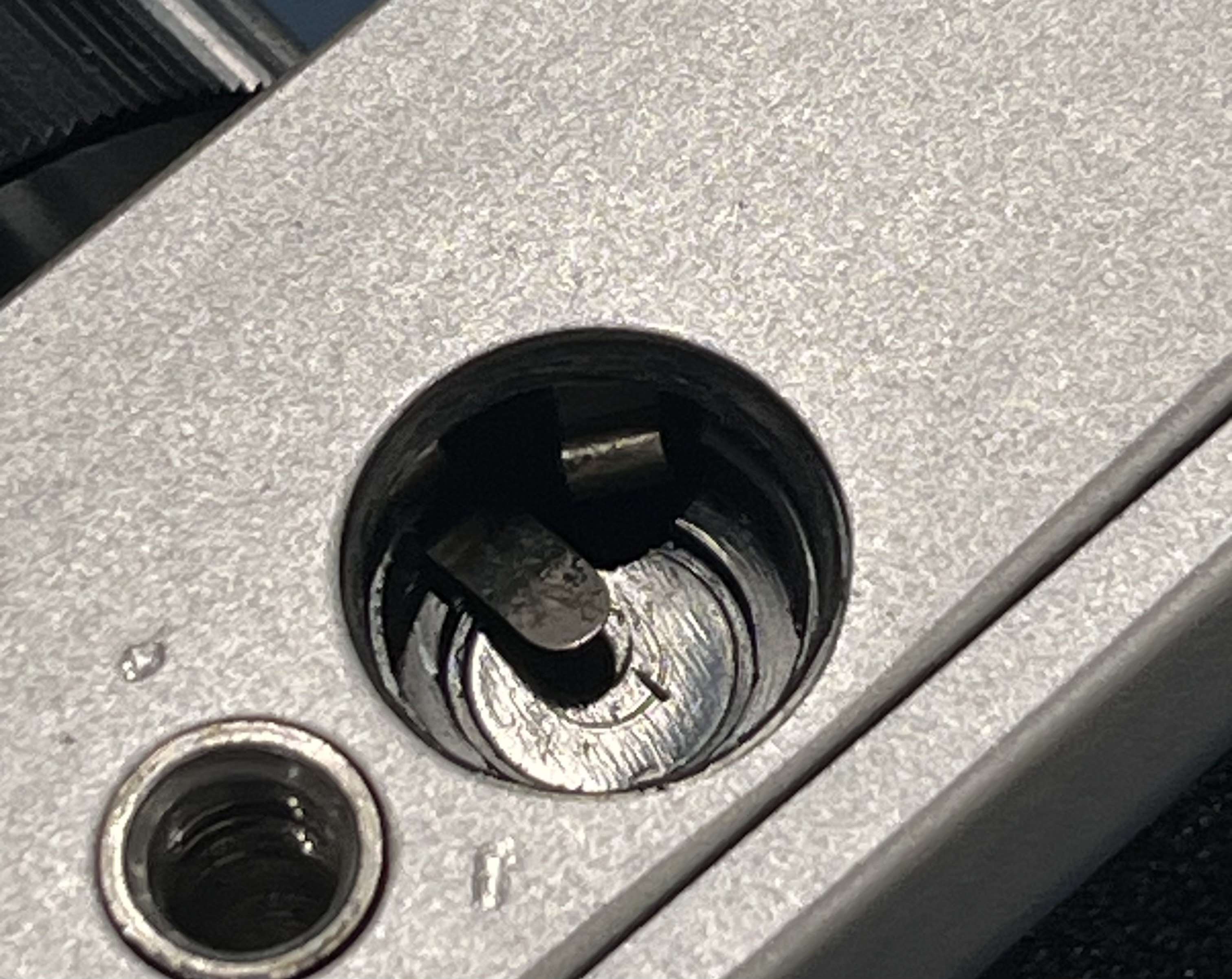

Hello hello,
Recently I've picked up this new hobby by buying a few old 35mm camera's, which has been frustrating in a mostly positive way. It's a fun little puzzle to figure out how to use a camera at all, let alone the technical side of it.
My first addition was a rapid, which was a bummer to find out couldn't really be used anymore easily. Second one a Chinon 35EE followed by an Olympus PEN S (for 7,50!) and now a PORST 135L (which is apparantly a clone of the CHINON.
The Chinon had an issue tho: the lightmeter wouldn't budge. I've taken a few shots and send them off for development, but I couldn't let it rest. The Porst has worked with the hearingaid batteries (although a little wonky). The Chinon doesn't seem to be getting any energy from it however, although I've had moments where I thought I noticed the needle had moved up into the '60' but stayed there. I've cleaned the battery compartment by using alcohol and scratched the metal piece a bit to see if that would help, but I don't think it did anything. The Porst seemed to be way more corroded as well.
I was wondering if anyone had any tips on what to do next to check if the lightmeter is simply broken or that it is a power issue.

Welcome to the FORUM. That battery chamber looks clean to me, but these problems happen all the time, and for various reasons. Some problems are easy to resolve, some not. #1, you have to make sure you have the correct battery (the NUMBERS can get confusing), and you have to know that it's GOOD (some "new" batteries are old & weak or DOA).
#2 Next, you need to clean the chamber -- as you already did. If there was corrosion in the chamber, this could mean that the two wires connecting the chamber are corroded UNDERNEATH the chamber -- but that means removing the base (probably just two screws), and seeing if you can check out the wires underneath for signs of corrosion.
#3 BEFORE you do that, check the TWO contacts in the chamber. There's the tab in the middle that has to stick up enough to make contact. There might also be another contact on the SIDE of the chamber -- it looks like there is from the photo. This has to stick into the chamber slightly to make contact with the SIDE of the battery.
Do you have any electrical testing gear, like a voltmeter??? This can test the battery and the camera metering system.

Thanks for the reply! #1I looked up on several websites. I used the 375 batteries, although an lr43 worked for the Porst too. The only thing I could think off is that it's fitting is slightly different to that of the Chinon and maybe thats why it wont work.
#2 That was my next guess. I'm going to do that next. Should I look for anything specifically or will the corrosion be obvious?
#3 Can I use the voltmeter on the contacts in the chamber as well? Or wont that do anything? (I'm not a great electrician)

I assume you know what battery is correct for the camera -- I certainly don't, but just check it before use. Your camera is probably very similar to my Minolta Hi-Matic G2. The battery chamber has the tab in the middle and another on the side.
If there was no corrosion in the chamber there is probably none underneath the battery chamber either, but the corrosion on wires is just a white/red/blue bunch of dusty crud. Pretty obvious.
Set your meter to OHMs, then place one pin on the center pin and the other on the side pin -- without the battery of course. The meter in the camera should be ON, if it has an ON/OFF switch -- my G2 is always ON. Take two readings -- one with the lens cap on and one with the camera pointed at a bright object. Hold for several seconds. Do you get different readings, or is it simply 0.0?

Alright, I checked under the battery compartment and there was no corrosion either. The camera doesn't have an on/off switch, but I did use a lenscap of another camera to try this out:
- The moment I put it in any light, I get a reading in the battery chamber (somewhere between 0,9 and 1,2 most of the time)
- The moment I put the cap on, I no longer get any results.
I don't quite know the science behind this, but does that mean that the sensor works?

Every meter is different, but the fact that you are getting different readings indicates to me that the circuit is OK. So concentrate on the battery and its contacts. Do you have a camera manual? Maybe there's something that you need to do to get a meter reading -- assuming this camera gives you a meter reading. Many don't.

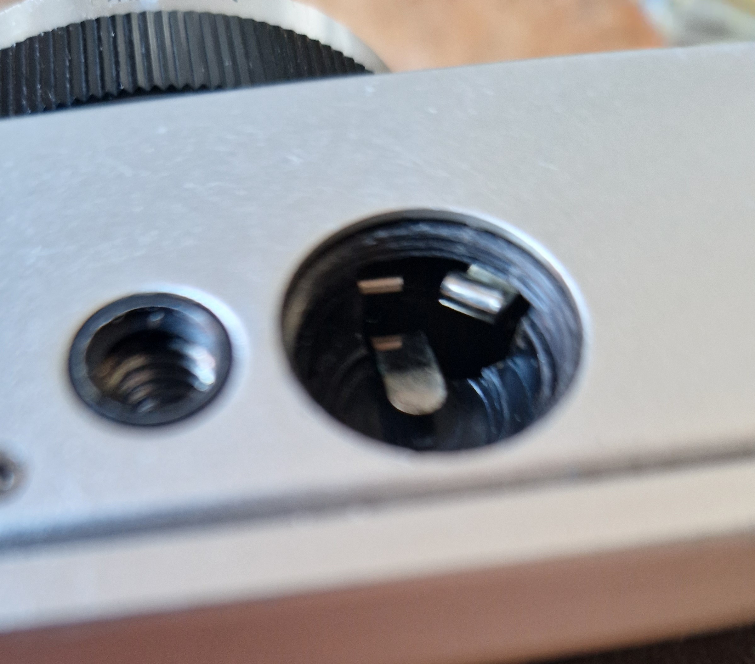

Hi there, I’m finding the same problem but with the 135L. Light meter needle doesn’t move. Camera is great otherwise.
I don’t have a way to test the compartments or the batteries but they seem ok to my eye. Batteries are ll43 and the seller says he actually used them this year with no problems.
The camera works and shoots, but regardless of me shooting towards bright light or with the cap on, it’s always the same shutter speed (as far as I can hear). I believe it is around 1/30, so hopefully some photos may be too bright but with film it shouldn’t affect much.
Do you guys have any recommendations besides opening it? I’m stacking a photo of the battery compartment.

Lots of cameras "revert" to a fixed, set, mechanical shutter speed if the metering system is "dead". For example, if the battery is dead. So if you listen to the shutter when the lens cap is on versus when the camera is pointed at the sun -- and the shutter sound is the same, that means the metering system is not functioning correctly -- assuming that you have set the camera correctly to use the meter in auto-exposure mode (this, for example, might be by setting the lens to "A").
With a "dead" metering system, there are several possible suspects, from a dead battery, dirty/bad connections, corroded wires, stuck needle, etc.

I see. Thanks for the clarification. Indeed, it sounds the same. Since film can handle overexposure well I think photos may turn out fine mostly, even if it gets more light than needed.
I’ll try cleaning the contacts and batteries with alcohol just in case. If anyone has other recommendations, happy to read them.

Most cameras revert to a speed of 1/30, and as long as the camera allows you to manually adjust the f-stop (or GN) on the lens, you can operate pretty well under a lot of conditions. That assumes that the shutter is not electrical, and fires on its own.

That might give a wrong reading, but it should function -- and the needle should respond.
