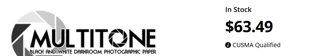

There's a bit of a hint that the paper is not made in China:
"CUSMA Qualified" means it's made in Mexico, USA, or Canada. "One of the rules of origin that is commonly found in all agreements is that goods must be “wholly obtained” or “produced entirely in the territory of one or more of the Parties”." -- from here.
It is made by a company called Inkpress. They also make halftone film.
Hmmm... reinforces my suspicion that it's an older Kodak paper. Maybe someone got hold of the last batch of Kodak Master Rolls from their paper plant?
I would much rather it be a secret, clandestine paper manufacturer, leaping in the void to produce a less expensive paper for the masses, but I stopped reading comic books many decades ago...
I think it more likely that it is from an old roll of paper made by Inkpress.
Kodak RC paper would be at least 18 years old now.
I remember seeing Multi-tone paper in a US store around ten years ago or so, and wondering about it.

I think it's lucky
It can't be. It was manufactured in North America.
Polycontrast III, if stored decently, still prints pretty much perfectly. So, it could be Kodak paper but who knows what capabilities that Inkpress company had - it's impossible to find out anything about them.
