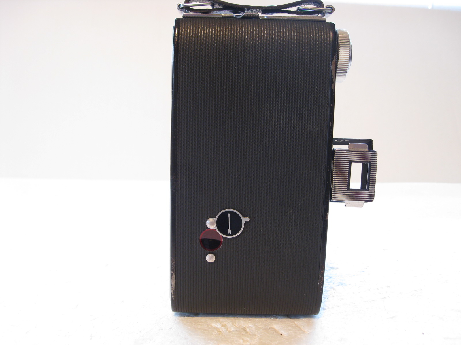

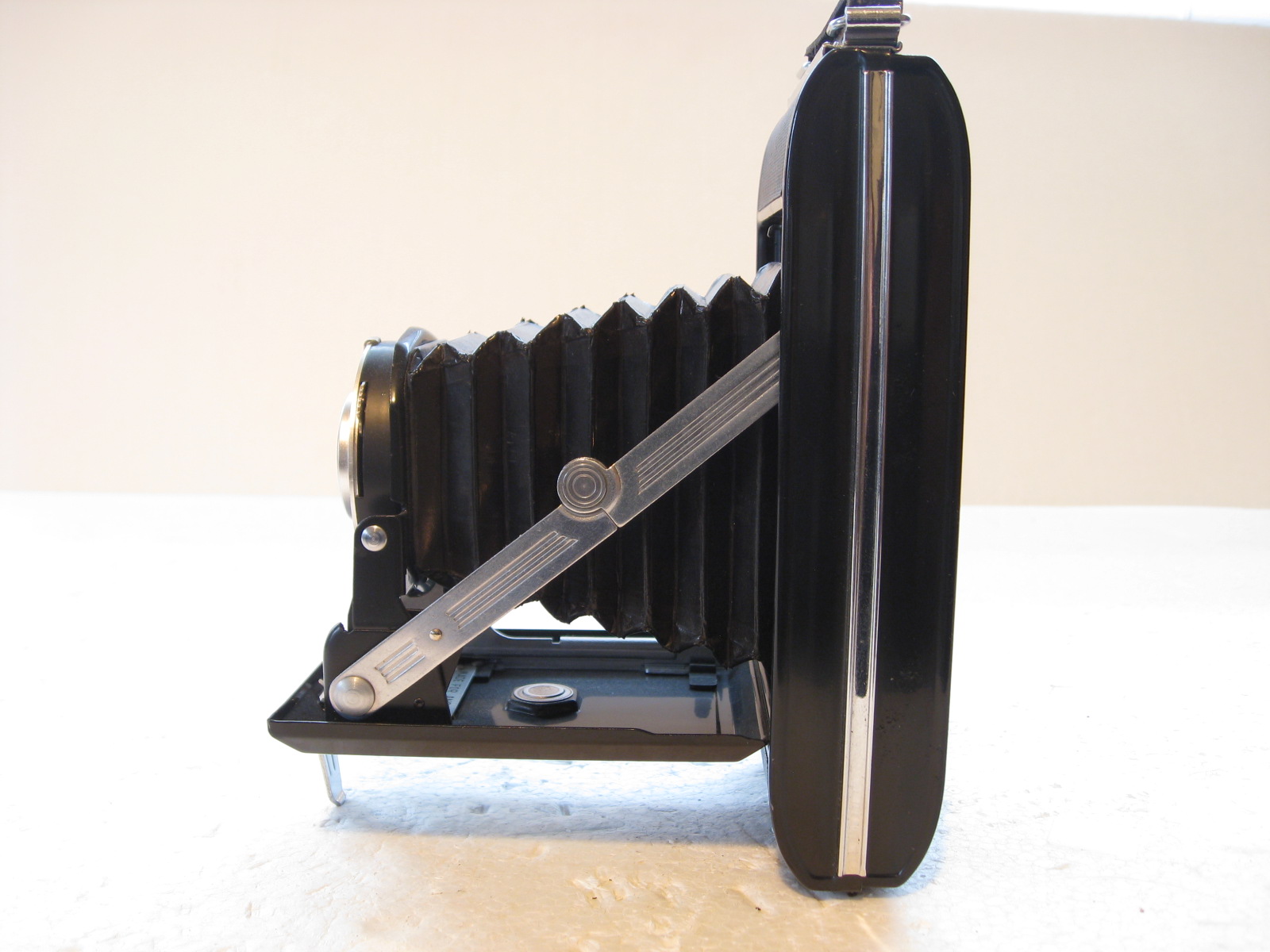

I'm not sure there is an idiot proof anything. If there is, y'all are going to have to fight me for who gets first in line.
Having tried more than a few developers, I will tell you that D76 is about as close to one as you can get, if partnered w/ Tri-X. I've forgotten to do a lot of my inversions, accidentally mixed it up full strength and developed it w/ the times and temps for the 1:1 version, gotten my temps all wrong (once you drop those fancy, smancy dial thermometers, you can throw them away I learned) and no matter what I did, the damn negs looked great. Especially the time I developed it full strength w/ diluted protocol. It gave my Rolleicord shots a very nice "bite" w/ gorgeous grain. It looked like the Tri-X of olden times if you ask me.
Thanks for posting this. It's time to clear the wife and cat out of the kitchen, and get in there and make some more "mistakes". Like the the Rolleicord shots below that were made w/ full strength D76 and the 1:1 times and temps.
For my off-topic comment le jour, I've never understood all the hoopla over Planar lenses. Buy yourself a cheap Rolleicord w/ a clean Triotar, get it set up right, and it will absolutely blow a Planar out of the water, unless you're peeking into the far, far corners. Great lenses.
