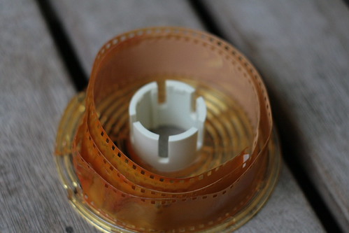

I hope people don't copy some of the things I do!
Bromine Gas Bleaching #2 by athiril, on Flickr
flickr supports your stance and threw a safe browsing warning when I wanted to see your pic :tongue:
Actually flickr reviewed my account as safe, then marked it as restricted the next day, I complained and referred them to the previous review, they took it back, but then did it again the next day. Now they've ignored all my inquiries so far.
