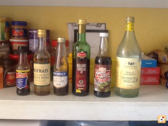

Some bottles:
From left to right:
150ml, 350ml, 260ml, 500ml, 14.3oz, I litre
What would be your recommendation.
Cheers
Raffay
I wouldn't re-use a vinegar bottle for developer.
And I would be concerned about re-using a vinegar bottle for fixer.
All look good, make sure you clean them very very well.
I would use 2 x 1 litre bottles and the rest in 500ml bottles.
Once you use the 500ml bottles first, split the 1l between the 500ml bottles again.
