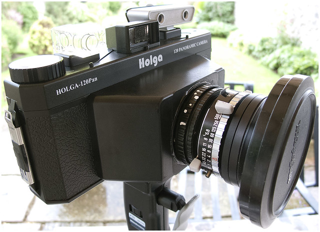

I bought everything from eBay to build my HolgAgon and it cost £167.
Here's how I built it: http://freepdfhosting.com/b316cbe2ff.pdf using simple hand tools.
Here are some images from various folks using HolgAgons: https://www.flickr.com/search/?text=HolgAgon
Lightweight, great quality, simple to make and simple to use.

The 6x12 Holga makes a great donor body for this sort of thing. I'm sure it could be converted into a 6x12 back for a 5x4 camera too.
I was going to do exactly that myself before I decided to build the whole of my 6x12 camera.
