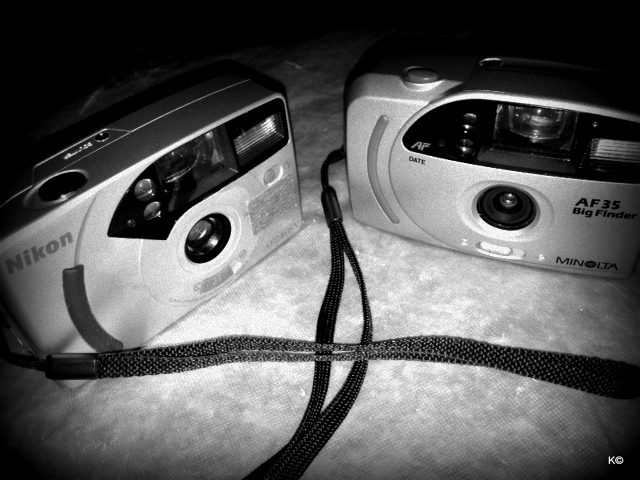

And If you want it at most reasonable price with fine performance, get $5 P&S with 24, 25mm lens. I had two with AF.
attachment.php
This is the scan of the print from one of them.
Antony, his art and art. by Kostya Fedot, on Flickr
Shooting wide isn't as relaxed as it seems. Actually with 24-25mm it is harder comparing to tele.

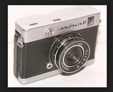

You could pick up a 24mm lens on a cheap Russian camera called the Chaika II -- it uses a Pentax screw mount, no idea what the film-to-lens distance it is designed for is, and it might not even cover a full-frame, but maybe it could be adapted, I dunno, or just use the Russki camera:

No, it was 18 by 24mm. You know, like you get with a "half-frame" camera like your Olympus Pen. A 12 by 36 would be a panoramic look.
A good cheap 24mm lens that does not vignette is going to be very hard to find because a wide angle lens, even the best Leica lens, will naturally vignette because of the physics of the design. The Canon 25mm lens you mention is a really sweet lens, but does vignette.
attachment.php
It isn't 24 and it is half-frame.
Mustafa Umut Sarac
Oct 29, 2006
4,862
İstanbul
I learned Chaika lens on 24x36 , vignettes like crazy. Its for half frame as others reported.
