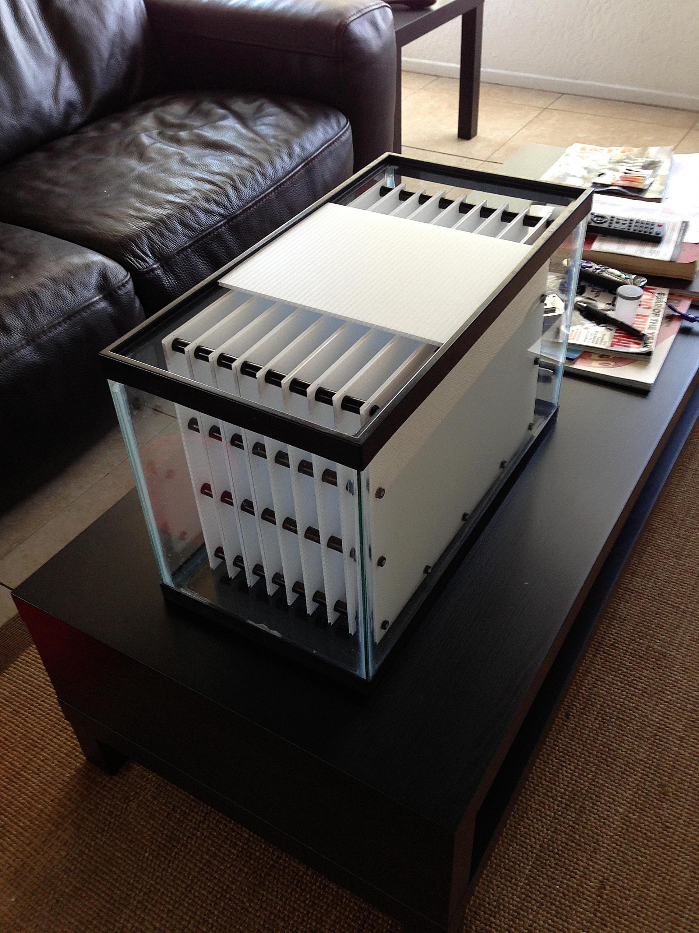

I've been wrestling with buying or making a print washer for some time, now that I'm printing more fiber based prints. I decided to make a 11x14 print washer out of what I could find in the local hardware stores. It ended up costing about $70 and works quite nicely. I used a 10gal fish tank, nylon threaded rod and hardware, and plastic corrugated sheets, (like plastic cardboard). The set up is quite sturdy. I set something on top, like a Pyrex plate, to hold the prints down. I stick my flexible shower head down on one side and let it spill out the top. See attached pic.

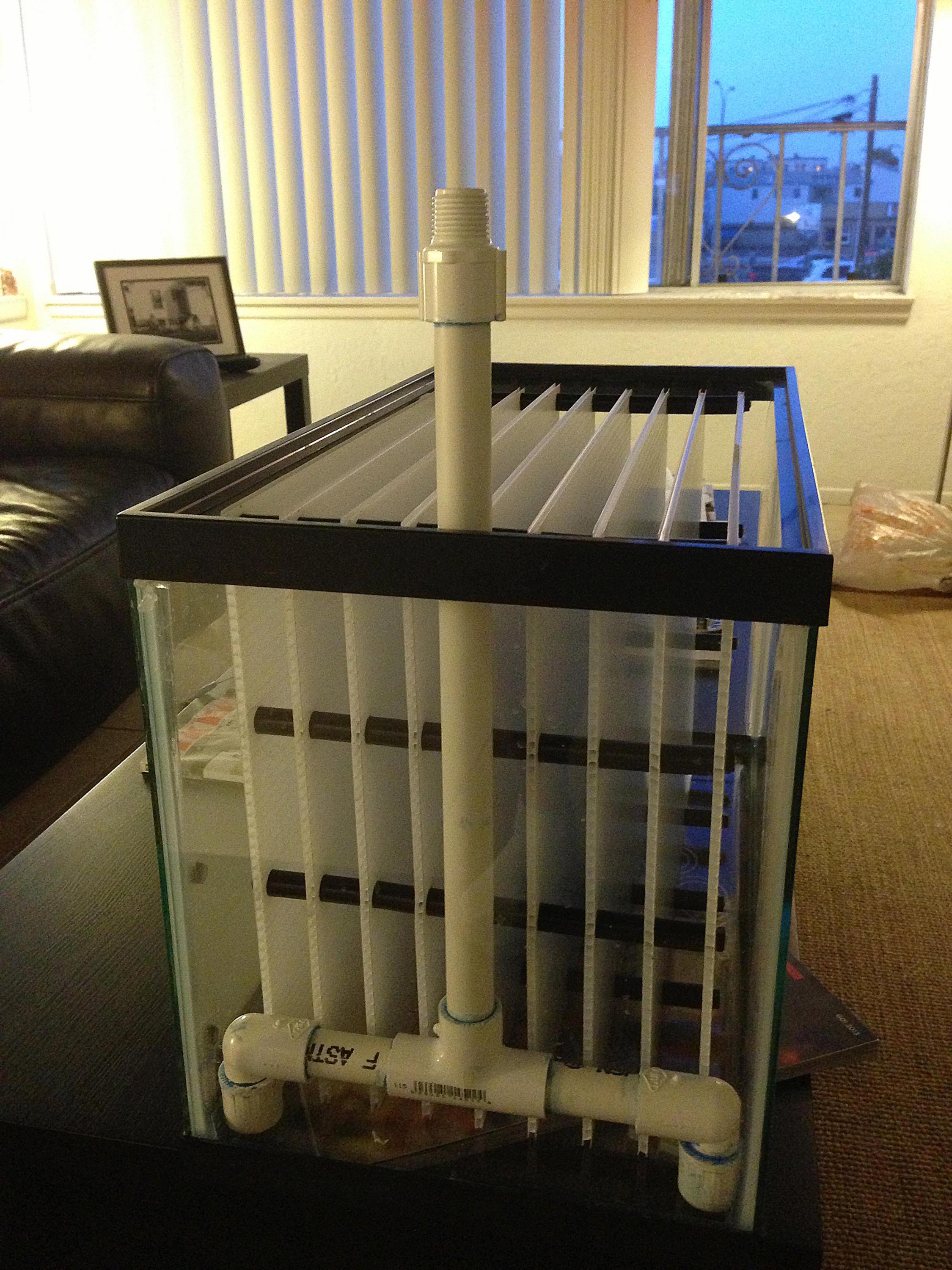

Great article David. I see that I was a bit naive in it's design and can think of several ways to improve it. I think I'll make a PVC pipe bar across the bottom to inject streams into each print cell. this could be removed and swapped to the other side periodically during wash to achieve some sort of reverse flow. Using corrugated plastic cardboard might not of been the best idea. The inside cells of the board can trap retaining contaminants and would be very hard to clean along with the surface of the cells being smooth. It would be better to replace them with some textured surface plastic or acrylic sheets. Back to the drawing board..

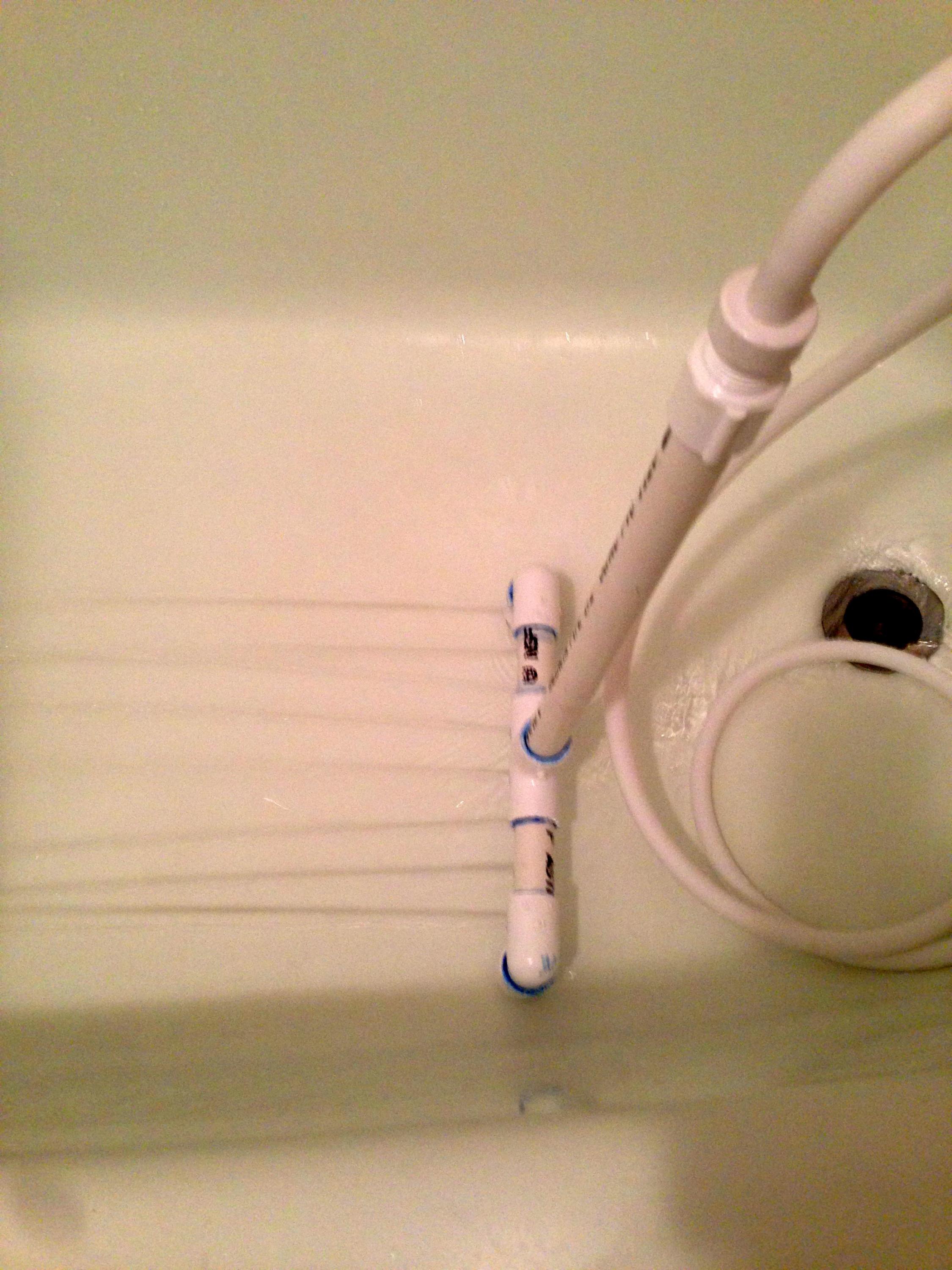

Ok, made the first improvement today. I bought a few dollars worth of PVC pipe and made a T spray jet nosle to insert down one side of the tank so that each print chamber will get a directed stream of water. You can switch it to the other side half way through the wash for reverse flow. This mod only cols $15 with the tub hose and faucet coupling cone included. See pics

Have you tried putting a few drops of dye onto a print and using it to check the flow patterns?

I have not checked the flow pattern yet but would be interesting to do so. For water conservation, you might consider the method that they mentioned in the article where you use a higher concentration fixer for a shorter time. It was interesting how little the print absorbed when fixed for 1 minute.

Go for it Dennis. I wouldn't use the corrugated plastic cardboard like I did however. The cells in between surfaces trap air that makes the thing try to float up. You have to shake it once submerged to dislodge the air. Still, you need to hold it down in some way. Ideally a smooth textured acrylic would be best, something like this http://www.tapplastics.com/product/plastics/cut_to_size_plastic/acrylic_sheets_textured_lucerne/549 . It's not the cheapest materials but the article that was mentioned in this thread in an earlier post indicated that washing efficiency was increased by using chambers with textured sides. Good luck and have fun!
