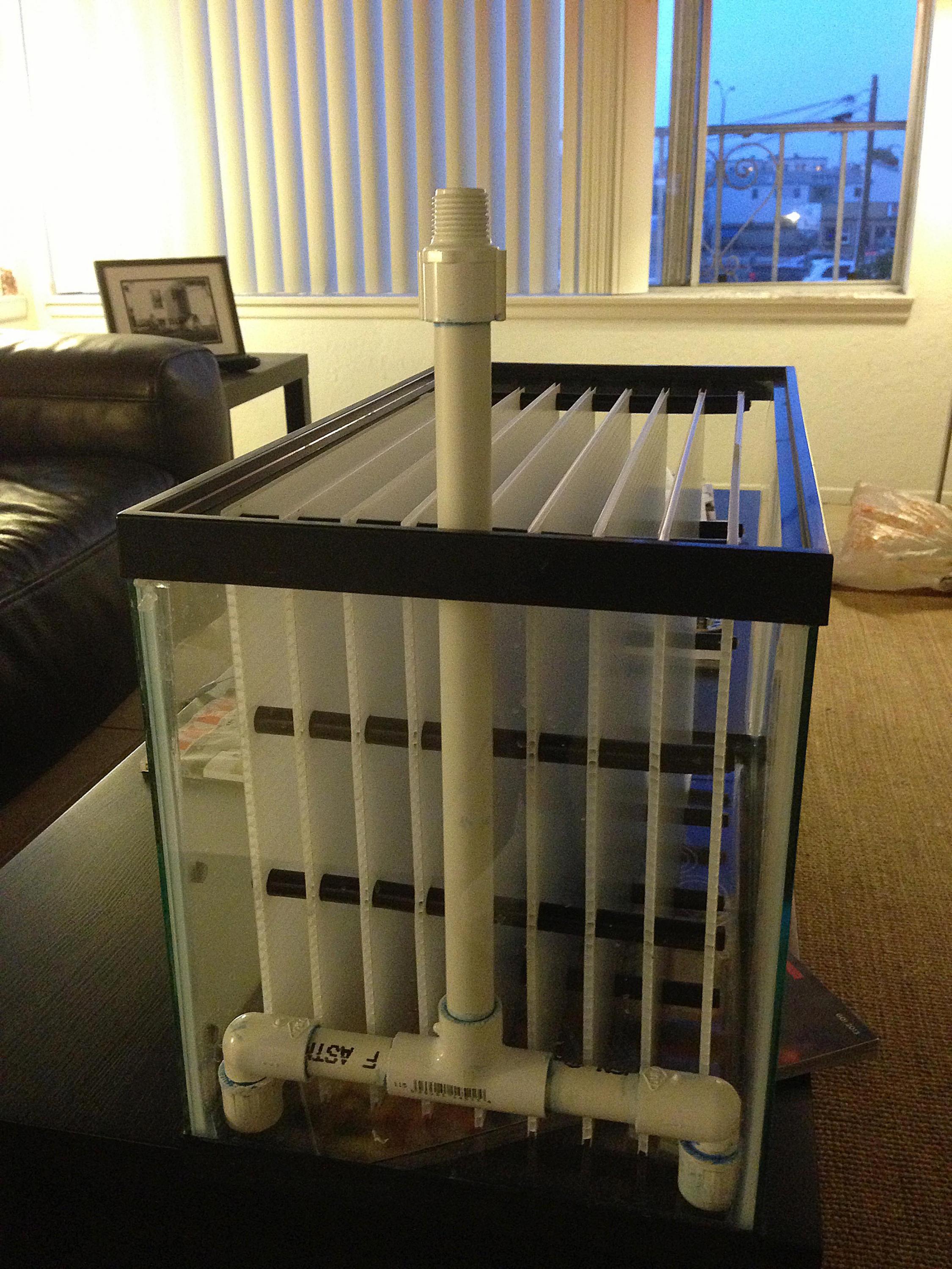

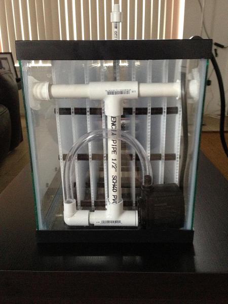

I did just that Ed. I placed the pump at the bottom and have it pumped through a spray bar that shoots it back across the top of the prints to the other side. When I get home from this business trip, I'll pics of the final version. I bought the pump at pet smart for about $15.
Randy, I think that you made a great washer. Could you post a few more pictures of the final product and list what pump you used? Thanks!
Finally got around to taking a photo of the back side. The first photo is of the input side. Water is streamed through each compartment across the bottom portion of the prints. The second photo shows the opposite side. Th black pump on the right pumps water from the bottom into the "T" assembly which sprays water across the top part of the prints back towards the input side. The unit sits in the tub and slowly spills water out of the top on the input side.
