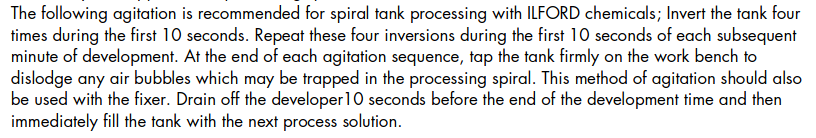

You are in the UK, so it's likely you're using Ilford B&W chemicals. Here is Ilford's recommendation for agitation:

Ilford's recommended scheme works great, Kodak had slightly different, invert every 30 seconds for 5 seconds .

For B&W I would recommend keeping your existing agitation regime when replacing twizzle stick agitation with inversions. This should give you roughly the same contrast. Invert slowly and rotate the tank about 90 degrees after each inversion.
