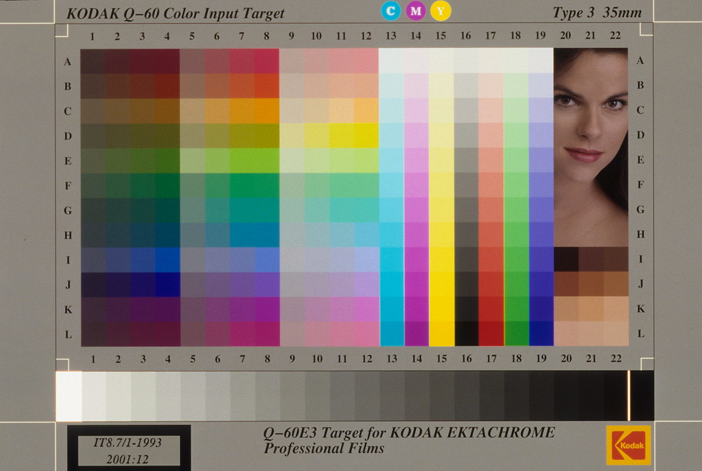

Well, that's really the key to learning the truth about any film new to you. I always first "waste" a roll of 120 film doing those same kind of bracketing tests myself. Then I do an "ideal" frame or two with even a color temp meter in hand, and light balancing cc filters if necessary too. But in all of em I rely on a clean unfaded MacBeth Chart with its excellent neutral gray scale as well as color patches.

Macbeth Charts are so limited but I suppose we photographers know how to work around limitations.
Kodak Ektachrome Q-60E3 Target ICE Normal by Les DMess, on Flickr
Knowing the generous latitude of most color films, I've since been using it in my meterless camera bodies without using an external meter. For daytime shots, I've yet to experience an exposure related failure.

The Kodak charts aren't produced to anywhere near the quality of the McBeth Ones; but that's why they're so expensive. I can't go into detail here, except to say that with a MacBeth (one of my spellings must be right), the middle gray patch IS 18% truly neutral gray. I once ran entire stacks of various gray cards and color charts through an industrial spectrophotometer, and nearly all of the were WAY off, even from the same manufacturer. And it just can't be done with ordinary printing inks.
And I know a really good cure for the shoot-from-the-hip "latitude" method of exposure. Take up 8X10 color photography.
At around $250 per 10-sheet box at the moment, plus processing, and the effort to lug the gear and holders around, you'll go out and buy a serious light meter really fast, and learn how to use it ! Luck and mythology can only get you so far.
