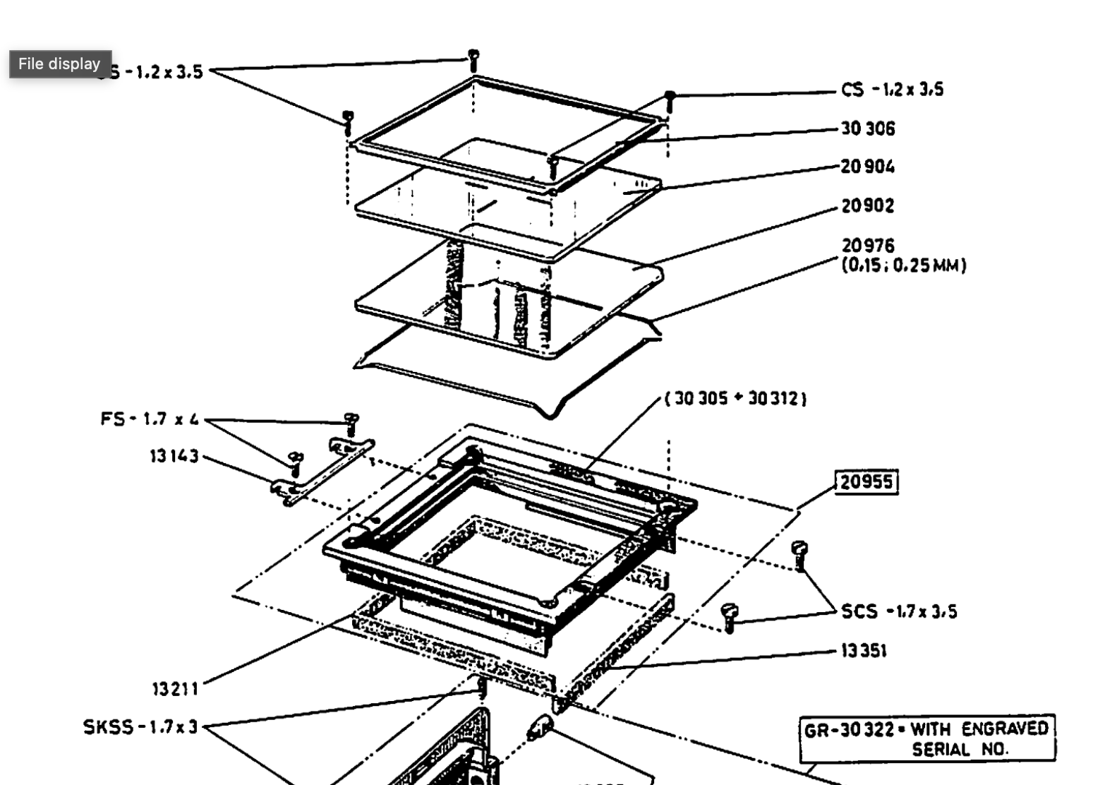

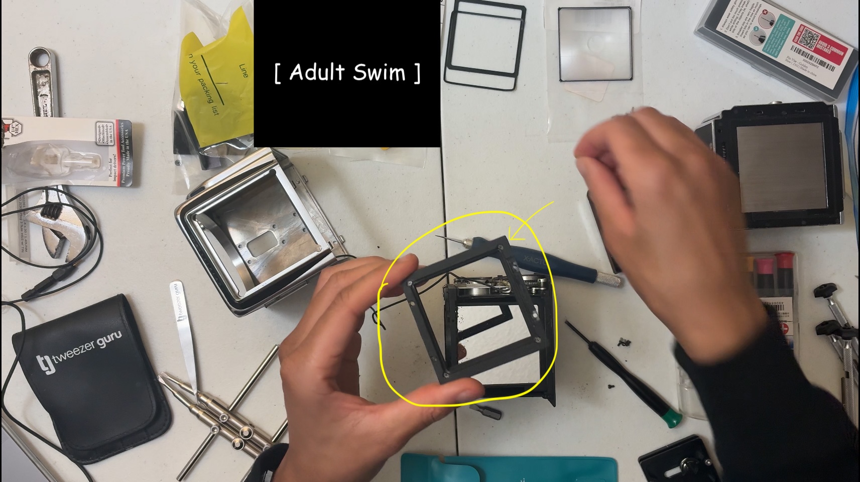

Long story short, the Lord wants me to go further with this repair than I anticipated.
Today, I removed my damaged part 20955. It's the frame that houses the screen for the 500c. I may also need new foam of some kind that sits in the front of the frame.
My guess is it will be difficult to source the part.
Part circled in yellow below:
