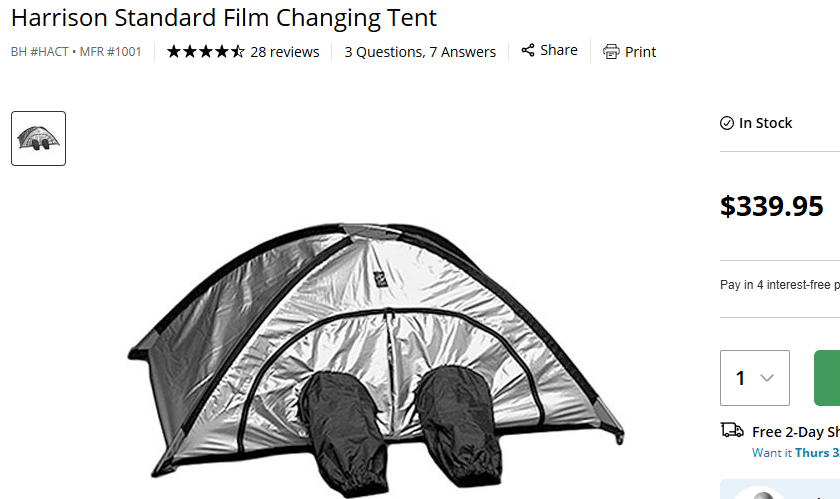

My darkroom had to be repurposed for awhile so no printing for 6 months or so . . . 😢
Caveat: I have never used a changing bag.
There are dozens of bags out there . . . I like the idea of the changing tents like this one but the price is prohibitive. I like it because you are not fighting with the bag itself.

For sheet film, I find it inconvenient and the kind of tent you link to may work better.
You could also DIY a box with a lid and two sleeves sticking out from an appropriate blackout material. Takes a little time & ingenuity to build, but it's not super difficult and the total cost will be a fraction of the tent you referred to.
I got the Harrison Pup film changing tent. A little cheaper than the Standard. Got it when I started doing 4x5. Loading film holders is a breeze — as is putting 35mm and 120 film in Paterson reels and tanks (love it that I can put at least 4 tanks at a time). Really sped up my film processing. The Pup is a little tight when loading the 4x5 films in the Stearman SP-645, but it's a very minor drawback (I just need to tilt it a little).
Folds neatly, so very easy to carry around.
Added bonus: except on very hot summer days, hands don't get as hot and moist as in the changing bags.

I can attest to the Harrison film changing tent (standard size). It was cheaper a few years ago $250. The current price of $340 makes it harder to recommend, but at the previous price point I would say it is a no-brainer if you don't have access to a truly dark room. Very roomy, well constructed, and actually light tight. My previous Patterson changing bag was a challenge when loading film holders AND wasn't actually light tight!!! That detail took me a long time to figure out and left me wondering why some of my film had fogged, even under dim room lighting.
Edit: There are some reviews of the Harrison changing tent stating that the materials start to decompose after many years. I've had mine for 2 or 3 years now and its been fine so far.
