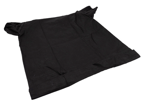

Depends a lot on what you use it for. For roll film, a regular changing bag will work OK:
For sheet film, I find it inconvenient and the kind of tent you link to may work better.
You could also DIY a box with a lid and two sleeves sticking out from an appropriate blackout material. Takes a little time & ingenuity to build, but it's not super difficult and the total cost will be a fraction of the tent you referred to.
