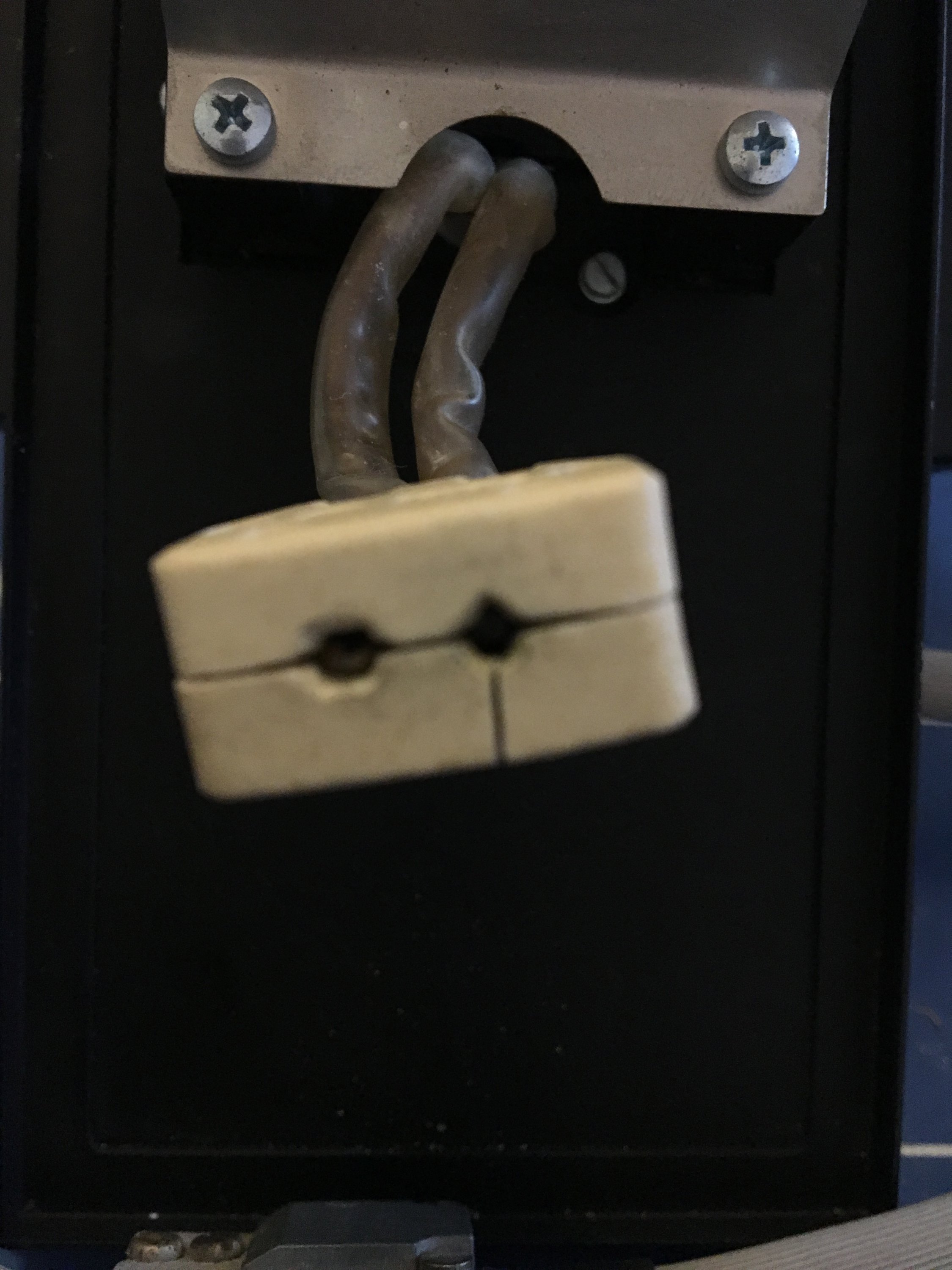

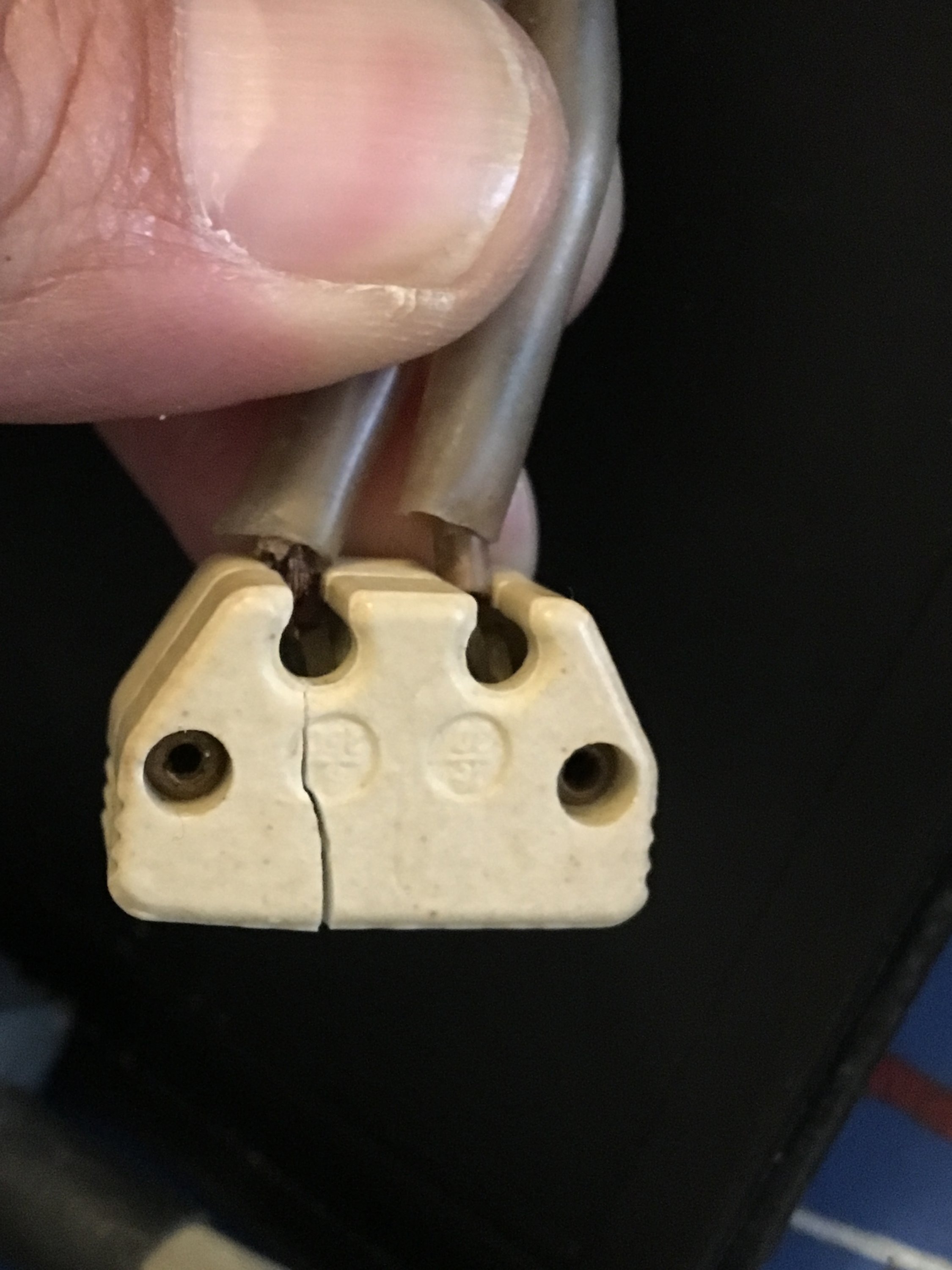

Hello all,
One of the enlargers got a piece of the bulb stuck into the socket. The holder itself also got a nasty crack, my questions
- can I replace the white bulb "holder / socket"? I don't see any screws and I am not familiar with this socket
- any tips how to get the little piece of bulb out of the socket?
ps; I am not the person replacing the bulbs, are there any do an don'ts while replacing the bulb? As I don't want this to happen when I must replace the bulbs / lamps

The socket & lead set shown in the photo should be replaced. The socket and the two insulated leads are permanently assembled in manufacture.
If you have the Durst M601 dichroic color head, it takes the 12-volt 100-Watt 2-pin GZ6.35 base, MR-16 reflector EFP lamp.
Thus, you need a GZ6.35 2-pin ceramic base socket & lead set. Here is an example. The shape of the ceramic block varies among the various makers, but should not be a problem.
https://www.distrelec.biz/en/bulb-socket-g6-35-gx6-35-gz6-35-bender-wirth-881-12301/p/13380037
Many different suppliers can be found via Internet search. Some of these are priced exorbitantly. Others are reasonably priced.
Shop for a reasonable price before ordering. It might be useful to search the Internet for suppliers in your area. Use the search string “GZ6.35 socket” in Google or whatever search engine you prefer. If you have more than one of these machines to maintain, it is a good idea to purchase several replacement sockets for future use when needed.

Mill-out, then grind-out (to save the milling tool) the two rivets, disassemble the socket and remount it with two machine-screws and nuts and wavy locking washers.
HOWEVER your socket is cracked. Exchange it completely.

Furthermore, the fact that the lamp pin got stuck makes the respective connector springs already questionable. This already should make you consider exchanging the socket. At low voltages connector resistance is critical and may lead to voltage decline.

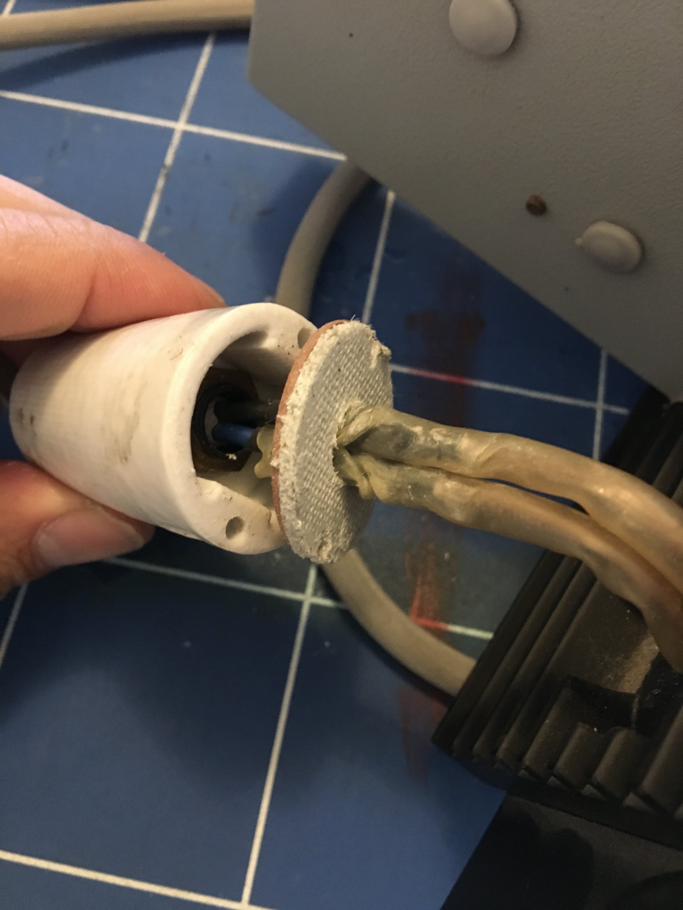

The socket replacement procedure varies from model to model. Some socket leads terminate in loop-type terminals that attach to a screw post. Others have a solder-joint. You have to do some disassembly to see what must be done to replace the socket & lead set on your Durst M601 dichroic head.

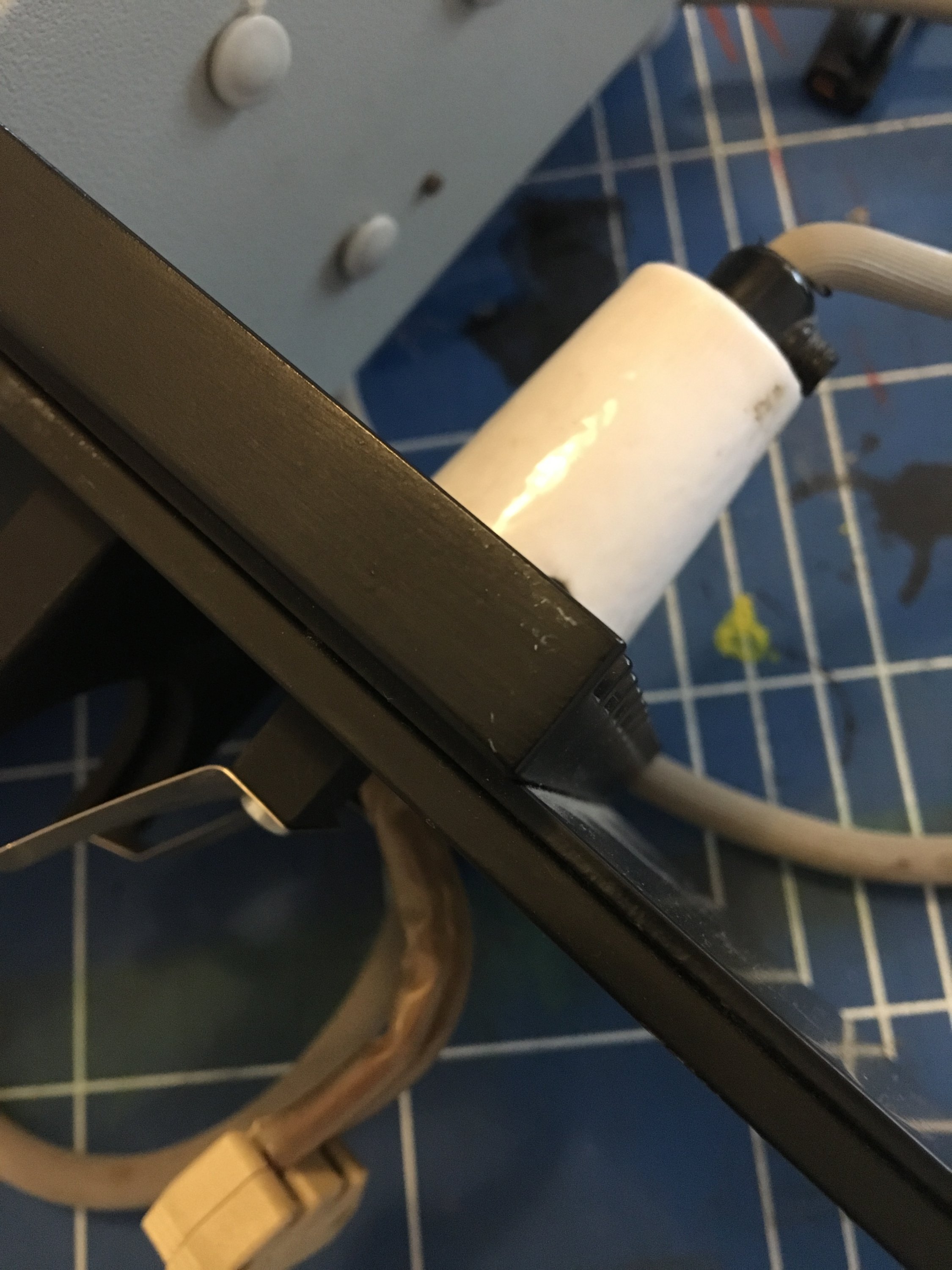

hmm, i am not quit getting your dismantling proposal, drilling will make the socket crack even more. (fortunatly I got another enlarger working ok)
At the moment I have dissamble until the following photo, but i expected some kind of easier "plug + play" when I have found a new socket with the 2 threads. Somehow the 2 threads are not "loose", wondering if I can just replace the socket

It is highly probable that you will not find a new replacement socket. It is possible that you could find another unit to salvage the socket as a replacement.
If it were my problem, I would drill out the rivets, separate the cracked half and clean the inner surfaces, epoxy (clear Gorilla glue or equivalent) and clamp the two pieces tightly together until completely cured. While the two halves are apart, you should be able to remove the broken pin and clean/re-tension the connector receptacles. As mentioned above, reassemble using the appropriate machine screw with nut.
