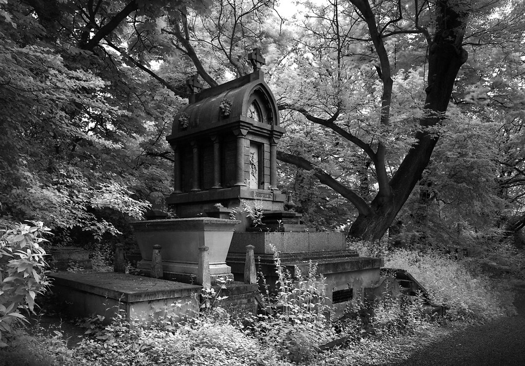

hiya all, have had no problems with my chamonix using rollei IR. here is a recent example:

Monst, again, nice shot. That doesn't look like a situation where direct sunlight was hitting your camera but it does show what's most likely an issue with the bellows of your camera being from a different material than mine. What's your serial number?

hiya wildbill, not exactly sure what my serial no is but it is quite low, will check it out. i did other shots in direct sunshine with exposures of 2-8 secs and they were good too.
