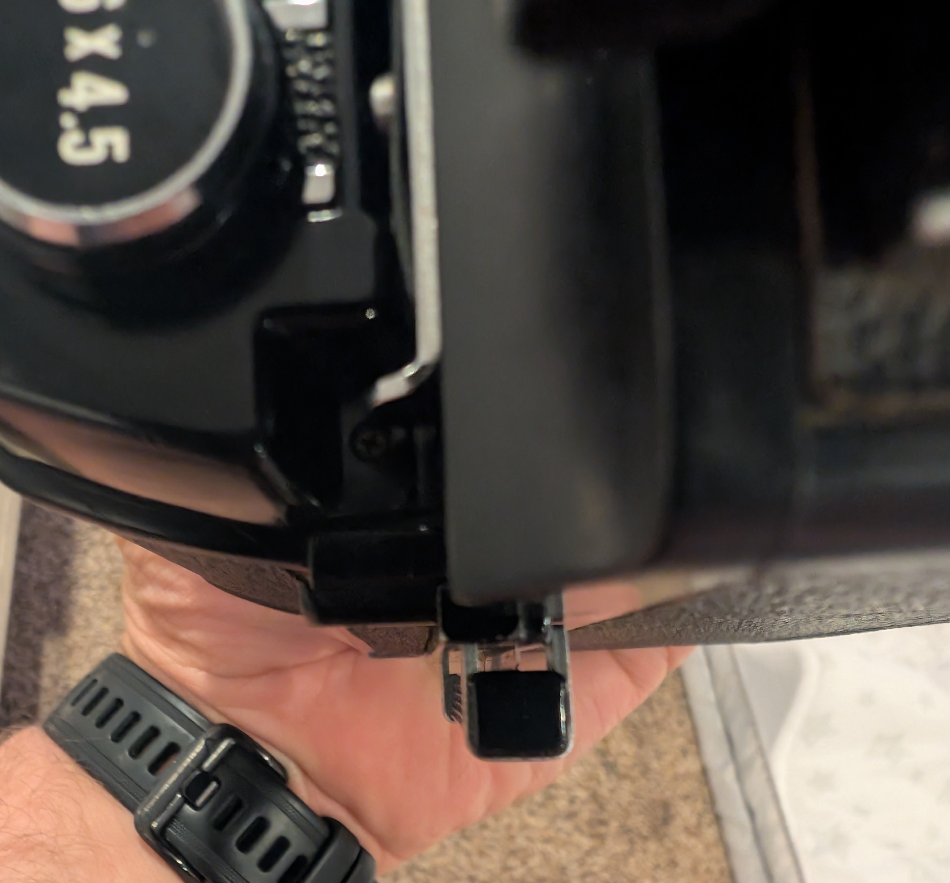

Mamiya RB67 6x4.5 on the Century Graphic, the only thing that I've noticed mounting is the dark slide pops out about 1-2mm, nearly imperceptible, I don't believe this will effect anything, as long as when I take off I push it the rest of the way in...

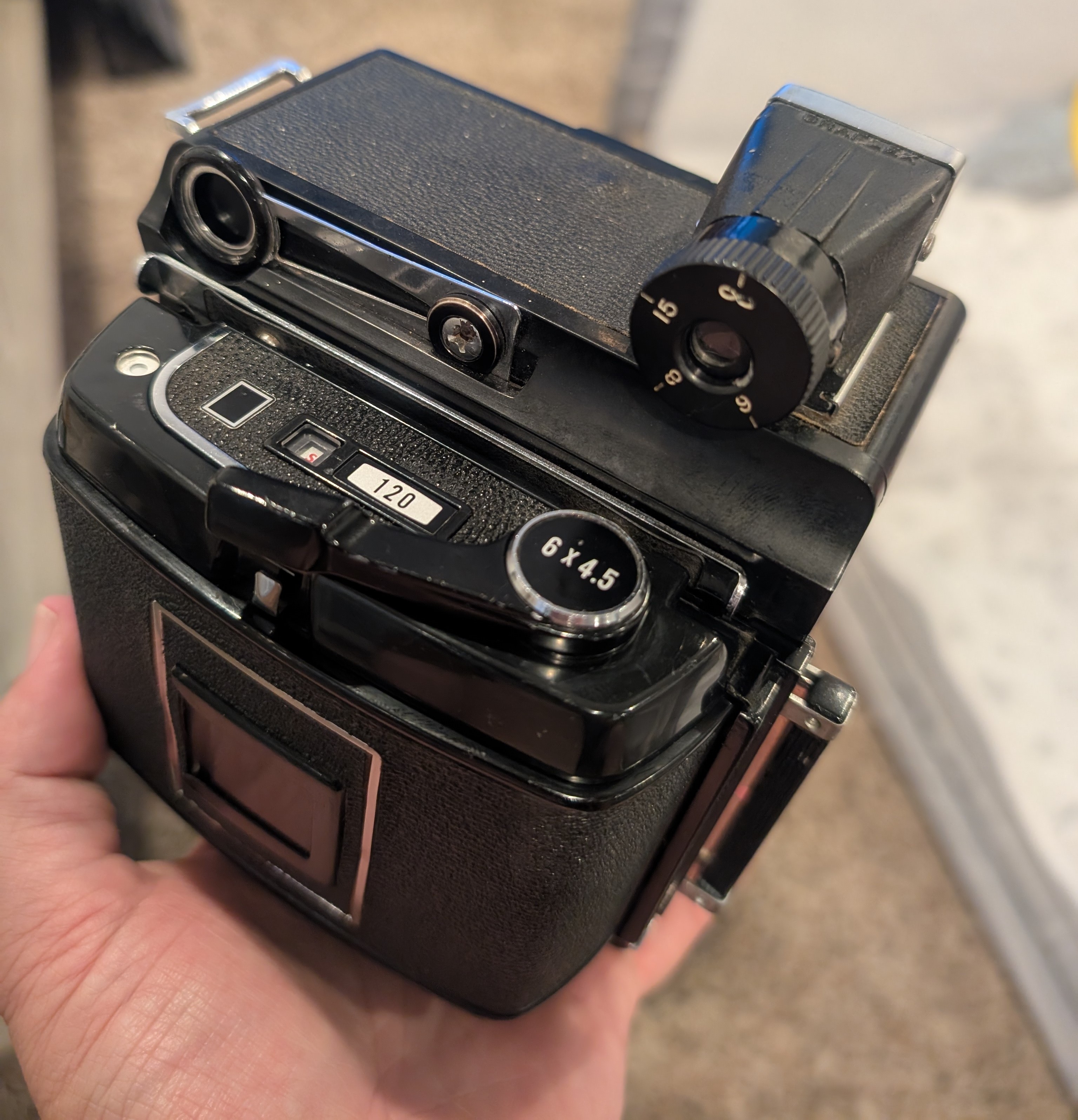

See what I mean about the roll back making it harder to get your eyeball up to the finder. Of course you can do it when way the newspaper guys do in the old movies. Hold the camera out half an arms length and focus your Kalart and use the frame finder for framing. Your eye doesn't have to necessarily close to the Kalart to focus. Nice looking rig.
Yes it definitely requires a different way to hold the camera. I loaded a roll of Portra 160 in the Mamiya back last night.
Unfortunately, I don't have a kalart for it, I would like one...I wonder if one of those focuspot attachments would make it a little easier to get your eye on it or if it would get in the way of the film backs.
So for now, it's the tripod and ground glass focusing, until I can pick one up.
Thanks, I'm very impressed with the camera too.

And no, you shouldn't see a problem with that amount of dark slide retraction. I haven't seen that on my 645 back on my Century, but I've only mounted it there once and my 645 back is a Pro version (no dark slide or double exposure interlocks to the RB67 body).
