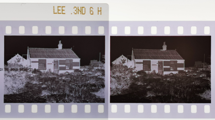

The King Mono 50 film itself was OK given 20% less development cf post 72 Sept 15 24.
The 2EZS test shows the +2 stops negative has a lighter sky (lower CI) and darker foreground (higher CI) than the normally exposed negative (attachment).
This is consistent with an S-shaped curve for this sound recording film in CD4-LC.

Whats especially apperent in that comparison is the difference in the hue of the negative. The one on the right is very warm in tone. Do you recognize this also in the real-life negs? I'd be surprised if a 20% reduction in development time would give such a pronounced difference in hue.

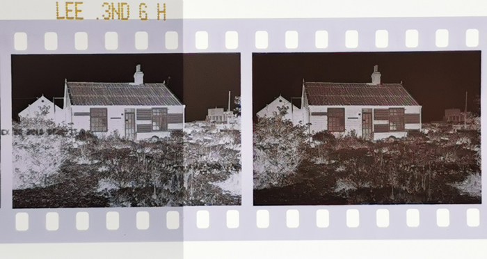

The difference in hue is partly due to a grey ND filter on top of a brownish negative. The negatives are less brown than they look on screen. I don't think this alters my conclusion that they are the result of an S-curve.

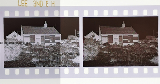

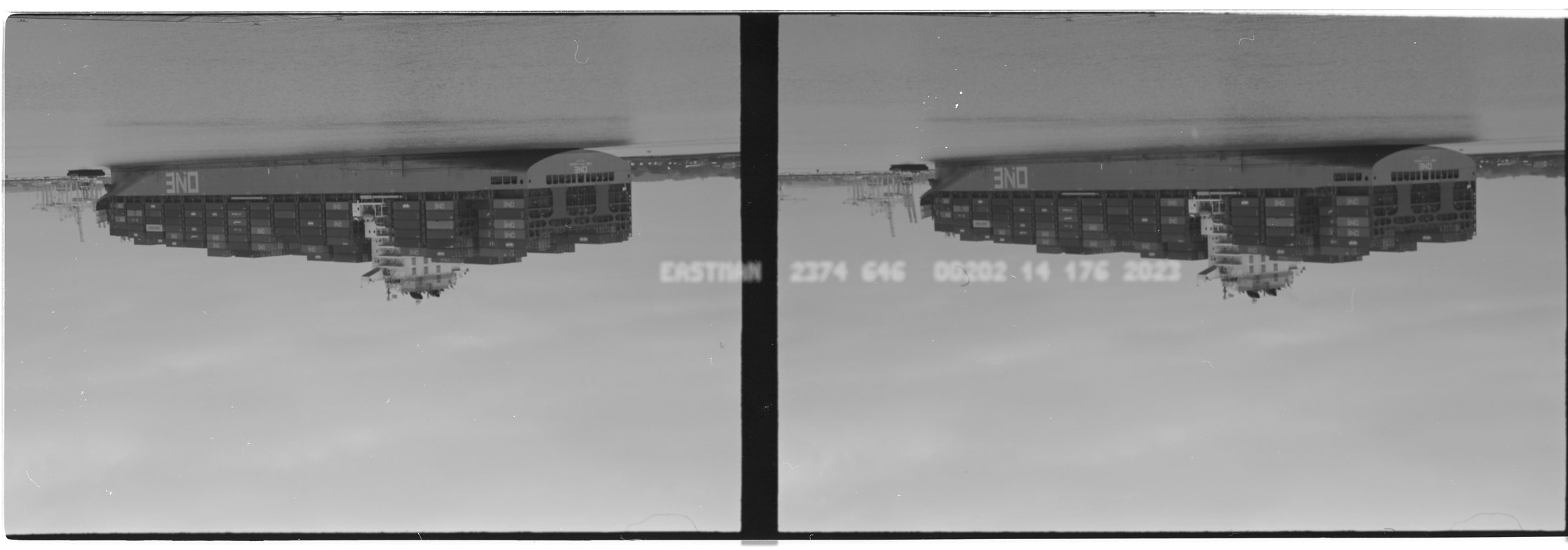

The King Mono 50 film is Eastman 2374 Sound recording film which appears to have been still in production till the recent updating of the Kodak coating machine.
Some pictures may be lost by the manufacturers mark every few frames (attachment).
The resolution of fine detail at box speed 50 is very good.

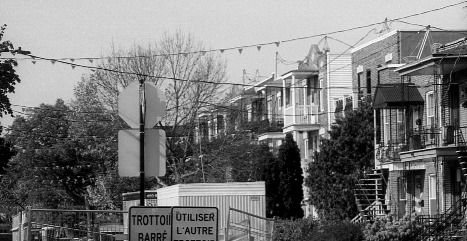

I'm also in the process of finding a replacement for CMS 20 (and TechPan) and I'm considering SHD 50 as well.

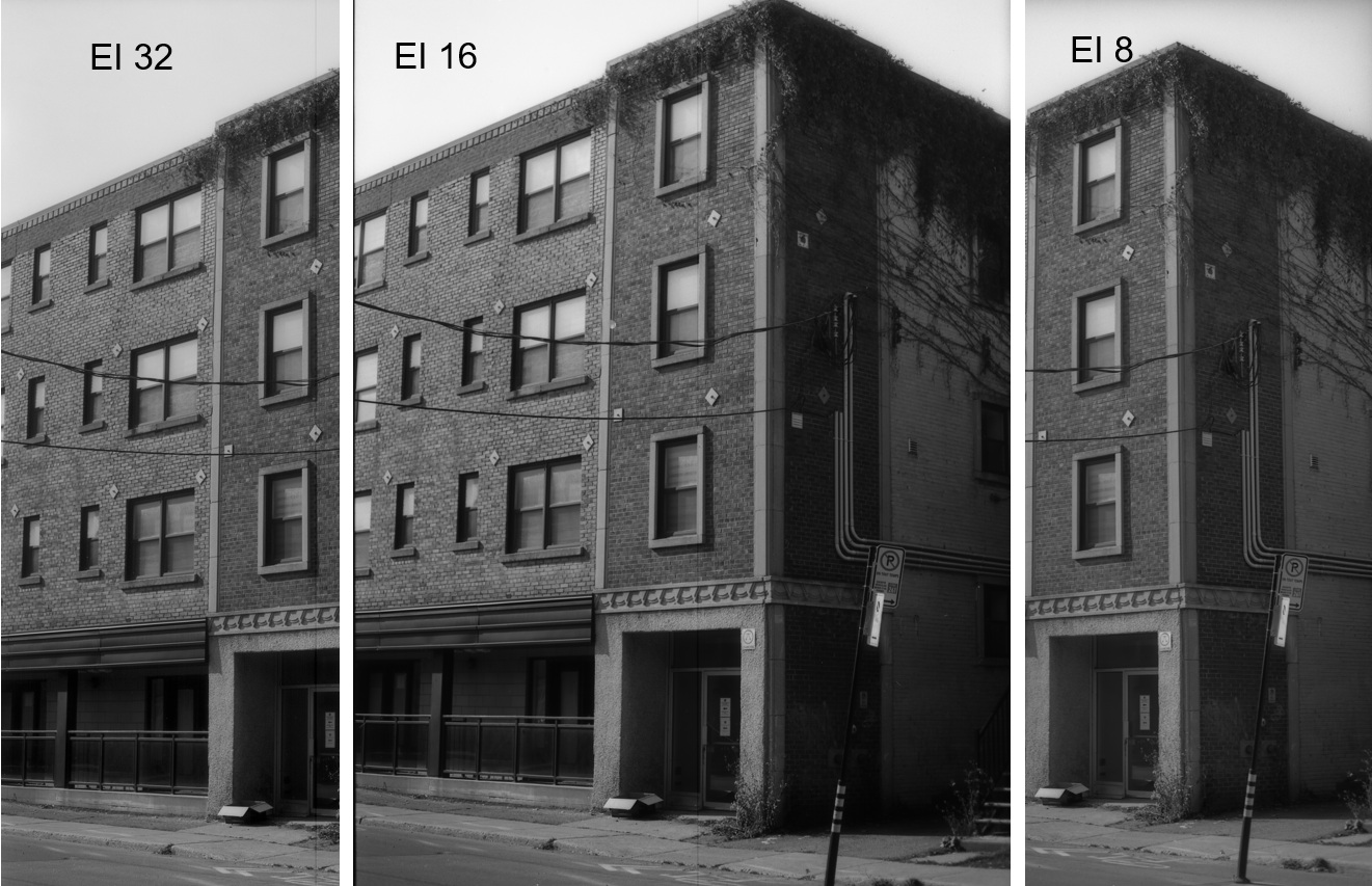

After tinkering with Adotech IV to develop it (image attached was at EI 16 iirc), I have mixed some CD4-LC today and will attempt development soon. I can confirm that the core loads properly in a Lloyd bulk loader with the emulsion correctly positioned. Did you use 9 minutes in your test shown in post #108?
And I suppose the softness is due to the light coming in from the film base side (fortunately unfixed SHD50 is pretty transparent).

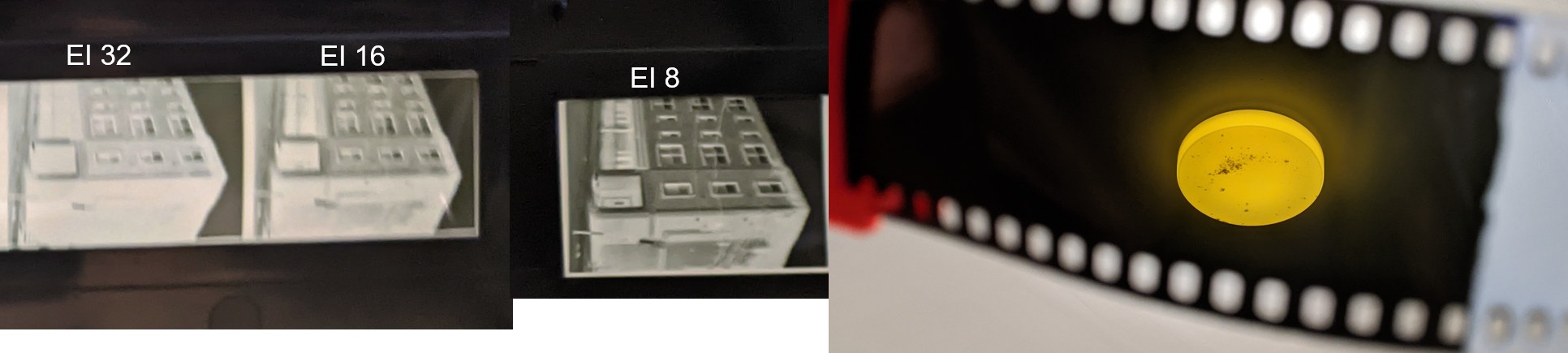

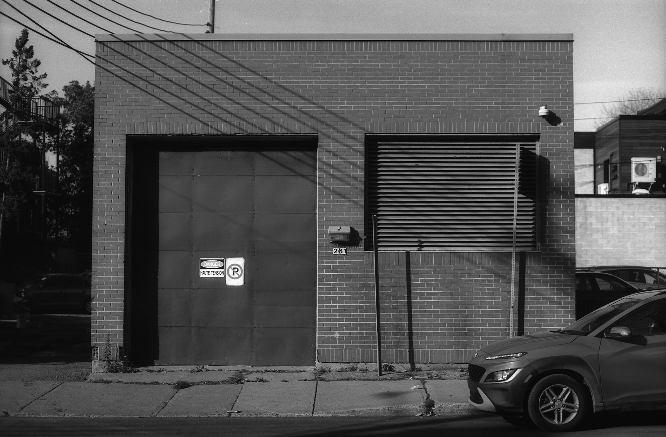

Success! At first I thought the leader part of the film looked slightly thin (see first picture), but in the end the images came out nice. I didn't obtain any softness so I will surmise that what we can observe on post #108 is halation from overexposure at EI 6, which would align the my observation that this is the worst film I've ever used in terms of light piping and light "spreading", and that nothing washes away from the emulsion (probably no antihalation technology whatsoever). I think I will try a base time of 10-11 minutes (with added exhaustion compensation) at EI 16 for the next round and see where I land.
I've also tried with some TechPan that I shot last month at 25. This was a different story; the negative has juuuuust barely enough density that I can recover images from it (see third image). Since this was the second film developed in the batch of dev, it's possible that by only mixing 500mL of dev total - from the start -, more exhaustion compensation could be required to account for less total unoxidized Metol.

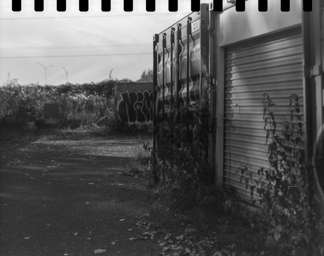

Congratulations! And thanks for sharing your results and experience. Did you notice any tiny specks in the full resolution scanned negatives similar to what Alan discussed in posts #108 and #109?
I'm not seeing any dots or spots on my images. Here's a crop of a shot from the same SHD50 roll:
