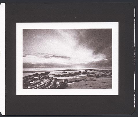

The Print:
It’s same digital negative I have used for other processes – originally curve-corrected for commercial POP. The white border is created with ink, not by taping rubilyth or Al foil as a UV barrier so it represents the true level of base fog for the current process/negative combination, which in this case seems to be quite negligible.
The Dmax is quite good too – even better than what I normally get for the straight salt print using this the same initial chemistry and paper. The lighter tones could use some separation – which means this process will need its own optimized curve for the negative. This is one great benefit of digital negative as it can be tailored once the process is fixed not vice versa.
Finally the tone is more neutral than a more reddish untoned salt print.

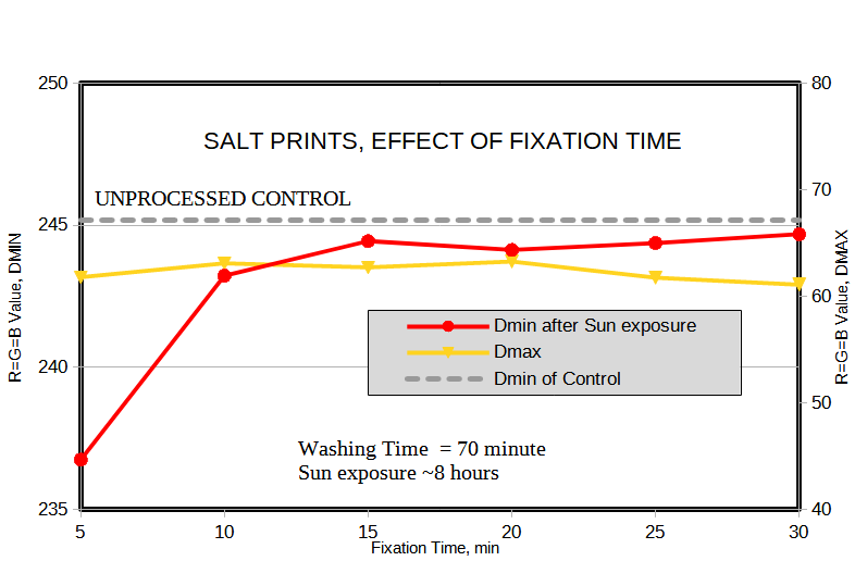

Earlier when I started back doing some tests on straight salt prints, I wasn't very careful with fixing time (lacking patience) and noticed all of those test strips were brown after a few days in the unexposed areas. Right around that time, Marek Matusz showed data that a long fixing is required to completely remove silver chloride from thicker papers (like 300 gsm or more) which would otherwise stain the paper - particularly accelerated if left out in the Sun. So I did my own study and found that it was indeed true for my process too. My data also corroborated Marek's in that no bleaching occurred with this extended fixing. 30 minutes might be a little bit of an over-kill, but since there is no penalty of any loss of Dmax, I figured it was a safe choice.
