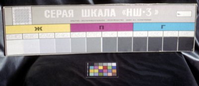

So ... Exactly one month. I prepared a working solution (stephan4u contributed C-27 formula).
No comments... :wink:
2019-10-16-0008.jpg 2019-10-16-0006.jpg 2019-10-16-0005.jpg 2019-10-16-0004.jpg2019-10-17-0003.jpg 2019-10-17-0004.jpg
I left some more concentration. I'll let him stand for some more time - and if I don't forget, then after 3-4 months I'll repeat the test. But now I can confidently say that glycol is a very good preservative for CDs.
