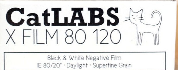

We have just launched our new line of films.
No doubt some will ask "what rebranding shenanigans are going on here?" and rightly so, as so many "new" films are just different packaging of more of the same or old stocks of film pulled out of deep storage.
We are happy to say that CatLABS X FILM 80 (at the moment only available in 120 roll film, but sheet film is in the cards for the near future), is a fresh, new emulsion not currently available in another packing form. With that said - it is clearly finished by one of the existing facilities of film manufacturing, that cannot be avoided, as there are so few of those and there are none such independent facilities not making film for the general public.
In a nutshell, this is a traditional emulsion, following in the footsteps of Panatomic X, with a very fine grain and deep tonal range.
This film is now in stock and is making its way to retailers around the world (and the US of course).
This film is currently with a number of Beta testers, and we will be posting samples soon.
As for CatLABS X FILM 320 - we are almost sold out of the initial very small scale test production run - we will soon have news about this as we ramp up to a large scale production, with a different, and all new emulsion (not available anywhere else). Stay tuned for news on this. We will be updating ASAP when this is ready.
