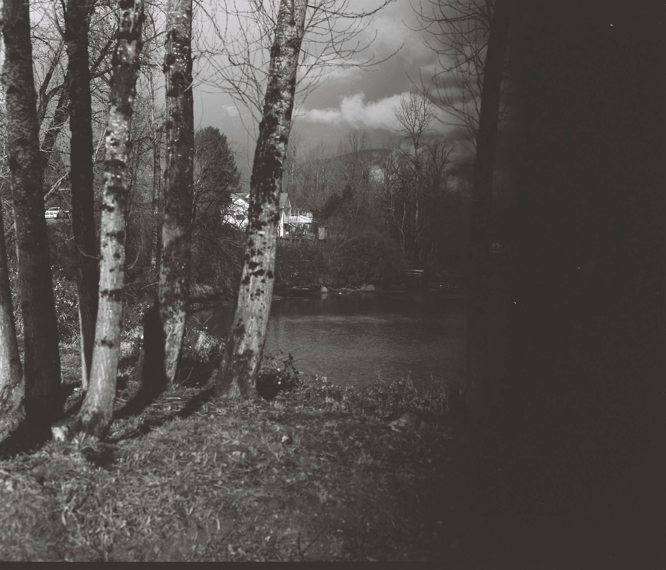

Well I got my first roll of Catlabs X80 back from the lab. It was shot in my Pentax 67II and for the most part, the images were completely unusable. I dont know if it was the backing paper or a camera malfunction. It didnt do this on my other roll. Needless to say my test roll was a complete waste, so I may not be buying this film again.
That's unfortunate. I wonder if it was a processing error and the lab you used just didn't know what to do with it. I've gotten quite nice results myself.
No I don't believe it was the lab. They use dip and dunk, so its nothing they could have done. All but one shot have the right side blocked off. Its almost like an incomplete shutter fire. But another roll (different brand) didn't do that when it was shot around the same time period (1/2 hour apart).
That right there is a failing shutter. Usually failing shutters do not manifest themselves in a consistent way, so it’s totally plausible that you wouldn’t see it on another roll.
There is no plausible way a film defect could produce that kind of exposure drop-off on multiple frames. Your shutter is closing the slit as it travels. Time for service.
It's impossible for a film to cause the right side of almost every shot to be blocked off like that. If it was the top or bottom of the frame, maybe. I'd have to see the whole negative strip but this 99% points to a shutter problem.
Was there something like a neck strap blocking the light from one side?
One side of the frame darkened means that the leading curtain is moving too slow and the trailing curtain is catching up, usually. You can try slower shutter speeds to see if it only happens at certain higher speeds. The P67 shutter is electronically controlled, but the travel speed of the shutter is mechanical. Which means that it may be possible to repair without going near the electronics.
