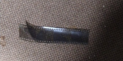

I tried to do some searching on cleaning negatives but didn't find exactly what I was looking for in this instance. I've been asked how best to clean some old 35mm negatives that have been peed on by a cat, obviously they weren't well kept. The cat pee is old and dried on the negatives. It doesn't sound like a good prognosis for any parts of the negative emulsion that has dried up cat urine on them but I first thought maybe a slightly warm water soak that might help but idk for sure. What about isopropyl alcohol?

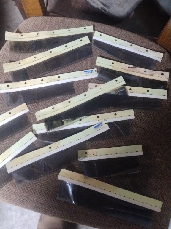

I failed to mention that these negatives were cut but not put in sleeves, which would've been protective, but had these attached to them for use in a ring binder apparently. Im not sure how old they are versus how old the urine is that's on them. I asked if they came off easily, he removed one.
I'll start with the safest option, a warm water soak and wash and just use a tray.

The lack of sleeves may have been helpful, in fact. At least, the gelatin hasn't fused and/or ferrotyped against the sleeves. Such damage is often irreversible.
I also see these are B&W negatives, which means they're inherently a lot more resilient than color negatives.
