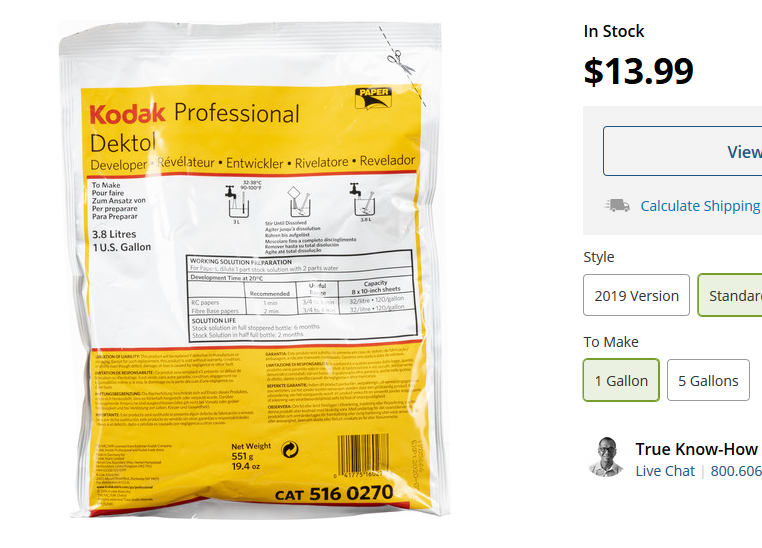

Cost-wise, have you looked into buying direct from US (B&H, e.g.) or EU (fotoimpex, e.g.) a 1-gallon size Dektol powder bag?

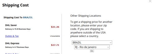

about costs: what i would save in price (if that much: our currency is not well nowadays...) i would spend in shipping and import taxes. so my options are carestream or caffenol :/
A 1-gallon packet of D-76 costs approx 40$ including shipping (taxes I don't know, do a little homework). Sure looks expensive, but with 1 gallon of D-76, used 1+1 one-shot, you can develop 25 rolls of 35-mm film. These 25 films cost here 6€ each, total 150€. So you are going to compromise the quality of development of approx 150$ worth of film to save 40$ on developer? (assuming you get your Carestream X-ray developer for free). Useful life of D-76 stock solution? store in in a wine pouch and after one year it will be like on the day it was mixed.
And note that my calculation is heavily biased towards worst-case. You could amortize the shipping costs by ordering a second bag of powder (infinite storage lifetime). And I bet that you pay more for film than what i entered in my calculation.
Your photos, your money.
well. i surely can afford even the high tag prices our local stores ask for it. the id-11 i am using now went for around 100usd. That on the dever alone. Put another 75 on the fix. (yep. they assault us good down here...)
but many people here in brasil and everywhere around the world cannot afford or lay hands on anything. Carestream and equivalents cost like 3usd per 500ml bottle and are pretty much everywhere: anywhere with a hospital, dentist or vet will have something equivalent. the fixer is even cheaper. and should last as long as any dedicated dever on the market.
