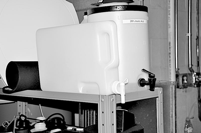

I got two of the 2-gallon tanks with floating lids around 2002 and still keep my chemistry in the. I use one for fixer (I pour 5-liter jugs of fixer into it) and the other for 28% acetic acid.
The valves on both of them still work fine and neither leaks.
The tanks use standard fitted spouts so, if one leaks, it can be replaced pretty cheaply.
