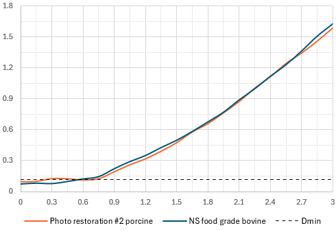

I did some speed testing just now. Unfortunately, that doesn't give me much to work with as it confirms what I recalled about my earlier tests.
I have three gelatins at hand here presently. One is a technical grade, cheapskate porcine gel that stinks to high heaven, has insoluble bits of crud (bone?) in it and that just won't even produce a print at all with DAS sensitization (it just slides off of the support during processing). So that one is out to begin with.
This leaves me with the GMW Photo restoration #2 porcine gel that Calvin recommends for the top coat. It's a great-quality product, very clean, reasonably clear, high bloom/good gel strength etc. I also have a bovine food-grade gel from a wholesale food supplements supplier here. It's also relatively high-bloom, but much more colored than the GMW restoration gel. Otherwise quite comparable. And, as you can tell from the plot above - they're virtually the same speed.
I may have to bite the bullet and get me some of the Photo restoration #1 gel. GMW's shipping costs are a bit on the high side esp. for small quantities, so I've been putting it off. Today I received their catalog (coincidentally?) so I'm going to see if I can bundle some other stuff into my order. Not that I really need anything...ah well.

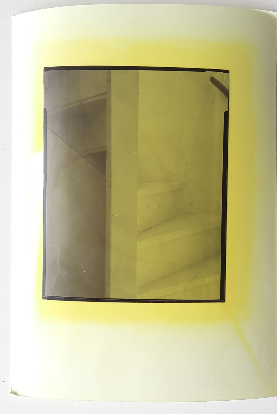

PS, FWIW, here are some examples of inkjet materials I tried:
Left is a generic, fairly heavy RC inkjet paper. This is a direct transfer. Looks OK at first glance, but if you look closely there's yellow stain all over and around the image. Moreover, there are odd wavy marks all over the print that result from idiosyncratic transfer weirdness with this kind of microporous material. Note that the stain on that one is what remains after attempting to remove it for about half an hour and 5-6 consecutive cycles of permanganate/bisulfite clearing. The regular temporary support sheets clear entirely within a single, 2-minute cycle. This same RC print looked like this before I started clearing it:
I eventually gave up trying to clear it; since I left it alone, it seems to have developed some more/new stain...
Middle print in the first image above is a direct transfer to Hahnemühle Baryta FB gloss 350gsm. This paper does not reliably survive warm-water processing; there's a fairly big blister in this print (hard to tell from the photo). Note the heavy DAS stain that's probably embedded in the paper base as well. This will be impossible to clear. This was part of one of my initial supercoat tests; as the example demonstrates, the results were exactly the same as with my regular materials.
The print on the right is a double transfer of an image initially transferred to my standard temporary support and then onto the Hahnemuhle Baryta FB paper. This avoids the staining problem, but as you can tell by the many white marks in the left side of the image, the transfer is incomplete - some bits of the gelatin matrix don't contact well with the Hahnemuhle paper, which really doesn't swell the way a regular gelatin-coated paper does. This results in myriad transfer defects. The temporary support also released with difficulty from the Hahnemuhle paper, and the Hahnemuhle paper is left in a quasi-ferrotyped gloss where the temporary support touched it, which will be a problem if the final image sheet is bigger than the temporary support on which the image is developed; the difference in surface texture will be easily visible.
So lots of problems in that area, not a whole lot of solutions.
