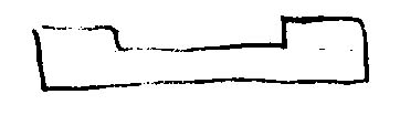

The camera base is only flat on one side, so it would involve some more major disassembly to put any kind of sheeting on both sides. A cross section of the base looks something like this, where the raised parts support the rails:
___ ___
----------------- [darn computers.... see attachment]
To put anything on the top side, I would have to remove the raised pieces that support the rails and get them back on the camera so that the focus track is aligned, etc.--more than I want to do.
While function is my main concern, I also don't want to change the look too drastically. If two or four carbon fiber rods embedded in the wood looked too obtrusive, for instance, I might cover the base with a veneer to match the camera.

Maybe a thin sheathing of one layer of glass laid in epoxy on the underside would be ennough to stiffen it? If you fill the weave with more epoxy when the glass layer just gets tacky, it wouldn't show. It is important to sand the wood before aplying epoxy. Then you, of cource, need to varnish the top part of the base with epoxy as well, so you wouldn't get any warping due to different humidity. Then use ordinary varnish to protect the epoxy from UV light.
If this wouldn't stiffen it ennough you could just put on more layers, or go carbon.

Where cosmetics are a concern you can apply a thin layer of cloth over the wood keeping in mind the following points:
1) Sand the wood first. Although epoxy works by Polymerization the bond to the wood will be mechanical and thus relies on "tooth" for adhesion. be sure to remove the previous finish. 80 grit will work well.
2) See if you can find some small scraps of good quality glass cloth. Use "S" cloth instead of "E" cloth as it is stonger. "S" for structural applications, the individual strands are smaller, therefore there are more of them and they made from higher quality glass using a better manufacturing process to lessen breakage.
3) Cover the bottom entirely with cloth; you may want to continue up the sides with this piece as well. On the topside you can cover between the raised bits only to make life easier. You should cover the raised areas and the sides (if not previously covered) with epoxy to create a complete moisture seal. This will look better as well.
4) There are epoxies with a UV shield in them so you don't have to varnish over the top.
5) I have used this method and when the glass cloth is wetted through it becomes nearly transparent and you can see the wood grain through it.
If you are going to stick with the truss rod method I would recommend that you call some wood workers to see if they have a horizontal boring machine. If they do you can get them to drill holes through the entire camera base. You can epoxy the rods in place, put a wooden plug over the ends and no one will ever know what is hidden inside.
Hope this helps, good luck.

Just a small comment if you would opt for glass. I think it would be difficult to wrap the cloth if the radius is too small. It might be better to let the cloth go a couple of mm from the edge.

Actually it wouldn't be possible to cover the raised areas or the top in general, because it would interfere with the operation of the camera. The back slides on the raised rails on top of the bed, and the front standard slides between them.
/matti
To wrap fiberglass around an inside corner you should insert a radiused or triangular fillet so that the corner is not too sharp. The insert can be wooden but a compatible foam or putty will also do the job.
To wrap fiberglass around an outside corner you should radius or chamfer the corner so that it is not too sharp.
In both cases you want to avoid breaking the glass fibers as much as possible.
