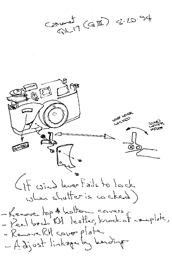

According to Rick Oleson...
...this is the part that locks the winder.
And I would assume that his next picture shows the shutter in uncocked and the winder in unlocked position:
And this is the same on my camera:
The problem is that on my camera the position of this lever is the same before and after winding.

I had a similar problem on one of my QL17 GIIIs. Even with bending that metal "wind lever" piece pictured in Rick Oleson's informative diagram the shutter mechanism never "locked" in place to allow shutter cocking. If I manually coaxed the sliding metal piece attached to the spring under the lens toward the shutter release side of the camera, the shutter would cock and then I could activate the shutter button.
I took the camera apart and it seemed that the actual shutter was not moving freely enough thus causing friction "drag" on the rest of the camera wind mechanism. I tried cleaning of the shutter but there was something wrong with it whenever I reinstalled it. After many months I managed to find a new (!) shutter only sourced in France. I transplanted the shutter and the camera winding, shutter cocking and shutter release now works.
Not sure if that helps you any but that was my experience.
