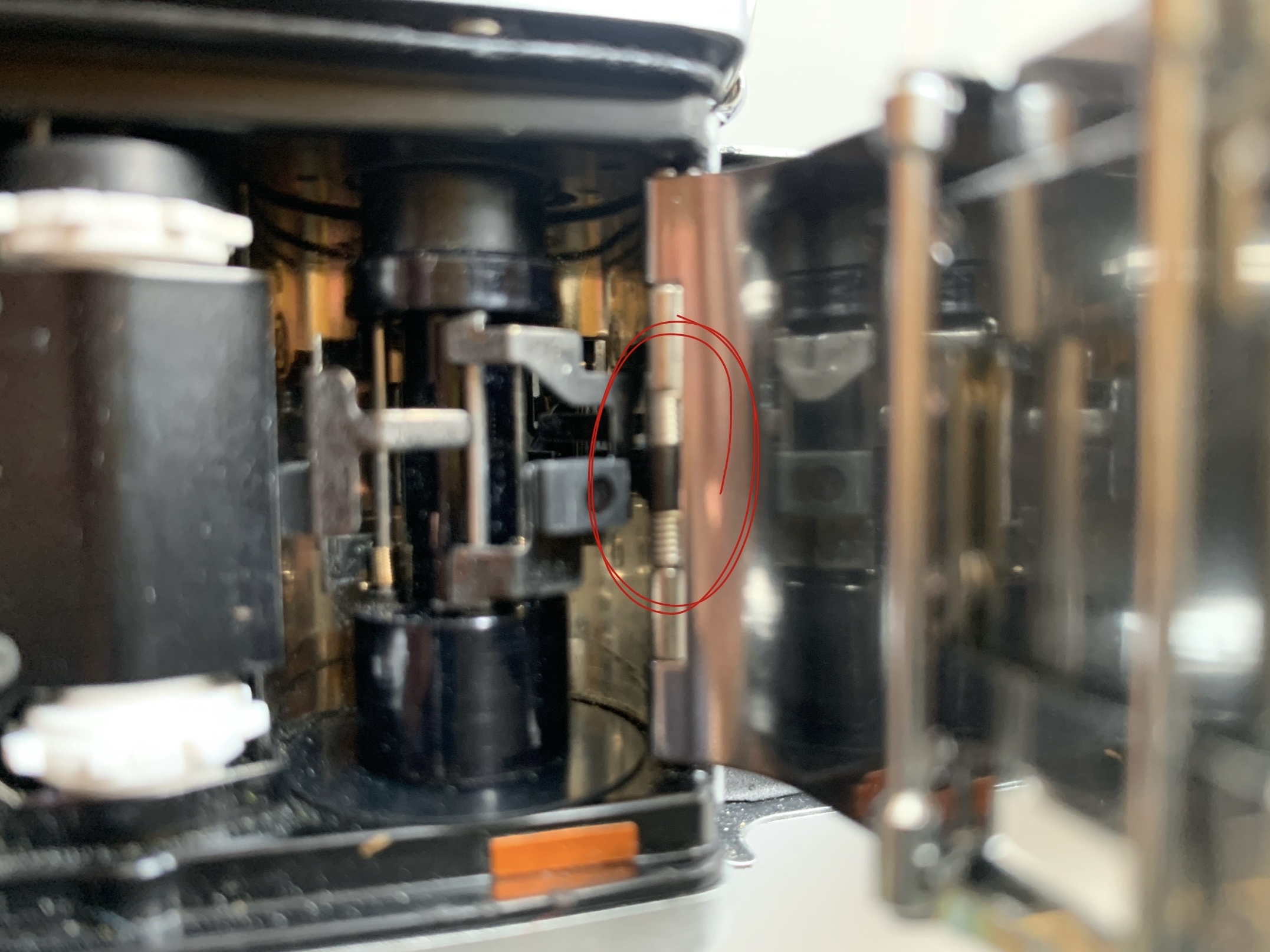

Inside the camera, on the right side of the pressure plate, there is this “auto-loading” mechanism, and at the hinge of it there is a small beam with some tiny rolls of some kind, and I think the scratches originate from there.
one can see it in the attached image.
Maybe some of you has the same Canonet: are those tiny rolls always without any tape or cover? And if so, can anyone offer a solution to fix these scratches?

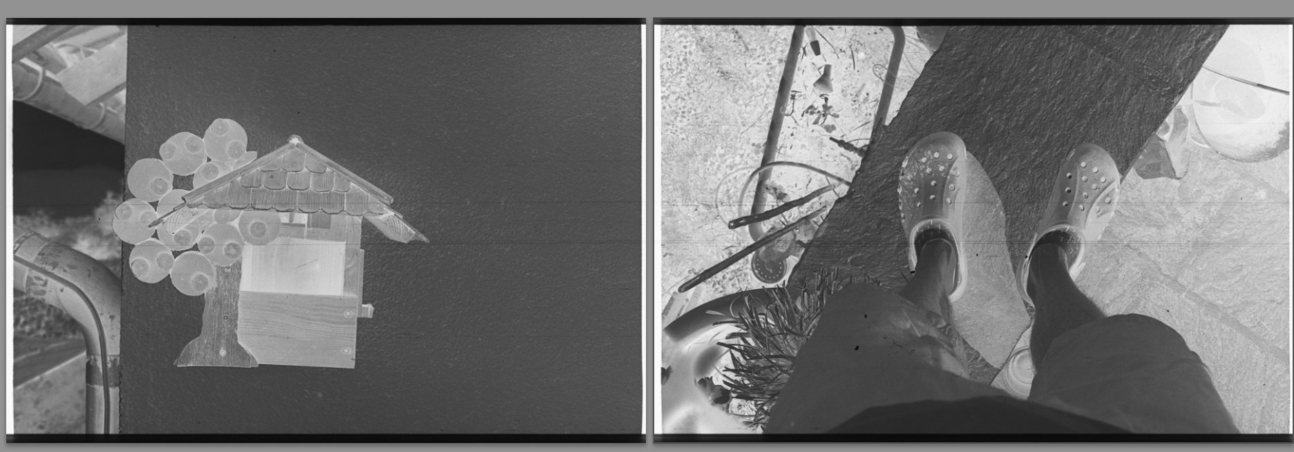

here are two frames. Ignore the heavy over development. I got 28° in my darkroom and because it was supposed to only be a test I didn't bother.
you can see several scratches in the middle of the frame, film winding direction.

Your QL mechanism looks normal. The parts circled in the picture are the spring-loaded hinge of the QL plate. I don't think they actually touch the film when in use. They look ok, there should not be tape or a cover on them (These don't actually roll, by the way). Toward the right of your picture, out of focus, are two long thin silver rollers at the end of the QL plate that press the film into contact with the sprocket wheel. These do roll and touch the film, and should be inspected to make sure they are clean and straight. You can also look for debris or nicks around the film gate, the sprocket wheel cover, and the pressure plate.

Lightseals got replaced. they are fine. no light leaks at all. As you can see from the picture of the scratches, they are identical on all frames. Particles floating around should produce various scratches across frames I suppose-
Yeah, absolutely. I assume they are on the backside of the film, correct? Also, they seem at first glance to run straight, but on closer inspection there seems to be a little waviness about them. Is this correct?
Is this film bulk-loaded by any chance?

The two rollers that reddesert mentioned are moving freely. The little ones in the middle near the hinge move freely as well when I move them with my fingers.

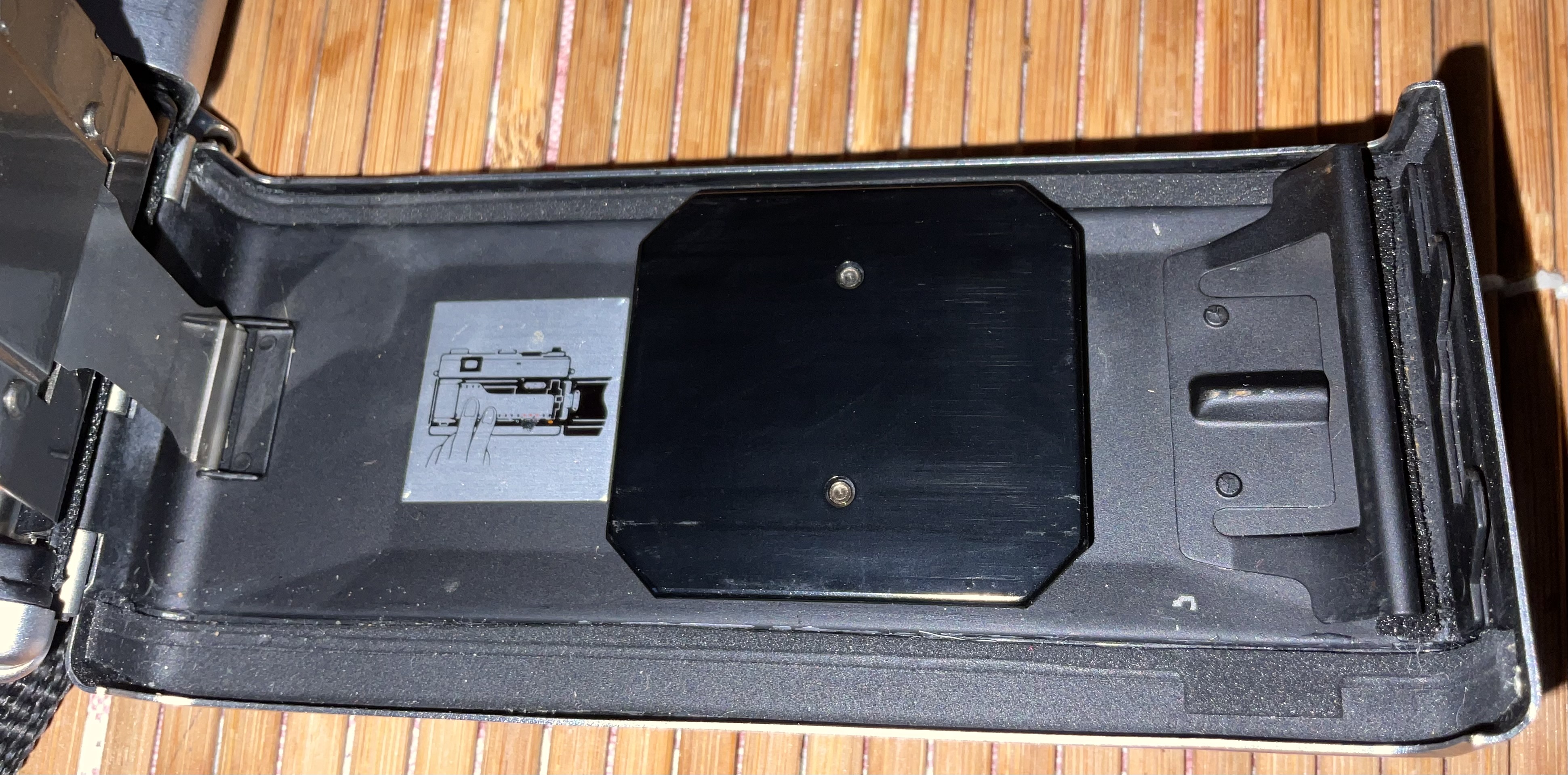

the pressure plate is indeed fixed by two screws. They are lowered into the metal.
However, one can see wear marks on the pressure plate, which I find strange. Never had this on any other 35mm camera.
See the picture attached
