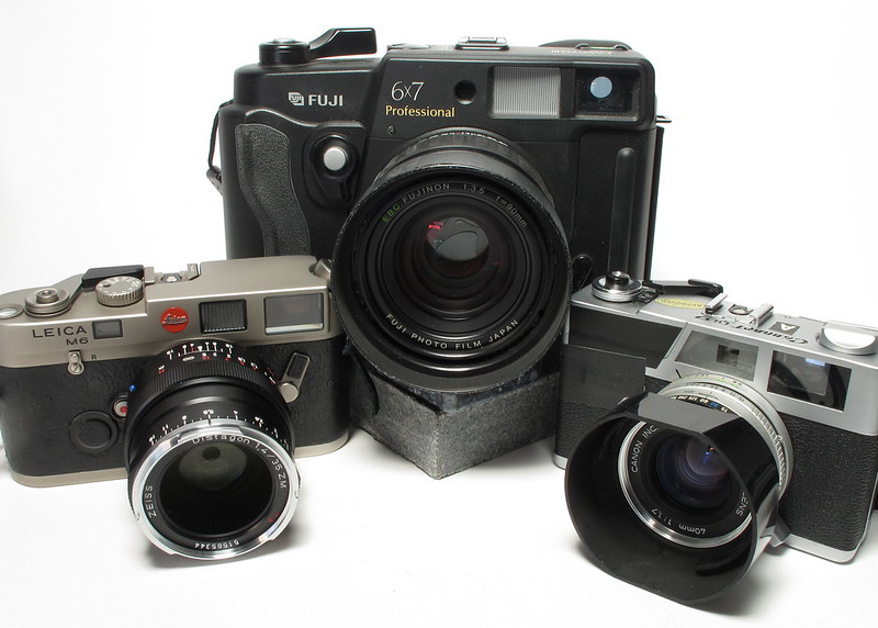

For decades, I owned and liked the Canonet QL-17 G-III (right) with 40mm f/1.7 fixed lens. I could have continued using the Canonet but I really needed interchangeable lenses.
Eventually, I purchased a Leica M6 (left) with 35/90/21mm lenses. For me, the difference in viewfinders, image quality, and ergonomics was insignificant compared to the ability to change lenses. It would have not been worth the expenditure for me to "upgrade" from the 40mm lens to a 35 and/or a 50mm lens.
