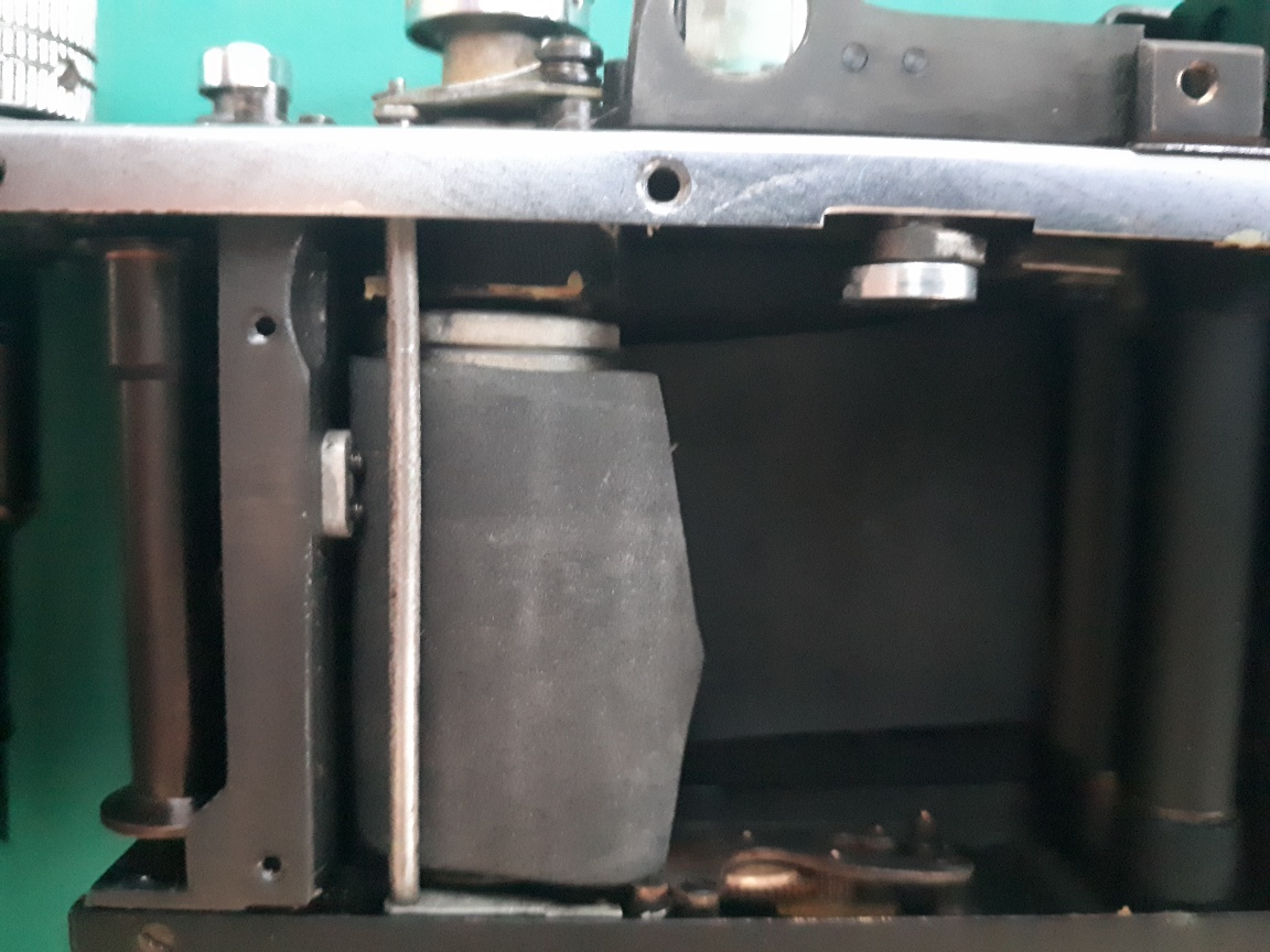

Honestly I wouldn't dig too deep if it is as good as you say. The front slow speed knob operates a cam that pushes against a bar that adds tension to the shutter curtain. If the cam comes lose, you may need to pull the front of the camera off to reinstall. Also you need to mark and photo as you go.
Heres a pick of a barnack canon b I prepared earlier, which is similar.
Also if your model dosen't have a bottom door lock, I would recommend taping the side latch as its easy to knock open.
VT is a great camera worth a service by a professional. If you want to practice on one there are plenty of beat ups for not much money. 20190331_173556_resized.jpg
