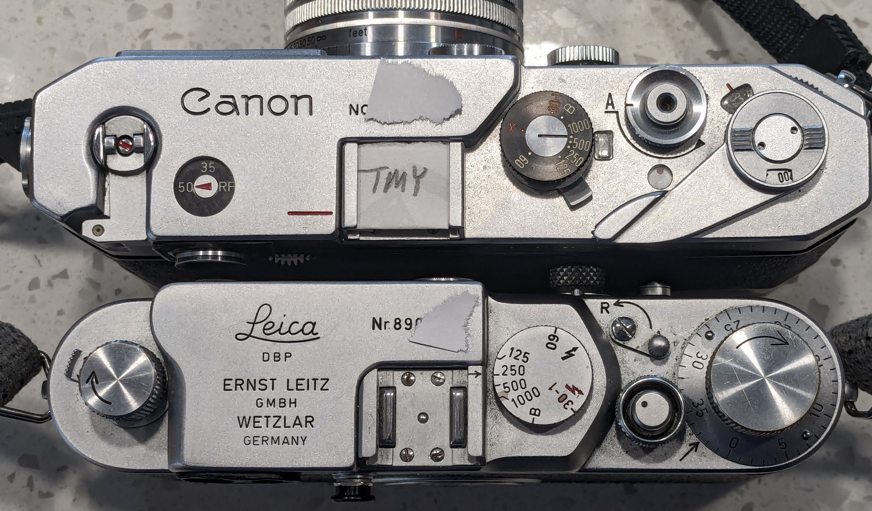

I have a Canon P and a IIIG, I also have a Canon L1 which has the two shutter dials and a switchable viewfinder kind of like the VI-L, cloth shutter and is not a bottom loader. So a few comments:
Moving my eye from RF to VF windows on the IIIG is quicker than turning the dial on the multi-mag Canon Viewfinders.
That said, I *do* like the multi-mag finder on the L1.
The IIIG VF has corners for a 90mm lens, but yes for 35mm you need an aux finder. The finder is nicer than the older leicas, but it's still not like the Canon P or L1
I can do the leader trim bottom loading thing, but its annoying.
That said, the *solid* feel of a camera body without a swing-open back is *wonderful*
The P viewfinder is a bit cluttered and the 35mm framelines are hard to see out at the edges, but its still a very usable camera.
The Canon metal shutters are a little bit louder.
have fun!

Thanks! You confirmed my thought that moving from RF to VF on the IIIG would be faster than fiddling with a dial on the Canons. Shame that the finder on the IIIG isn't as nice as the P or other Canons. It looks like the L1 is the same size as my VT, so the IIIG would be smaller still. I don't know if that would be a problem though.

Although I don't now own an 3G I seem to remember it has parallax compensated viewfinder. A greet boon to me. However you cannot check focus with a groundglass over the film window, which is important in my view.
When a working PJ I used either a 7s or IIIG as my second body to a Nikon F and F2. The Leica has the build quality, the viewfinder was very good, the the separate rangefinder made for very sharp focusing. But, I carried the 7S much more than the IIIG. In the field it was easier to load, the built in frames for 35mm which was my usual rangefinder lens allowed to put a flash in the cold shoe rather than use a flash bracket. If your standard lens is a 50mm and not in hurry to load film, then the IIIgs build quality in my mind wins out. If you use a 35 or 85 then you might want to think about a Canon 7s or 7sz, the price will be about the same as the IIIG.
Have to agree with Paul, the Canon 7/ 7s a really good rangefinder, not unlike an LTM Leica M in many ways. And they are nowhere near the cost of a IIIg- there are several on eBay right now between $100 and $200. Great big parallax corrected viewfinder with user selectable 35/50/85/135 frame lines. I don’t know why they are so inexpensive. The cameras that were competitive at the time were the Leica M2/3 and Nikon SP, and they go for way more money.

Thanks both. I hadn't considered the 7s, but upon looking into them, they look compelling. I thought they were bigger, but they don't look too bad side-by-side with a P.
