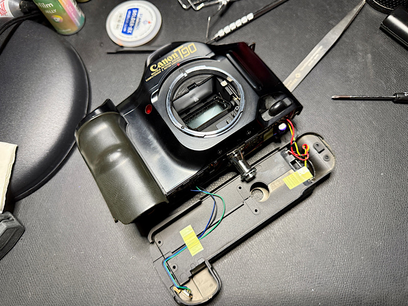

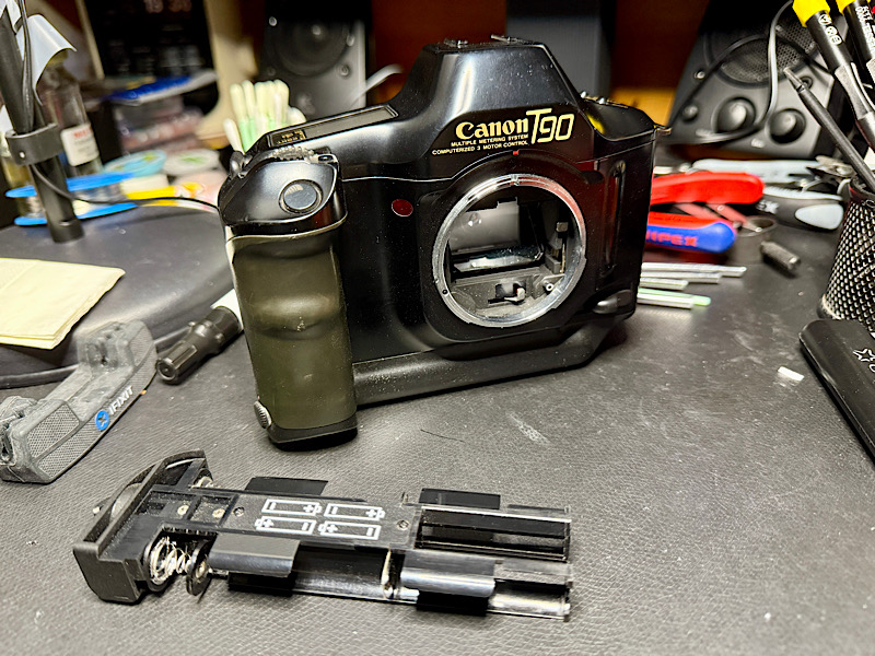

Checking a Canon T90 according to the troubleshooting instructions by Larry Lyells in the SPT Journal.
No sign of life.

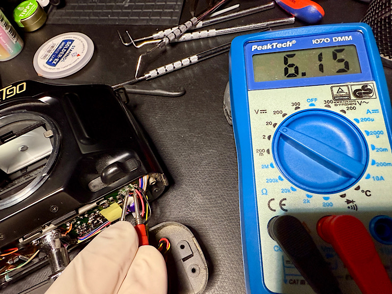

Battery compartment removed, measuring the input voltage on the DC/DC converter.

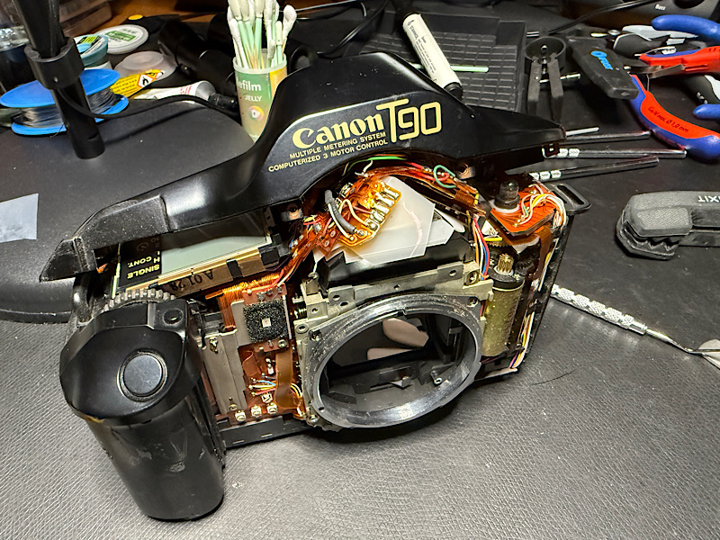

Front and top cover removed for further measurements.

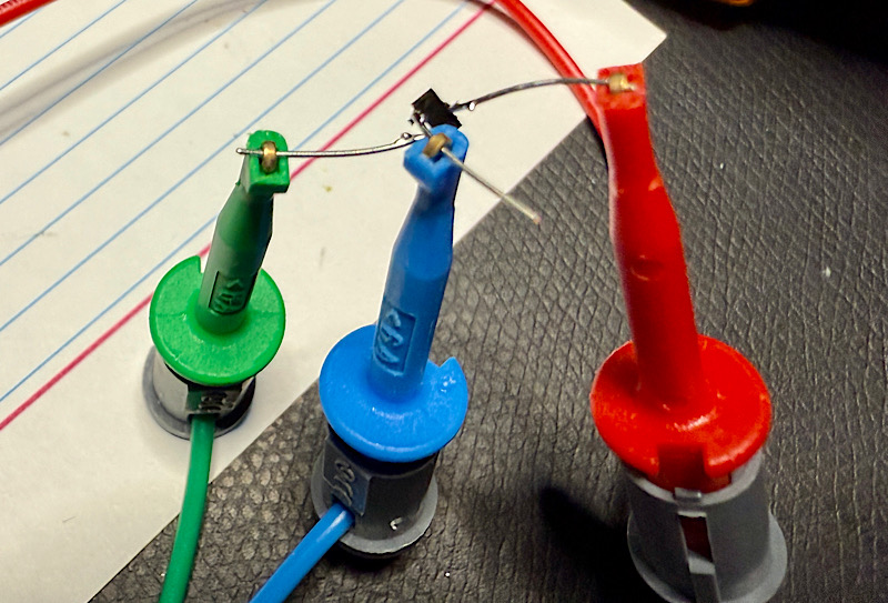

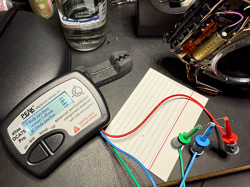

A double diode needs to be tested. To do this, I'm desoldering it with hot air.
The diodes are ok.

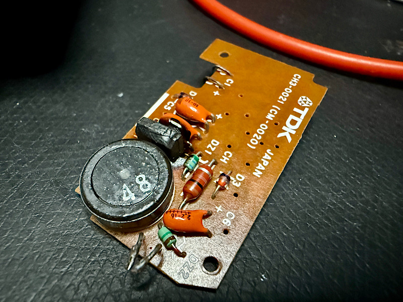

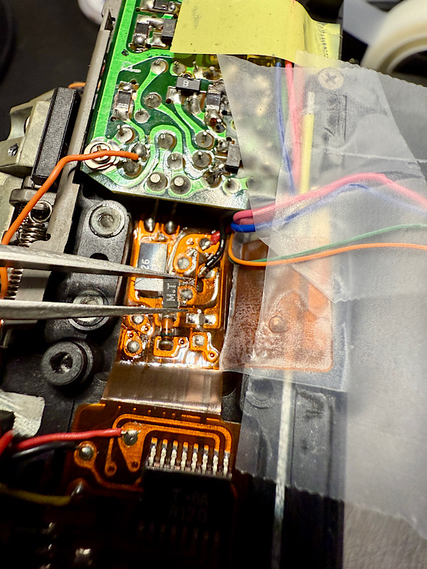

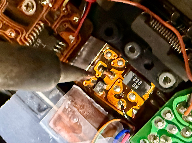

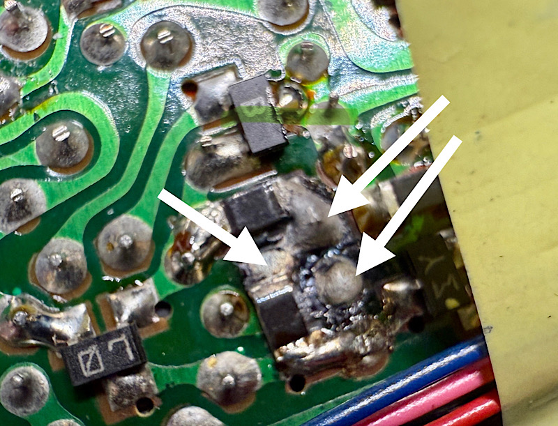

The DC/DC converter, which generates different voltages from a 6-volt input (4 x AA batteries), has incorrect voltage readings.
There are obviously cold solder joints on the circuit board that I can't repair.
The converter is defective; I have a replacement in my stash.
It's hard to make out on the photo, but it looks like that part of the PCB overheated. Something downstream might have shorted out, causing overload on the DC/DC converter. That's just a guess though.
Either way, I'd be cautious replacing it since you might just end up frying the next one, too.

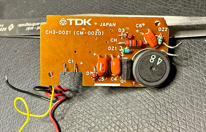

DC/DC converter. Front and back
After the replacement, the T90 is back to life. All functions are working.

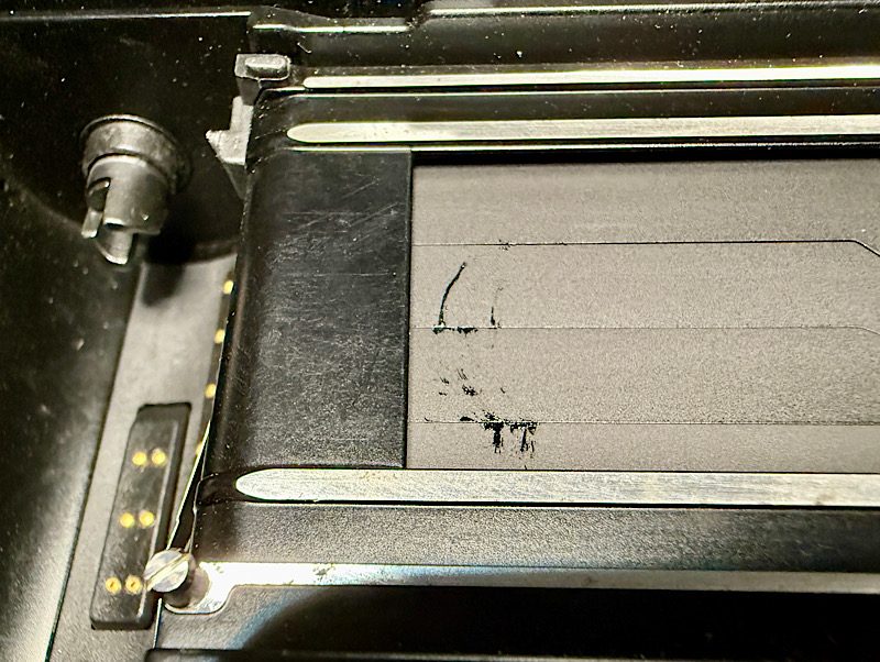

As with all T90s, the sticky shutter is also present here.
Yes, a transistor may have been overloaded; it doesn't look good. However, I desoldered it at high power. It's safest to replace the entire assembly.
Not sure what that means.
What I meant is that the DC converter supplies power to other parts of the camera. The failure of the DC converter may be due to failure elsewhere. Monitor power draw on the converter closely.
I'll monitor this and measure the current flowing through the converter. Voltages too, which are measured via the back of the circuit board.
I now see you added a photo to #4 that I didn't see before. That switching transistor is fried, obviously, and it's not due to desoldering. The question is why it broke.

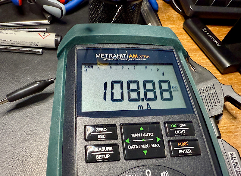

Current and temperature measurements
I measured the following currents in the T90 (without film, connected to the laboratory power supply; in brackets the reference values according to the SPT Journal):
  • Main switch OFF: 7,8 uA (7,0 uA)
  • Main switch (LCD) ON: 44,5 uA (430 uA)
  • Trigger switch (lightmeter, LEDs and LCD illumination) ON: 109 mA (190 mA)
  • Serial shooting in motor mode HIGH: 600 mA (650 - 700 mA during film advance after exposure)
Additionally, I measured the surface temperature of the connectors on the DC/DC converter board with an IR thermometer.
The temperature remained constant even during serial operation.
I conclude that the problem was with the DC/DC converter and that replacing the board resolved it.

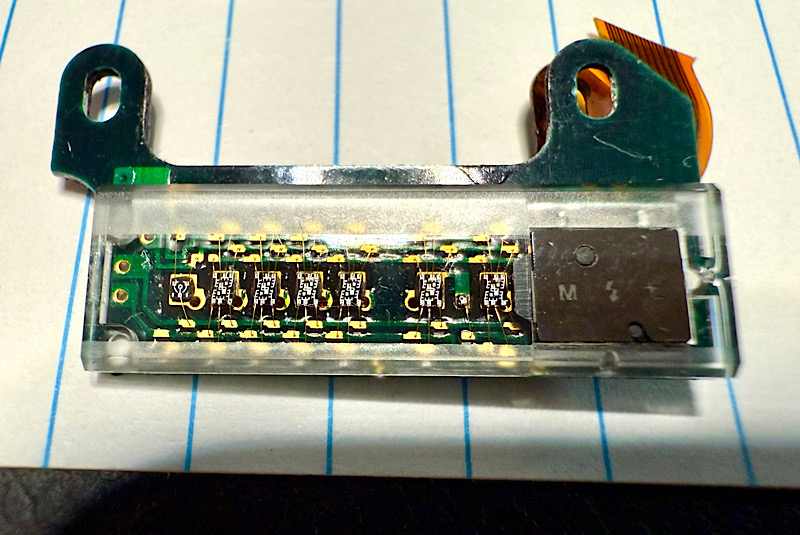

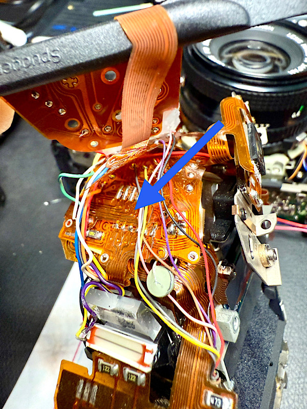

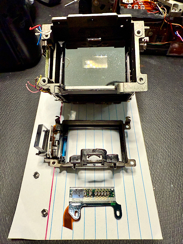

Possibilities to replace the viewfinder LEDs
A digit in the viewfinder display (a bar on one of the seven-segment LEDs) has failed (see the thread). This means that the displayed values can still be read.
I've looked into possible replacement options.
Position of the board with the LEDs.
Unit diassembled (on a spare parts mirror box).
The LED unit is attached to the FD board, which is soldered to the mainboard (blue arrow). It can be removed.
Alternatively, only the LED array could be separated from its circuit board. This can be done using hot air.
However, soldering it back on is a delicate process; the connections would have to be tinned and then re-soldered with hot air, out of sight.
Conclusion
  • Both options are risky.
  • Replacing the FD board with the LED array also involves replacing an IC that presumably controls the LEDs. I don't know the board versions or whether they're compatible, so it would be an experiment.
  • Soldering and re-soldering the LED array is tricky, and if it's not done correctly, it could render the connection unusable.
  • I'll therefore leave everything as it is. The failure of one digit doesn't justify the risk.
  • It remains to be seen whether the failure is related to the previously defective DC/DC converter (possible overload). I'll continue to monitor this.

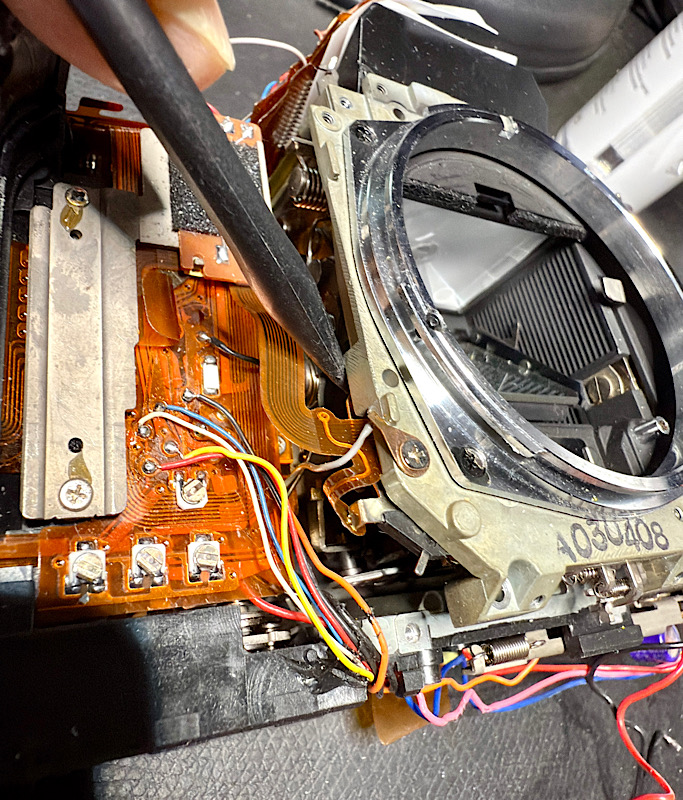

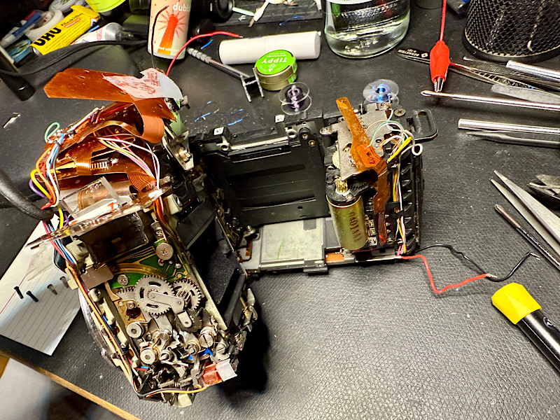

After assembling the T90, the charge motor started briefly as soon as I applied voltage, followed by an EEE on the display.
By lifting the mirror box and operating the mirror switch (SW13) I was able to start the camera for a moment.
The SPT Journal has a dedicated troubleshooting instructions for this.

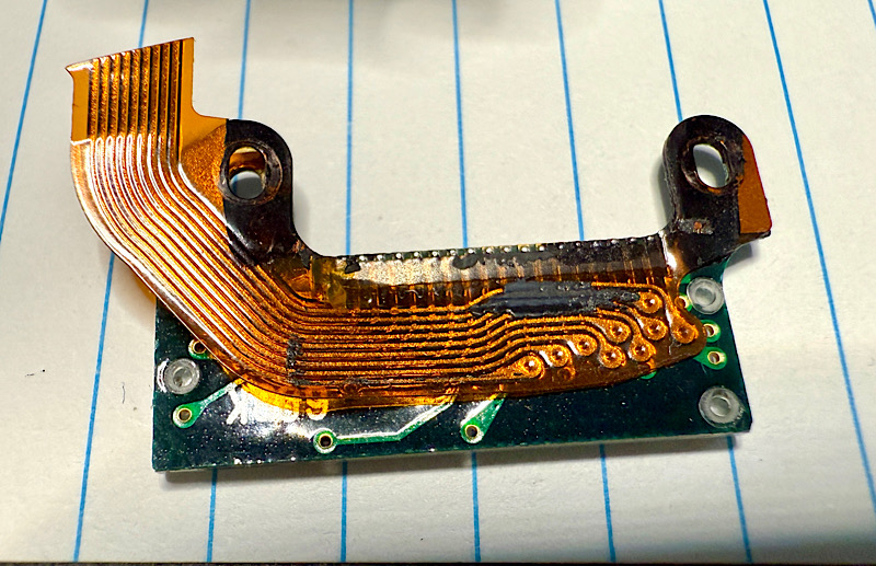

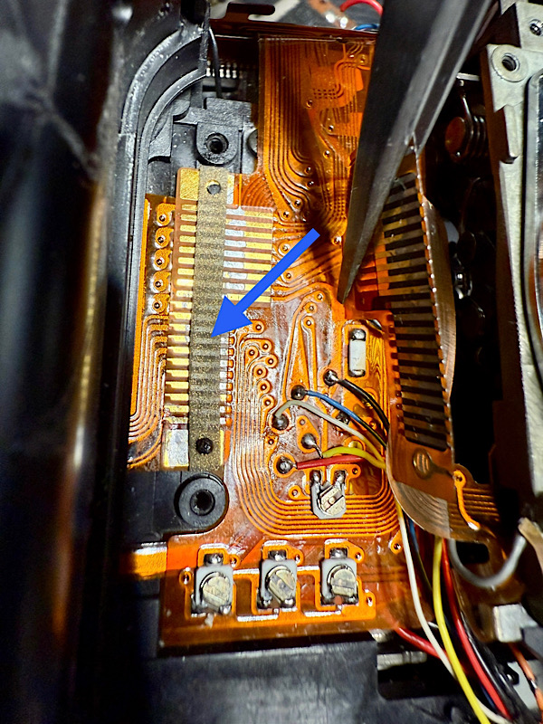

And so I was able to locate the error. It appears to be a contact problem in the front flex connector under a metal pressure plate.
Here, three circuit boards are connected one above the other with gold-plated contacts.
Elastic connectors with gold-colored inclusions are located between them.
By tightening the two pressure plate screws differently, I was able to get the T90 working again.
Only during continuous operation did the mirror occasionally stop working. Inserting two elastic connectors one above the other improved performance.
I also cleaned and polished the externally accessible contact surfaces of the release magnet. But as I touched the release magnet with the screwdriver, the camera jammed and EEE was permanently on the display.
This problem now occurred with two T90s after assembly. The cameras worked before.
I suspect that after parting the boards, the connection via the elastic connectors no longer works reliably.
I couldn't figure out how these work. They connect all rows of contacts without short-circuiting them, but must still be conductive because they connect two boards each.
I've now ruled out any mistakes during disassembly and reassembly as it already worked and I strictly followed the instructions by Larry Lyells in the SPT Journal.
It's a shame, but I'll keep at it.
A few defective T90s are still waiting in the box 😌
This makes it clear why this T90 has not left the EEE error status anymore.
Either because the mirror box was pulled out or because the mirror mechanism came into contact with the screwdriver (and the resulting blockage of the charge motor), the mirror charge lever was bent.
This meant that the mirror could no longer be tensioned, and if a station fails during tensioning and release, all subsequent stations also come to a standstill. The T90 reports this with EEE. Switches built into the mechanism report to the control electronics when a process is completed and the next one can start.
Lesson learned and the problem has been identified. This should make a solution possible.
Does anyone know of these elastic connectors? Is there a replacement or alternative?
No, haven't seen them before, but they look like a kludge that bridged the gap until proper FPC's became available. It also looks like the conductor tracks are visible on there; have you measured conductivity of the strips to see if the pattern of the connectors is perhaps present in conductive material on the strips themselves?
I can see how you might DIY a fix for this. The crudest and easiest way would be to simply solder the connections together, but this of course may make later servicing and repairs more time-consuming and risky. You might be able to clean these strips as the problems you're observing reek of fouling or corrosion.
In order to thoroughly clean the shutter of the sticky damper (this problem affects every T90), it must be removed and disassembled.
As a test, I soldered thin enameled copper wire between the contacts to see if that would solve the problem. But it quickly became confusing.
Direct contact without elastic connectors didn't change anything.
Then I tinned the contacts and soldered them with hot air. That killed the T90 ☺️
They are high-impedance according to measurements.
I can see how you might DIY a fix for this. The crudest You might be able to clean these strips as the problems you're observing reek of fouling or corrosion.
I tried using electronics cleaner.
