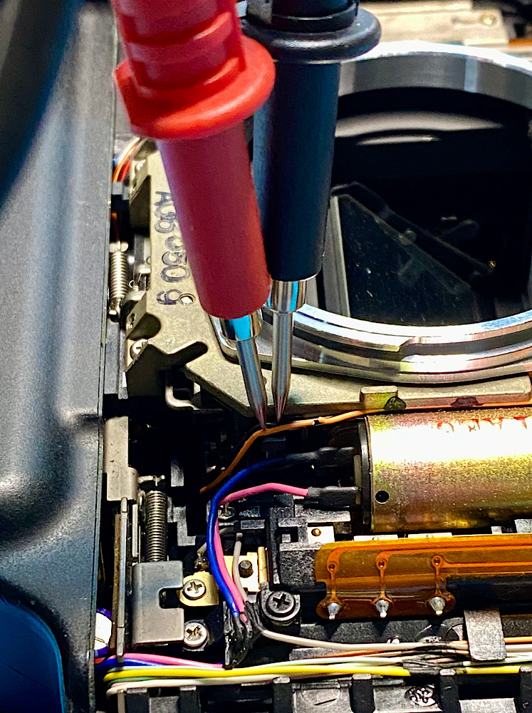

I was able to remove the covers, find my way through this #`¤¨`~¤ magnet.
I tried applying 3V to the magnets and, as expected, my T90 did not release the mirror while the donor did. Diagnostic somewhat clear then.
On my T90, removing the magnet was easy, except for the screw that jumped somewhere... It took me some time but a good slap on my hand finally got it outside of the body.
On the donor camera, this has been a different story. The slotted screw did not want to turn, so the head finally got damaged and it became even harder to extract it. So I had to find a way, and this was by butchering as small saw blade to enlarge the slot, so that I could use a bigger screwdriver. After some efforts I've got it, so I could get the magnet out (well, first I only got the core, the solenoid chose to stay inside... finally got it also)
A quick test gave me food for thoughts: the two solenoid seem to have the same resistance, so the issue is not electrical. I plan to test the cores and see if they have the same magnetic force...
To be continued when I'm back home, and of course I'll report my findings!
BTW, the Dremel vise is very helpful!

Some interesting developments for today...

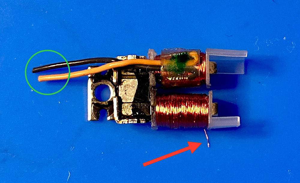

A few days ago I was able to remove the two mirror magnets, one was very resistant to removal and I had to enlarge the screw's slot to get it.
As I reported, both have very similar resistance (66.5 ohm for one, the one which had the blinking arrow issue, 68.7 for the other. @Andreas Thaler I'd love to know if you could check on some of your T90s just to see if this is confirmed).
I soldered some small wire (way too thick but I wanted to test... some appropriate wire is on its way) on both magnets, and put the working one in my camera.
Good news, it was now able to move the mirror.
Bad news, it showed the EEE error.
VERY Good news it fired a few times when slapped on my hand.
Bad news again it stopped operating and would not even turn on... a tiny wire got broken (comes from the remote command plug, can't understand why it prevents the camera from even turning on). Resoldering it got the camera back to operationg.
Then I decided to put the battery box back in place so that I can do some more tests involving hand slapping. And of course the camera does not turn on !!!
Will see this another day.
I also plan on testing the "defective" magnet on the other camera, so that I can see if the slight resistance difference plays a role, or if some other factors are involved. Could be the "default" magnetic strength of the magnet, in which case I'd love to find a way to fix this.
I'm also wondering if removing the magnet for a few days could explain the results...

Unfortunately, I can't measure the magnetic switch on the mirror box of my scrap T90.
The coil wire (red arrow) is broken, so a resistance measurement on the forward and return conductors (green circle) would produce a high-resistance measurement result:

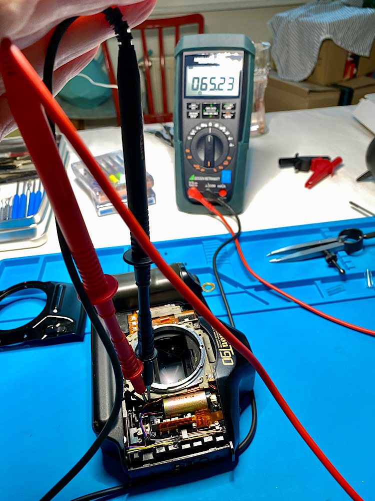

Measuring the coil on the magnetic switch under the mirror box on my Canon T90 gives ~65 ohms.
Measuring conditions:
  • The magnetic switch is measured when installed.
  • I use measuring needle tips that pierce the insulation of the supply conductor (orange) and return conductor (black).
  • To create a closed measuring circuit, I cut the leading conductor.
  • The approx. 2 cm cable length each from the two measuring points at the start and end of the coil winding should not add any relevant resistance value.
@Laurent
Is this value plausible for you?
That would constitute less than 5% difference in magnetic field strength, assuming that the measurement is actually reliable. Differences n contact resistance at the measurement points could explain the entire difference easily. I don't think the difference in resistance is a factor in the problem.
The direction of demagnetization of either of the permanent magnets involved seems more promising to me.
Measuring the coil on the magnetic switch under the mirror box on my Canon T90 gives ~ 65 ohms.

Thanks!, yes this seems plausible and in line with my own measurements!
I agree, I just wanted to make sure. The fact that both magnets work now proves it even more clearly.

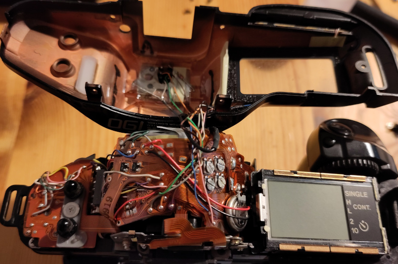

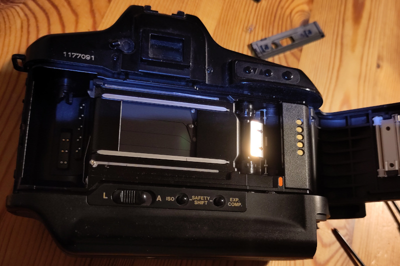

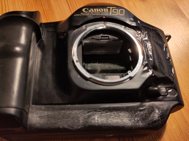

I received two T90s I bought for parts, with melted front panel and battery packs.
My plan is to use these as guinea pigs to practice before I try to dissect the two other ones to access the shutters.
I think this shows the "oven" treatment should be well done (I'd assume the camera was treated with a hot gun). the cameras as so altered that it's impossible to insert the batteries holder.
Today I started an autopsy on one of these just to see, and also started storing small parts in little pouches for future use.
I collected many parts for future use, and could see that the camera's front panel is also melted on the inside. I could recover the DOF preview button as it is made in two screwed parts. The LED cover itself is half melted...
Apart from that the inside looks clean
I removed the top cover to check the status and again it looks fine. I also made a picture for future reference as I plan on unsoldering the wires to access the shutter.
Of course I removed the battery holder as it's dead, and took the opportunity to try to hook the camera to another camera's pack for a quick check. Believe it or not, the camera turns on, the display seems OK and the shutter operates (then I get the "EEE / HELP" error). The mode button also works, as does the drive/self-timer button.
I had no opportunity to shoot an image, as I already needed 3 hands to do everything at once.
I noticed there's a third wire in the battery holder, it seems to short something when the battery is removed. I suppose this resets the camera, as when I just lose the precarious contact with the external battery the camera does not turn off immediately, but the display fades slowly...
To be continued... there is still another melted camera to open, and I need to devise a way to hook the camera to a proper power supply...
