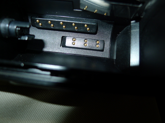

Have been looking at the DX pins. They are all the same apart from the bottom 2 on the smaller rack where the pins look hollowed out, is this normal ? I will put a pic here, maybe someone with a T90 could compare for me.
The two “hollowed out” pins on your camera are identical to the pins in my T90. While I haven’t used the camera recently, it has always worked properly in the past reading ISO. Though I often bulk load and set the ISO manually. But — I don’t honk those two pins are the source of your problem.
Thanks, at least I know that is not the issue. As above I now suspect a dry solder joint somewhere, I will delve deeper when I have the inclination. For now I'm not too concerned as I rarely rate my film at box speed anyway. Would like to get it sorted though so the camera is 100%.
