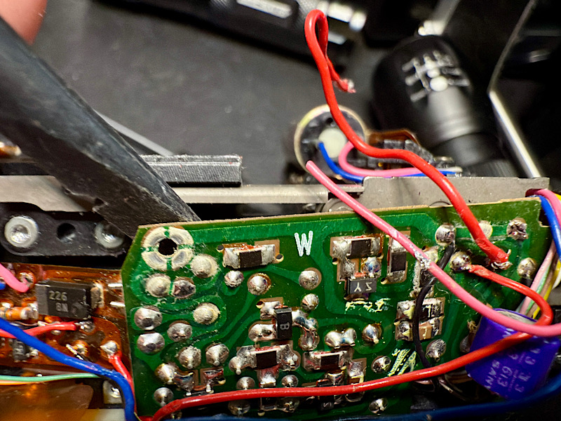

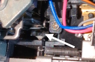

The long way to the trigger magnet is to remove the mirror box, which will help you get to know the T90 from the inside.
A shortcut is to loosen the four mirror box screws at the front and the two at the back. Then the mirror box can be pulled forward, and the magnet is accessible.
However, this is experimental, as it can cause problems with the motor clutch.

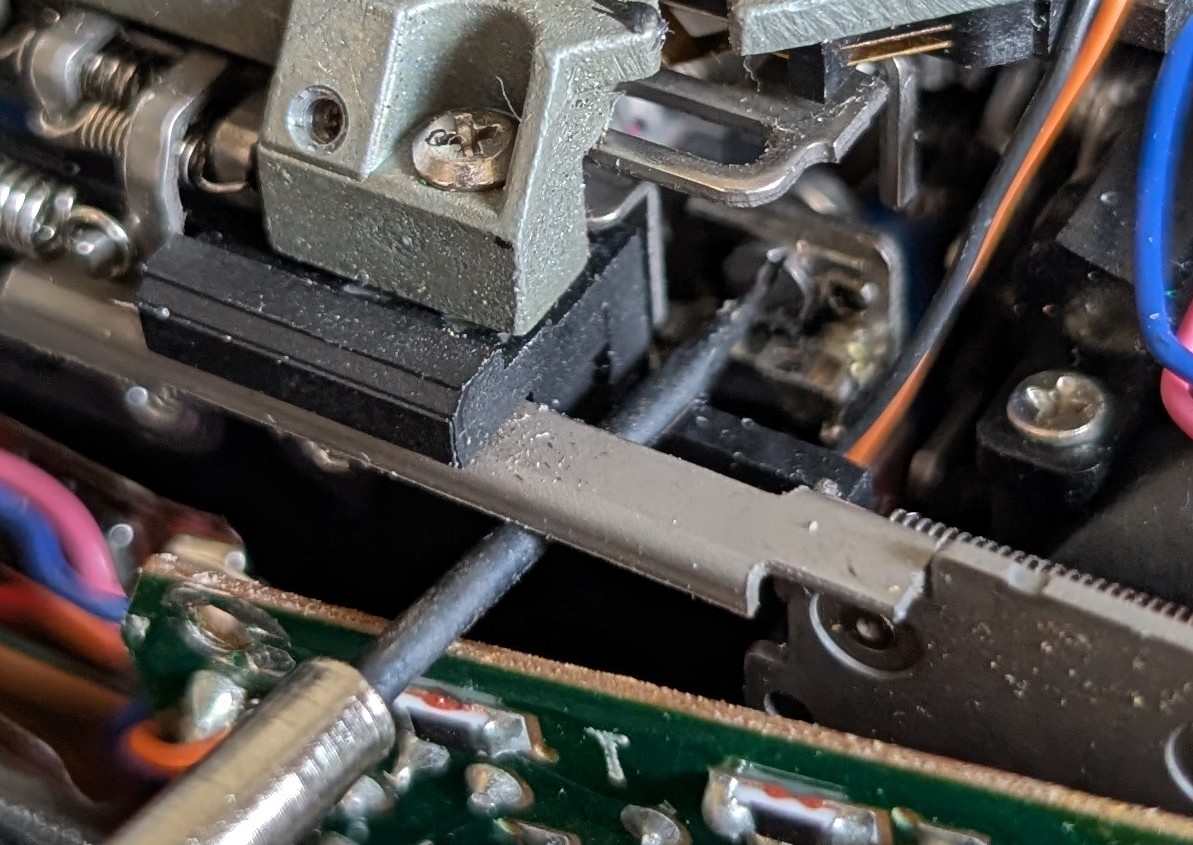

Interestingly, what worked for me was a flathead screwdriver with a shorter blade length.
I noticed the same, my main problem is that the screw is so tight that i dont get enough grip on my screwdriver. If i find a solution for that it should work hopefully
full disassembly is not possible because i have never really used a soldering iron before and i doubt this is a good first project for that haha
The second option sounds a bit dangerous, ill definitely try to unscrew the magnet more first. But it may be an option eventually if i get nowhere, thanks!
Another option is to remove the green circuit board with the DC/DC converter (two screws, solder connections), which will give you direct access to the magnet's screw.
It should also be sufficient to loosen just the two screws.
Im trying this right now without soldering, maybe i can get somewhere here thanks again!

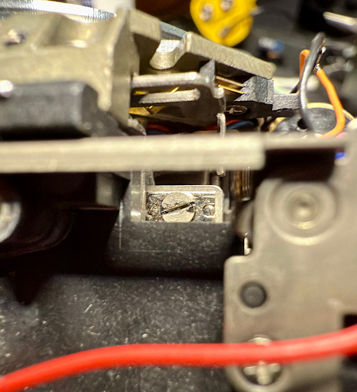

It happened!
I was really scared of breaking the hard soldered wires between the board and the flexboard and had to use quite a bit of force to get the screwdriver in there but everything seems ok so far.
In the slot like it belongs!

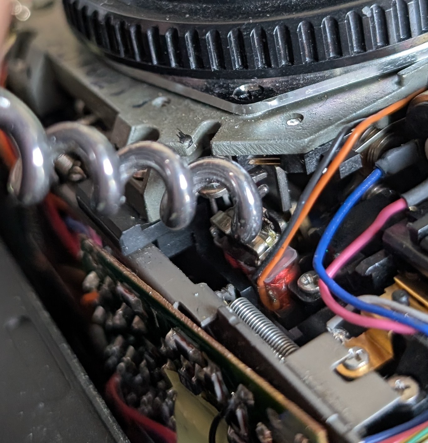

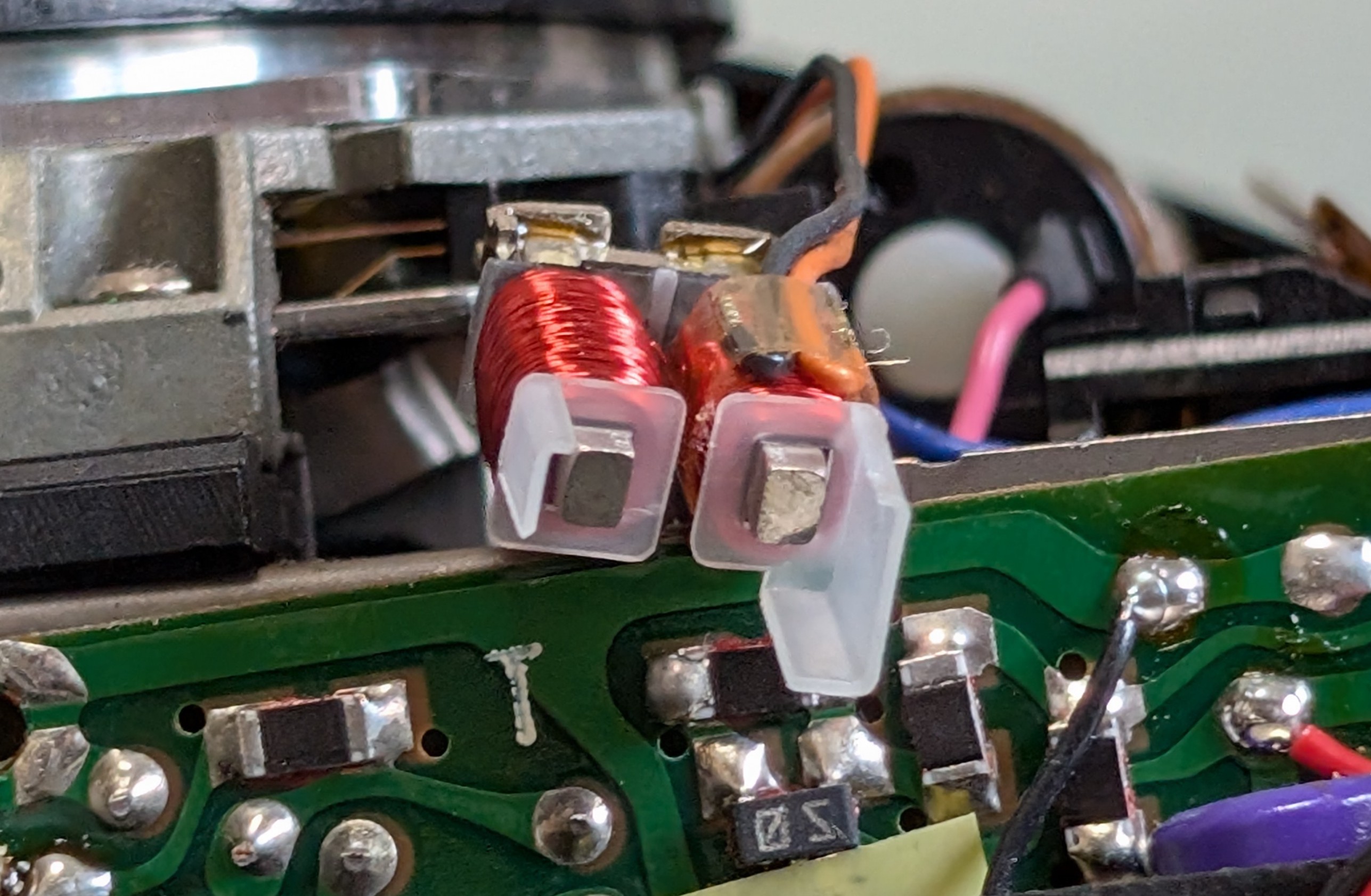

Using "professional" tools to extract the magnet
it looks... very clean?
I'll do the cleaning next anyways and hope that it fixes the problem.

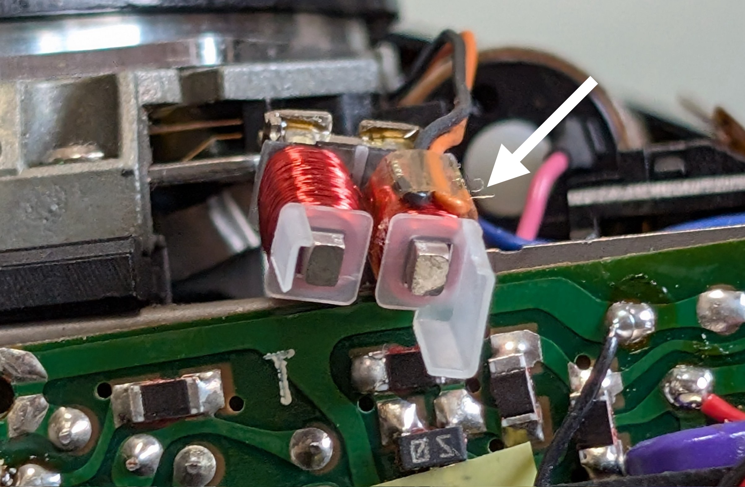

I would thoroughly clean all contact surfaces; the part inside the camera looks a bit cloudy. Try using benzine or isopropanol on a cotton swab, etc.
Can you use a magnifying glass to look at the coil (arrow) to see if there are any wires sticking out from the winding?
Might sound stupid but i used nail polish remover from the 100 Yen store and this is the result:
Video
I was confused by this too but it was just some piece of plastic stuck to the tape, not the coil itself.

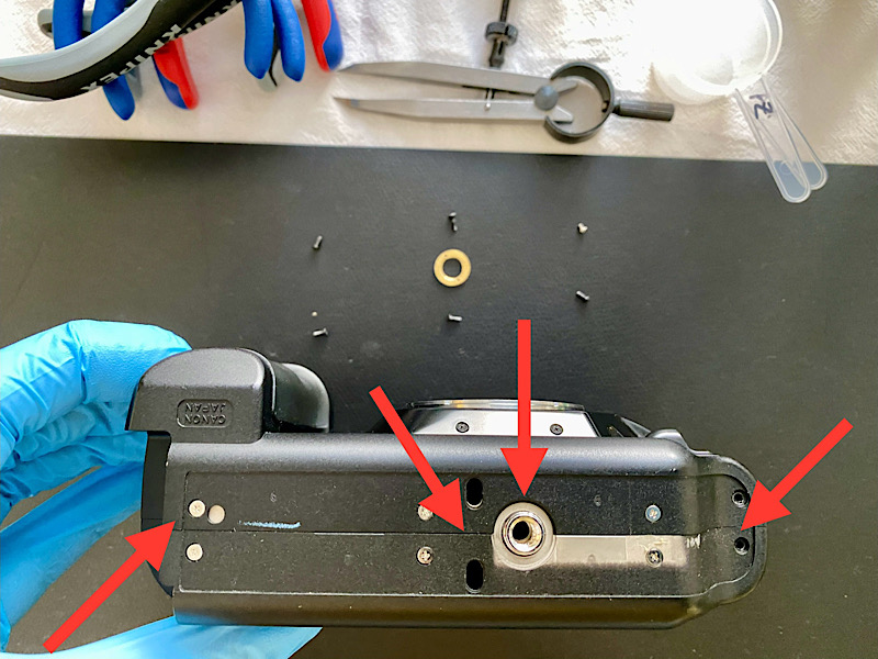

One last question i messed up keeping track of the 6 bottom screws. On your photo on page 1 which way are they aligned?
When I look at the complexity of film cameras from the 80's and 90's its like looking at a moon rocket. The scale of the suppliers that made all the pieces, etc, etc. Simply amazing.
From this perspective:
  • The silver screw is on the outermost side, top right.
  • The longer screw is in the middle, top (hidden).
  • The remaining screws should be identical. One is in the middle, bottom (hidden), two are on the outermost side, left, and the last one is underneath the silver screw.
Ok perfect, then I assumed correctly!
