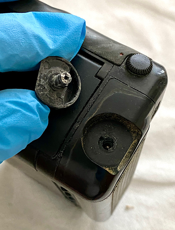

They all have one thing in common: their battery compartments cannot be opened because the batteries have leaked.
The battery acid has cemented the battery holders and the battery compartment cover of the T70.
When I tried to remove the battery holders from the T90s, the locking knob came off, indicating that its metal holder was being corroded by acid.

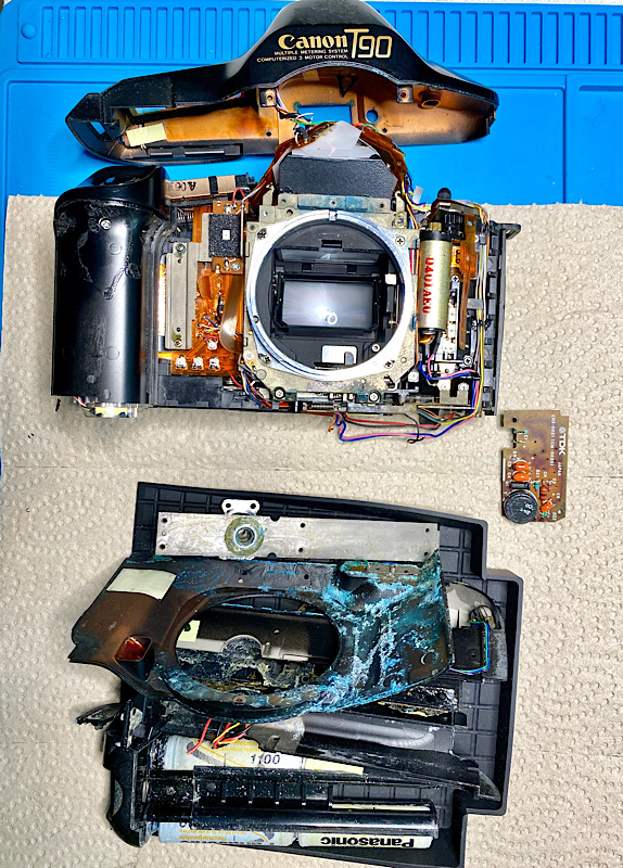

Battery Electrolyte Victim #1: The revenge of the forgotten batteries
The external condition does not inspire much hope, the stuck battery holder suggests that four batteries have taken revenge for having been forgotten in the camera for years.
It looks better here.
The leatherette has become rotten due to the leaked electrolyte and falls apart when you try to remove it.
The retaining ring has become a molded unit with the tripod thread. I drill the two holes so that I can attach the spanner wrench. But no chance, the ring doesn't move.
This screw no longer offers a hold for the screwdriver, and it cannot be drilled deep enough to use a screw extractor.
Since the batteries are still inserted, I can't get to the two screws that hold the battery compartment underneath.
The battery holder has to come out so that I can remove the battery compartment.
My screwdriver for rough work once again proves its worth as a lever.
Now I can unscrew the battery compartment, except for one screw, and I don't have to use much force. I can also remove the tripod thread and the seized mounting plate.
The connectors for the cables are rotten.
Unsoldered
Toxic waste
One of the connections on the purple electrolytic capacitor is corroded. I can't tell for sure whether this is coming from the battery or whether the capacitor is losing electrolyte. It definitely needs to be replaced.
The soldering points to the right of the capacitor also need to be replaced; they are corroded too.
I remove the circuit board.
It would be best if I replaced the whole thing.
The inside of the front panel is probably coated with a layer of copper. Ideal for the vapors from the battery electrolyte. Total corrosion.
Contamination, the mechanism for stop down is seized.
It looks good on the upper board.
A sad picture.

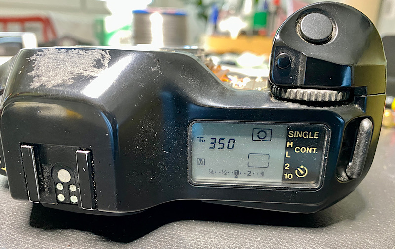

  • This T90 shows what forgotten batteries can do to a device over time.
  • Anyway I have original spare parts for everything from my abandoned T90s.
  • The question is whether the considerable work for a repair makes sense. I assume that the battery electrolyte is also causing trouble in places that are not visible and that this is affecting functions or causing them to fail.
  • The crucial question is whether the two shutter magnets are still working. I can only test this when I trigger the camera. And for that, it has to be restored.
  • If the magnets don't work, which happens with T90s that have been left lying around for a long time, all the work was in vain. Because they are not accessible to me deep in the camera.
I think it's better to put this electrolyte corpse with the spare parts, in a well-sealed plastic bag.
