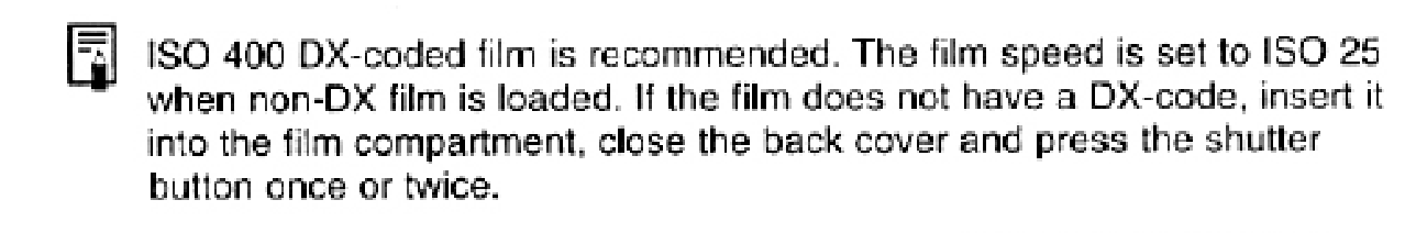

User manual available from Canon website clearly states that it defaults at ISO25, so OP is right.

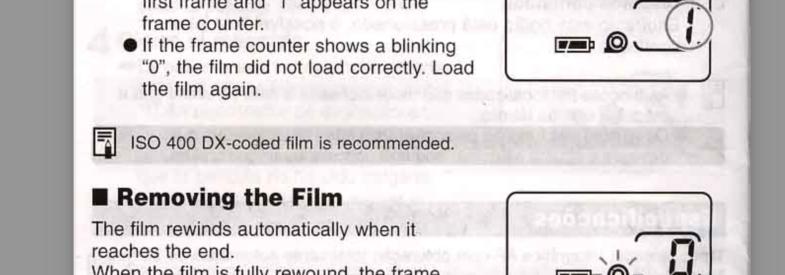

Shure Shot 80u Manual (no mention of non-DX film):
Shure Shot z180u manual:
