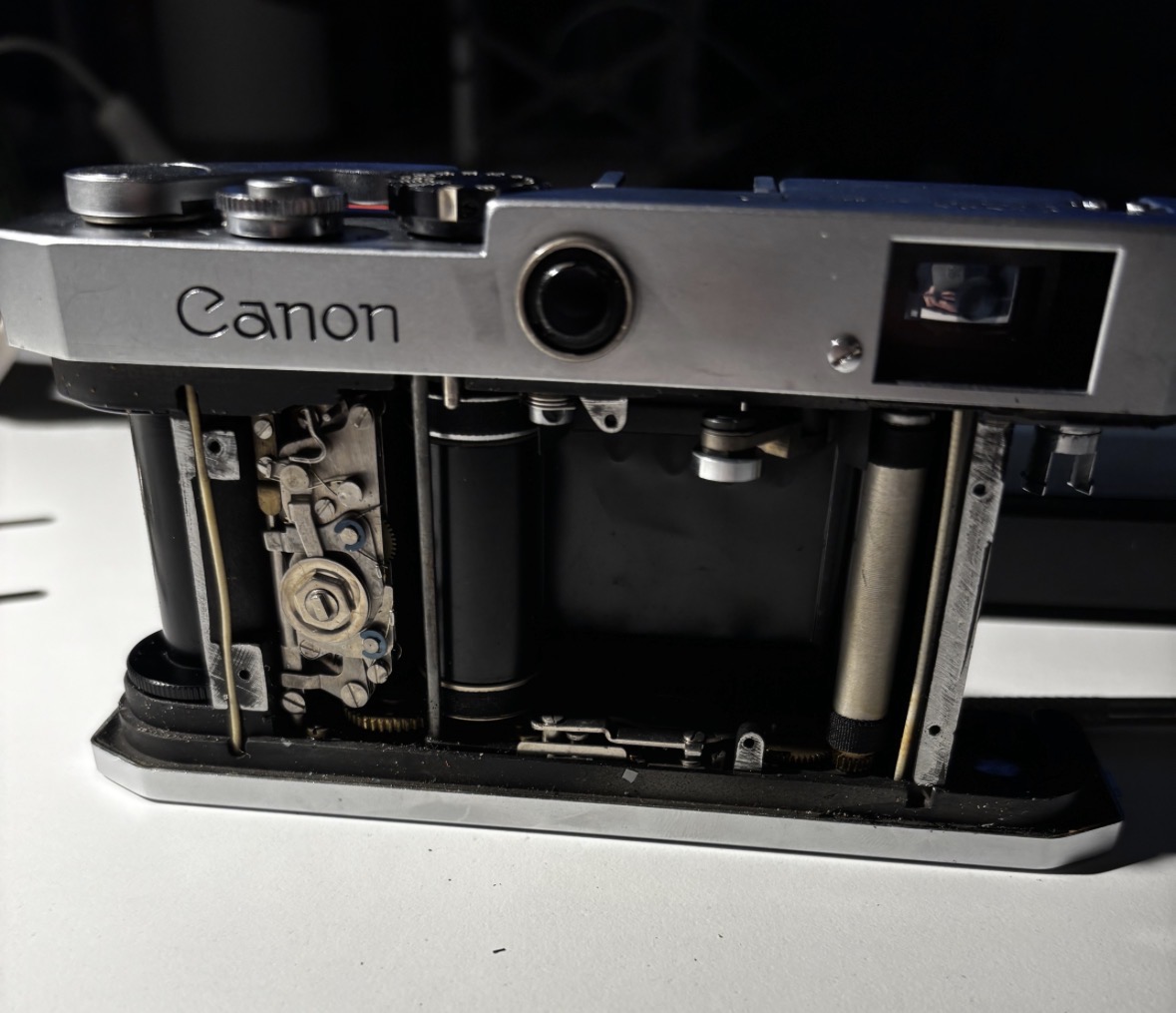

i took the camera apart to look into it, but for the love of me I can tell which part it would be even when I did advance it.
There are stethoscope-type devices with a small metal tube at the end for isolating noises in devices. That would probably be ideal for your use case as you can position it close to moving assemblies as you manipulate the camera.

Most likely you need to remove the top cover. If it is winding, it may be inside the gears and such underneath the winding lever. Do some research on how to remove the cover and how to handle any rangefinder issues that might arise from this.
I don't feel like its from the top cover to be honest. It feels like I can hear it either from the bottom cover or inside.

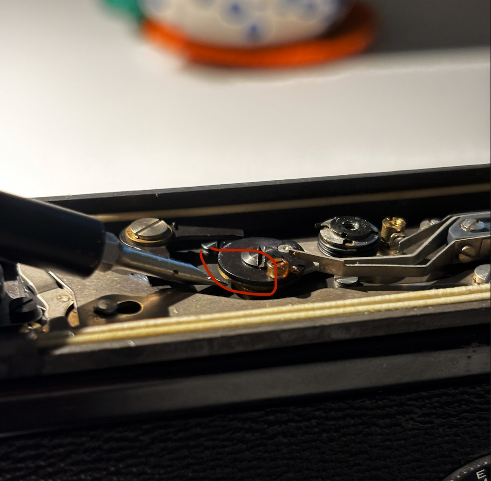

I'm also suspecting this part, but until I get some oil I have no clue...

Setting the camera to rewind should disengage the sprocket wheel as well as the shutter cocking. It does not necessarily mean that the noise is coming from the shutter.
Camera wind and shutter mechs are designed to work with little to no amount of lubricant. It is possible that the mechanisms need to be cleaned, but if you start by putting any more than a trace amount of oil into the mechanism, it is quite possible that it will work worse, not better.
Also to point out when the camera is set to film rewind and I move the film advance leaver, that does not happen. So it has to be related to the shutter gears?
When you set to rewind, you are disengaging the sprocket rollers or whatever they would be called. That's it. So doesn't this point to something with the takeup spool? Do you have a fine paint brush and some lighter fluid? Put small drops top and bottom of the takeup spool and see what happens? Tilt camera so that any excess fluid will not find way to shutter mechanism. The bearings for the takeup spool is under the wide flanges.
