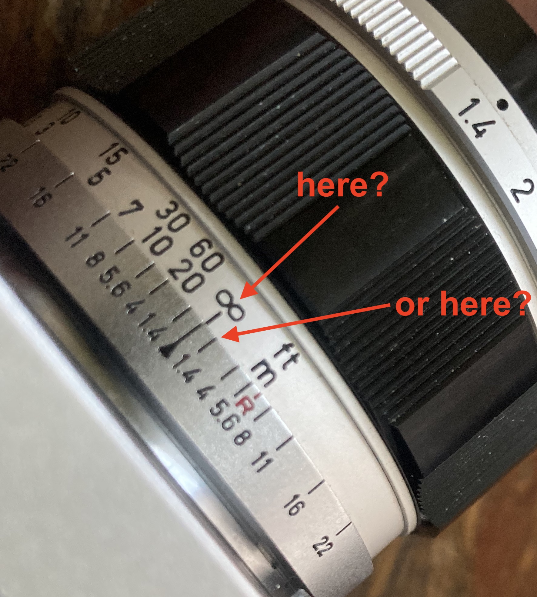

Pretty rookie question, but when I'm focusing at infinity f/1.4 should I have my lens indicator pointing at the infinity symbol or at 1.4?
At the infinity symbol, if you want to have the best focus at infinity.
If you wanted to maximize the range of distances where the focus is acceptable, you could put the infinity symbol at 1.4, which would mean the lens is set to the f/1.4 hyperfocal distance, but that doesn't give you anything of any meaningful benefit.
If you are working at a smaller aperture - say f/16 - setting the infinity at the f/16 mark, means that the lens is focused at the hyperfocal distance for f/16, and the range of distances where the focus is acceptable is much more useful.
Thank you!
