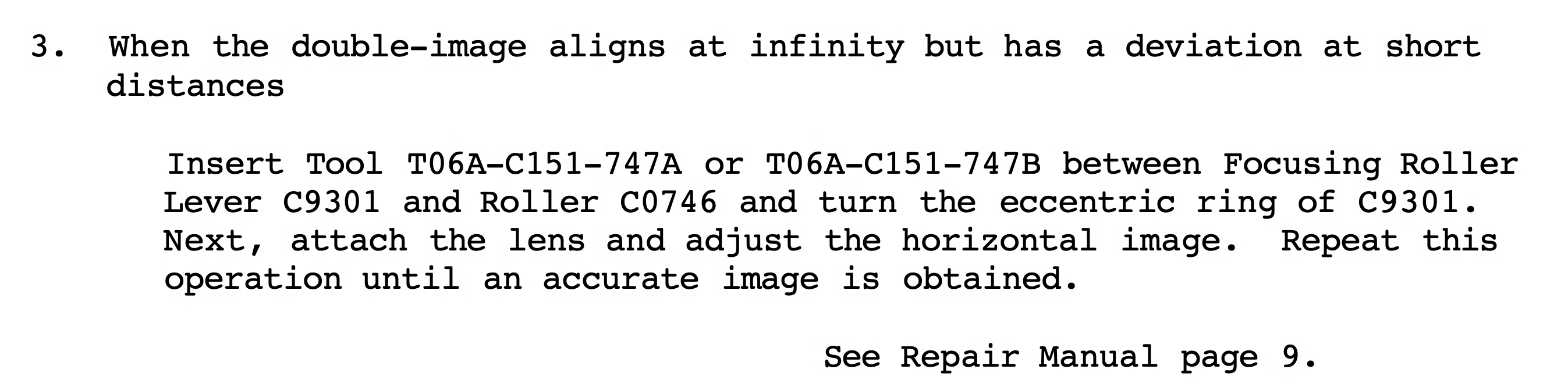

Funny that Canon 7 (screw mount camera) DOES have close focus adjustment.
(from Canon 7 repair manual)
Very interesting! I wonder if since the Canon 7 came after the P this was an improvement they made with this issue in mind.
