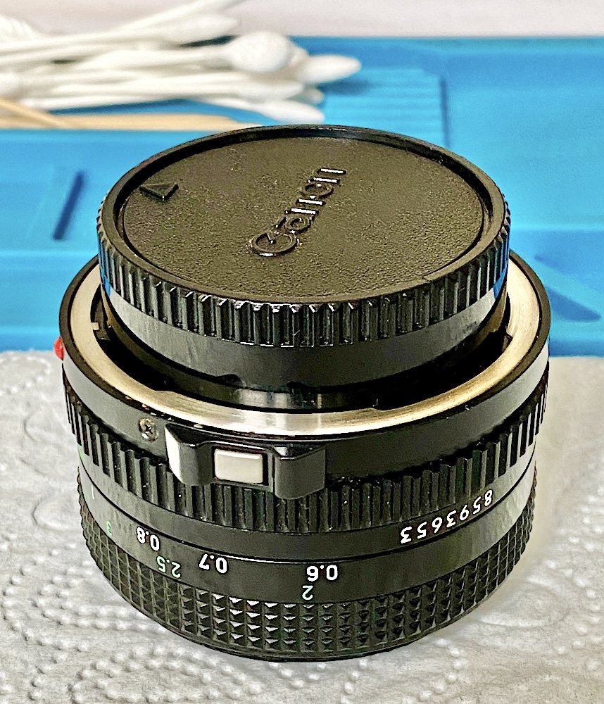

Since I'm working in the front, the lens sits on its back cap, which protects the projecting aperture lever and the rear lens.
The plastic decorative ring around the front lens cannot be unscrewed, but rather clipped in. Therefore it can be levered out. To protect the lens when the lever is in place, I cut a piece of a block of tough foam. It once came to me as part of a package. (Unfortunately, it left some greasy marks on the lens, but they were easy to remove later.)
With the screwdriver, it's easy to pry out without any roughness.

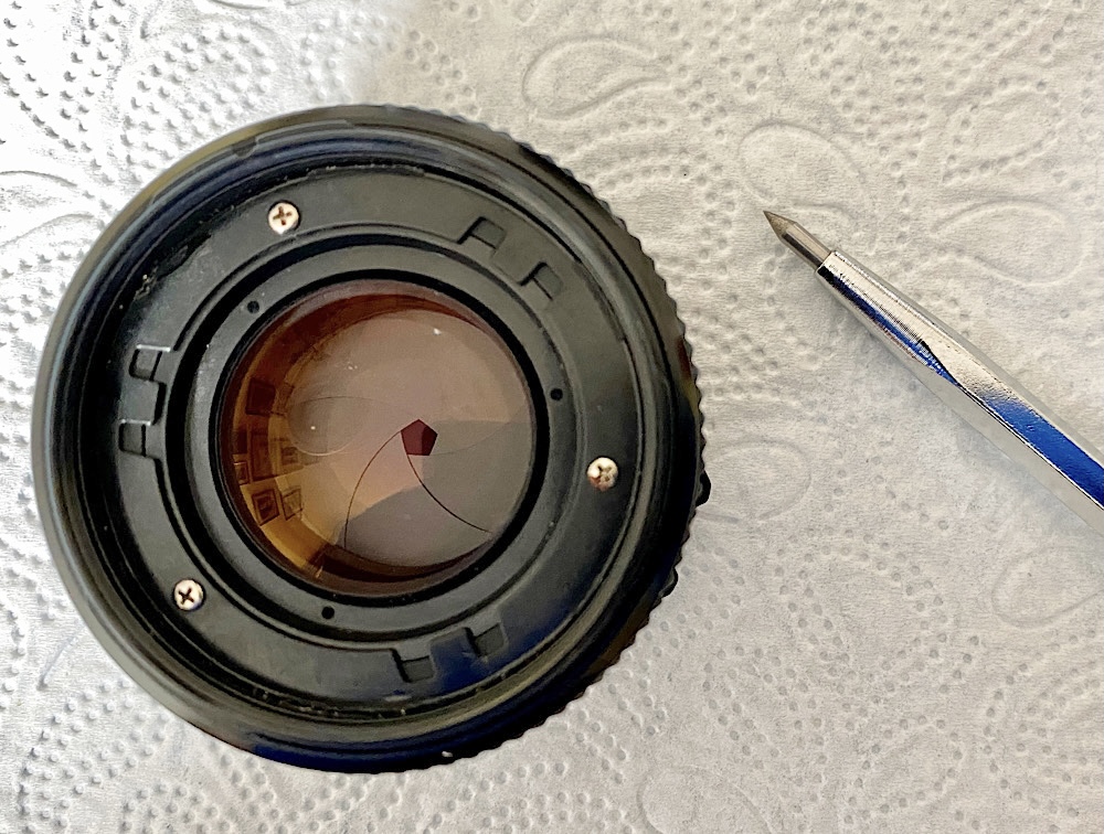

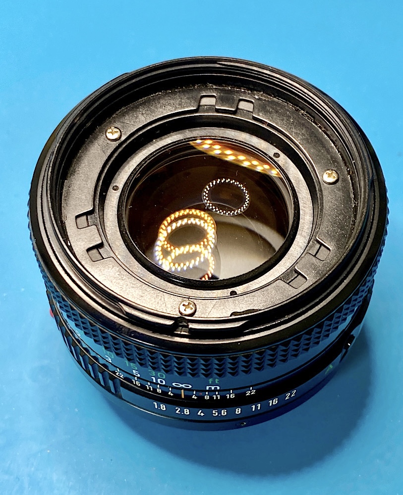

Three screws secure a ring that holds the front lens assembly.
Kenneth recommends marking the position of the ring and lens assembly for reassembly.
I follow this advice, although I suspect that the positions are not relevant here because the lenses are uniformly shaped. But better safe than sorry.
I make two marks with the marking pen (hard tungsten carbide tip).
Line upon line …
… aligned with the infinity marks.
This makes it clear where the lens unit and ring should point later.

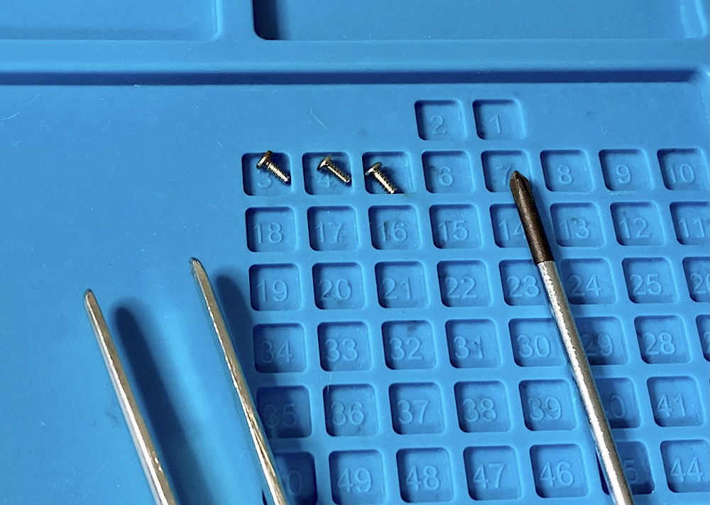

I unscrew the screws and put them away.
All three are the same, so they don't have to be lined up to be returned.
This ring is also gone.
Be careful, the front lens unit is now no longer secured and may fall out when turning the lens over.

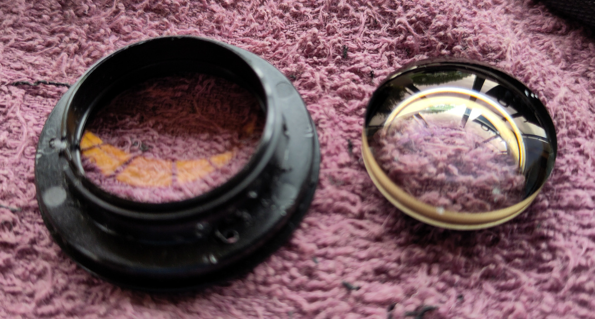

I use the lens sucker to lift the unit out of the tube.
The convex front lens ...
... and a concave lens that completes the unit.
The unit consists of further optical elements.
Since I cannot see how to open the unit they remain out of reach for me.

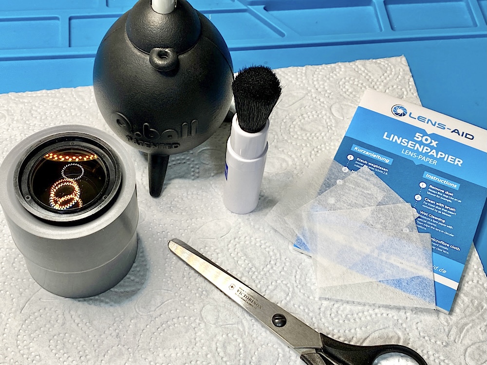

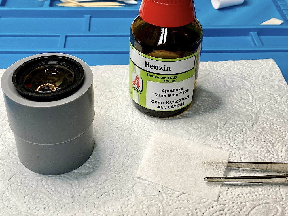

The lens unit is securely held during cleaning in a rubber cylinder for unscrewing decorative rings.
The - scratch-free - cleaning is carried out in the order bellows - brush - bellows - lens cleaning paper, but this ...
... definitely not dry, but soaked in surgical spirit. (Zippo lighter fluid should do the same good job.)
Clean in a spiral motion from the inside out.
Since this leaves a streak, I switch from paper to a cotton swab soaked in surgical spirit.
This works.
Same procedure for the other lens.

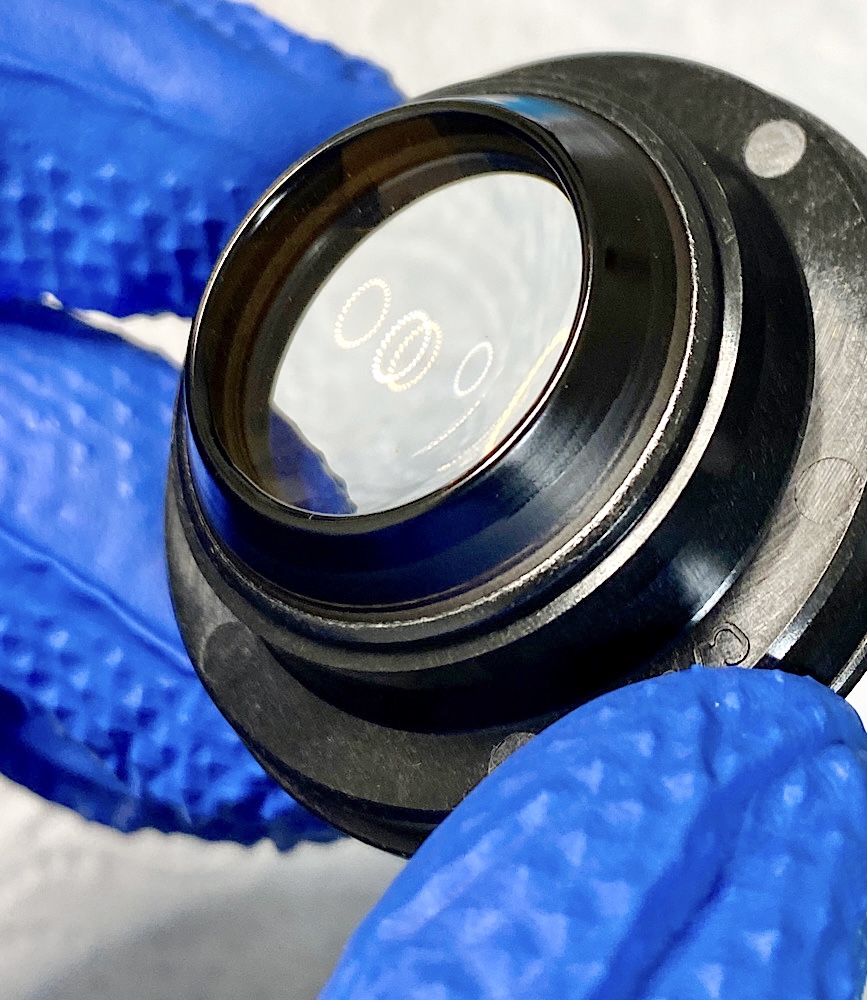

The front lens unit is back in place - lifted using the lens sucker.
The two marking lines are aligned with the infinity mark.
Now it's time to screw on the retaining ring.

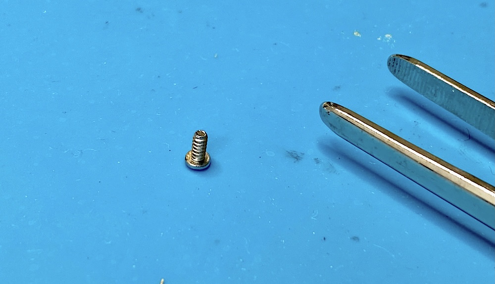

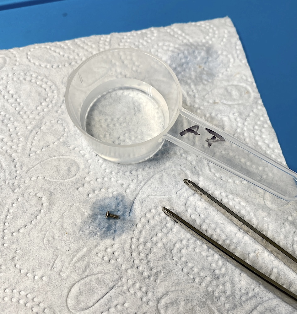

One screw is slightly rusted.
Pure Durgol descaling solution, scraping and rinsing in Aqua Purificata are the treatment.
I will dry the screw with the butane powered Dremel Versatip.
Since I don't want to take off my tight-fitting nitrile gloves - which are flammable - there are protective leather gloves over them. (I'm being overly cautious here as the nitrile gloves can handle quite a bit of heat).
The screw is now free of rust and dry.
All screws are back in place.

The front lens unit, now largely free of dust and dirt 👍

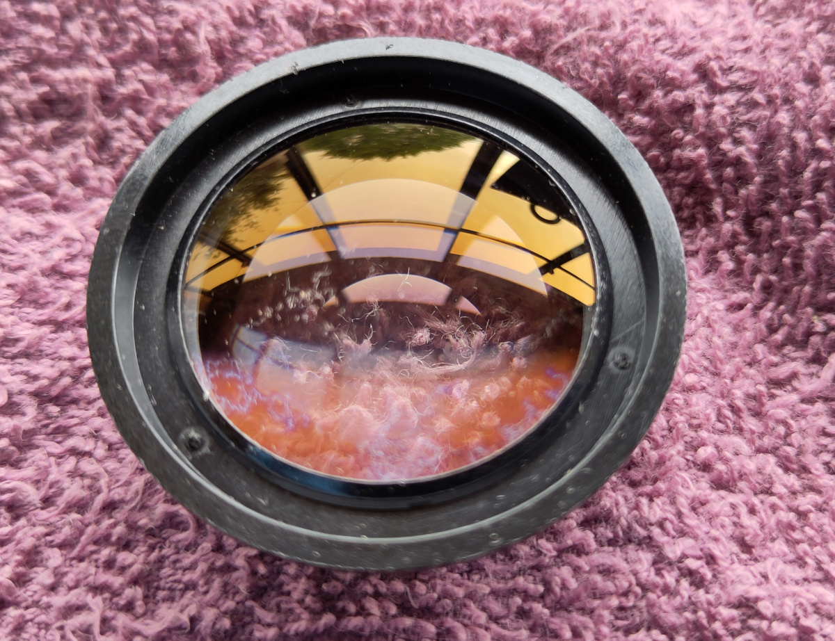

Hi @Andreas Thaler . Nice to see you're getting back to this lens.

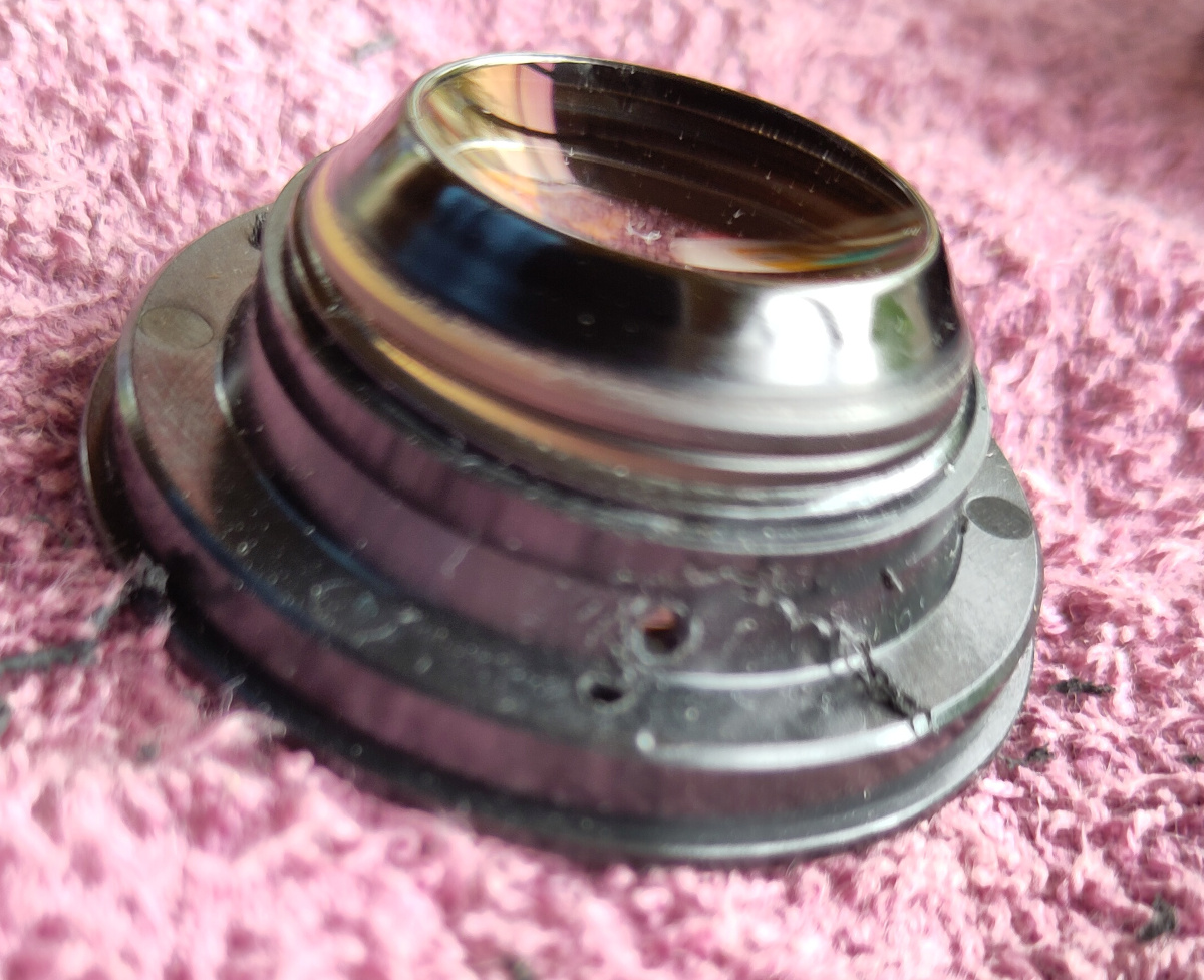

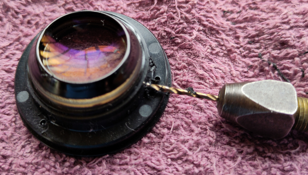

I made an attempt some weeks ago, on a lens that had fungus and I bought for cheap as a parts donor. I was able to open the rear doublet, but this was done with brute force and somewhat damaged one of the lenses.
Since the lenses are attached together with a plastic housing, I decided I'd try to drill holes in it (first attempt was to remove the "rivets" that can be see in the image above. Alas, they serve no mechanical purpose and maybe plastic injection remains).
The hole position is somewhat delicate, as it is needed to "land" between the two lenses.
I the used the hole to insert a prying tool and force the lens out of its place...
My prying tool is a dentist's tool, and the pressure on the lens damaged the surface.
Next time, if I have the opportunity, I'd like to try using a fluid under pressure to "eject" the lens, since the coupling is so tight. This would require a coupling gizmo to inject the fluid (air would be preferred), but may reserve good results.
